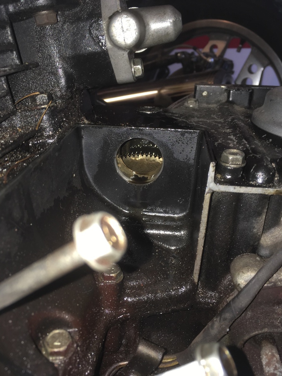

but after i wanted to start the engine starter get stuck, so give it a fix to autoelectric, after fix i notic that my starter is not turning nice engin, vimeo.com/234181698
The batery is full of charger, after I tace out the starter, and put my finger inside the hole and this sprocket is muving all directions 2-3 mm .i fink its bad ..starter clutch???? can some one say how to fixs .
then no spark plugs in engine its turning engine wery nice.
