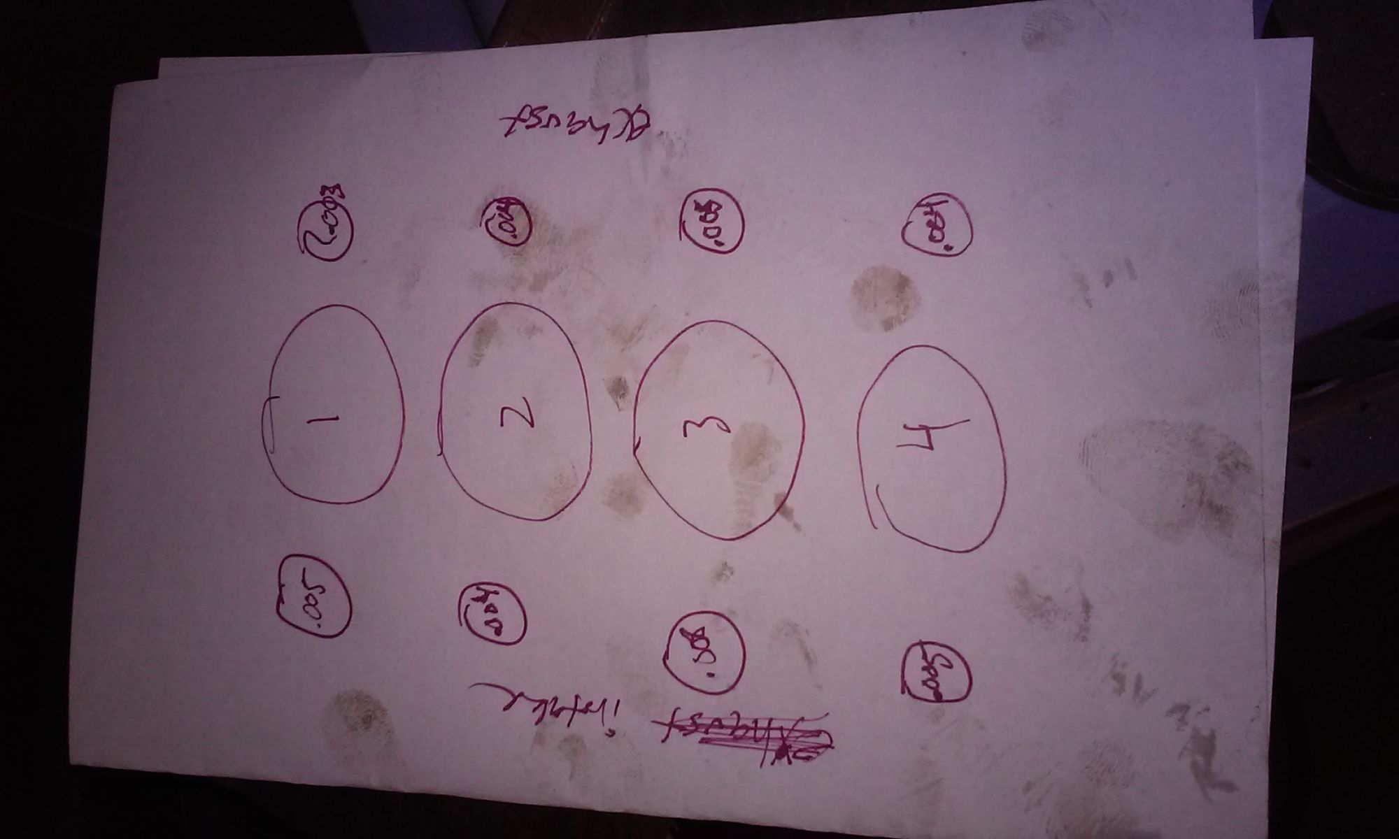

20 Jul 2015 14:38swest wrote: This has drifted from carbs to cams and valve clearances. Time to start another thread.
Well SOMEONE wanted me to check the valve clearance and now I am so that pic is what I have right now. Manual says .015 gap but mine is way smaller or maybe non existent

20 Jul 2015 14:44
The manual should give a range, like .010 - .020 or some such. If the minimum is .015 and all of yours measure .008 or less, then thinner shims are needed to get the gap within range.

20 Jul 2015 15:18
Looks like .008 mm is the very limit. The next thinner shim shoul give the .008 valve .013, which woul be ideal. Most guys shoot for wider half of the allowable range. In this case that would be .013 - .018.

20 Jul 2015 15:28TexasKZ wrote: Looks like .008 mm is the very limit. The next thinner shim shoul give the .008 valve .013, which woul be ideal. Most guys shoot for wider half of the allowable range. In this case that would be .013 - .018.
maintenance.kz650.info/GeneralMaintSpecs.htm
The numbers I wrote are in inches

20 Jul 2015 15:37blink543 wrote: Ok wtf I opened it up to find out the cam chain is skipping again I just fixed this a month ago with a newer tensioner it came out of alignment again
So?

20 Jul 2015 15:54swest wrote:blink543 wrote: Ok wtf I opened it up to find out the cam chain is skipping again I just fixed this a month ago with a newer tensioner it came out of alignment again
So?
What do u mean so? It's not supposed to do that
