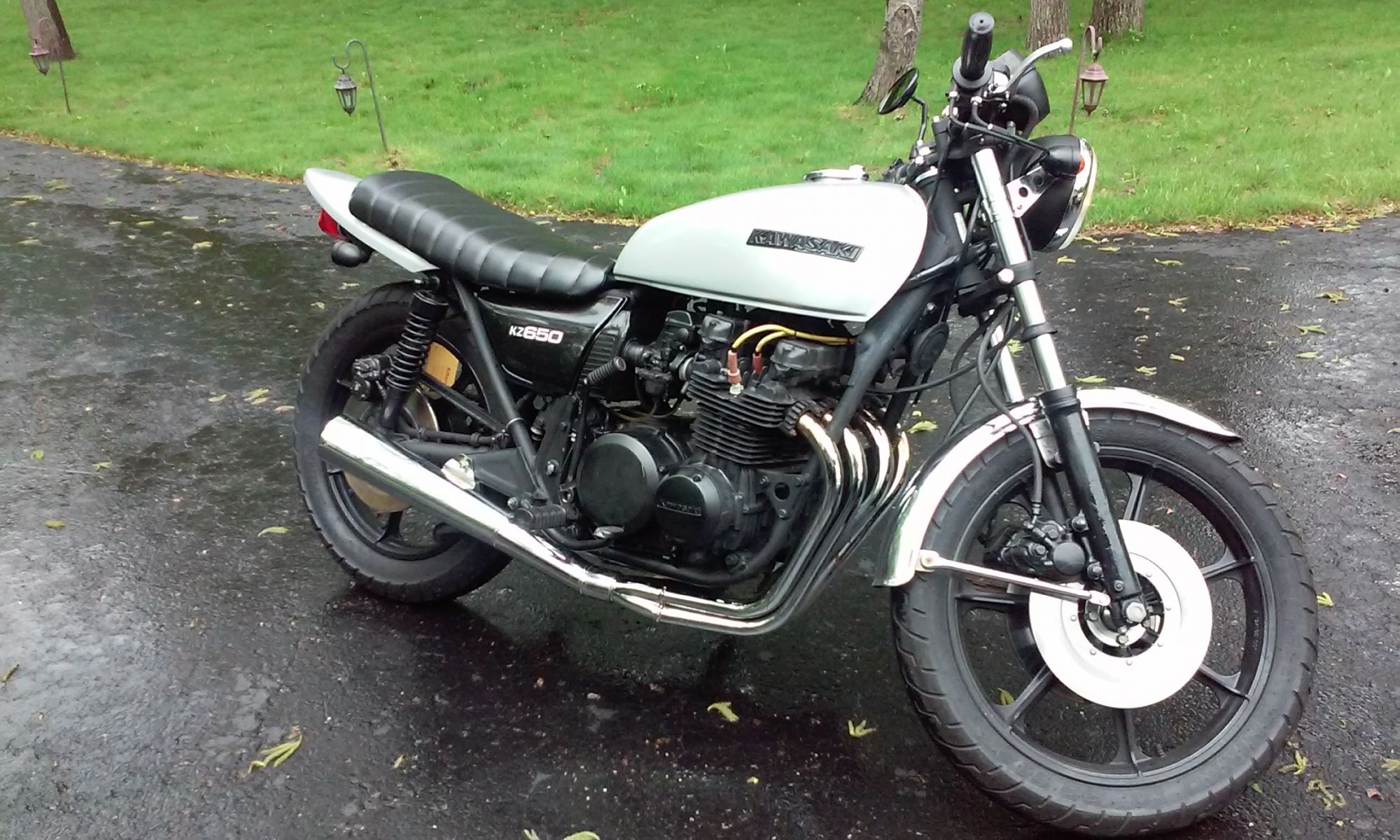

19 Jul 2015 08:45 - 19 Jul 2015 08:46Nice bike. Before you Sync or fine tune it, you must make sure the valves and routine maintenance procedures are done. You have VM carbes. They are cheaper and easier to repair and tune. If those are Graphite/silicon HT wires you should loose them. Hard to make good connections. Been there.
Graphite silicone ht wires????
Adam james

Re: carb tune help/procedure
19 Jul 2015 10:52
Believe he was talking about your spark plug wires, the big yellow wires... Look on them and see if they say graphite silicone on the yellow part of the wire anywhere....

19 Jul 2015 13:32
I can tell by the boots. They're noise suppression wires. Better off with some 7mm hard wire and NGK caps. You might have bad connections at the coils. They look cool but unless you have the proper connections, they will fail in a short amount of time. I'm sure you know about the dust boots on the forks. You should get new ones or the seals can be damaged.

19 Jul 2015 13:44swest wrote: I can tell by the boots. They're noise suppression wires. Better off with some 7mm hard wire and NGK caps. You might have bad connections at the coils. They look cool but unless you have the proper connections, they will fail in a short amount of time. I'm sure you know about the dust boots on the forks. You should get new ones or the seals can be damaged.
I have to take the fork off to change the seals right? Well the coils are firing so why change them?
