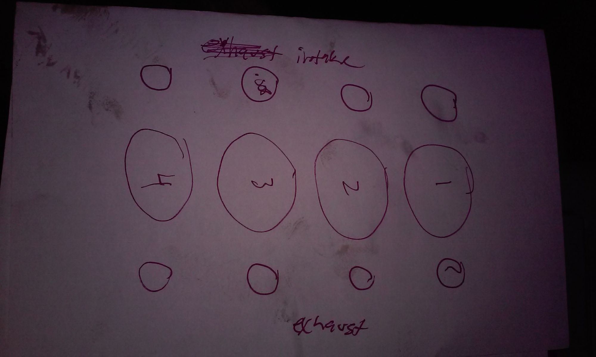

20 Jul 2015 14:26This is what I have for valve clearances? If there's nothing written then that means a .008 didn't fit between. So if there's a smaller gap than that isn't that bad?
Adam james

Re: carb tune help/procedure
20 Jul 2015 14:30
This has drifted from carbs to cams and valve clearances. Time to start another thread.
