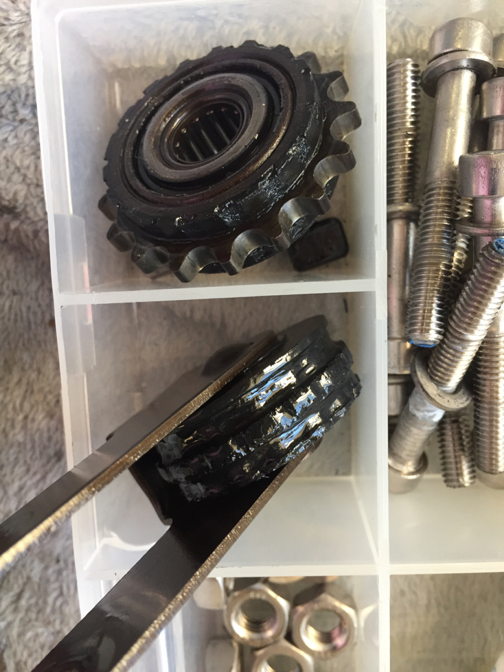

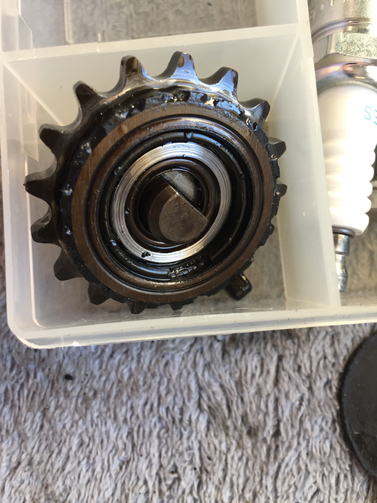

It is not getting any better.
It seems that everything from the cam chain is worn.
The tensioner is done and I guess the roller will look the same.
And why are these part so expensive compared to the rest of the bike?
Probably better to also put in a new chain?

Its pretty common to have the cam chain components be pretty worn. Replacing the cam chain is probably not a bad idea but that requires splitting the cases. you can measure your cam chain and see if its within spec before you decide to do that. The only reason I can see that these parts are so expensive is they have pretty small tolerances, and precision machining of a complex part is not cheap. Also I would replace the little rubber blocks that hold the rollers and such in place. They are likely really hard and can prevent the cylinders or head from sealing all the way if you reuse them.

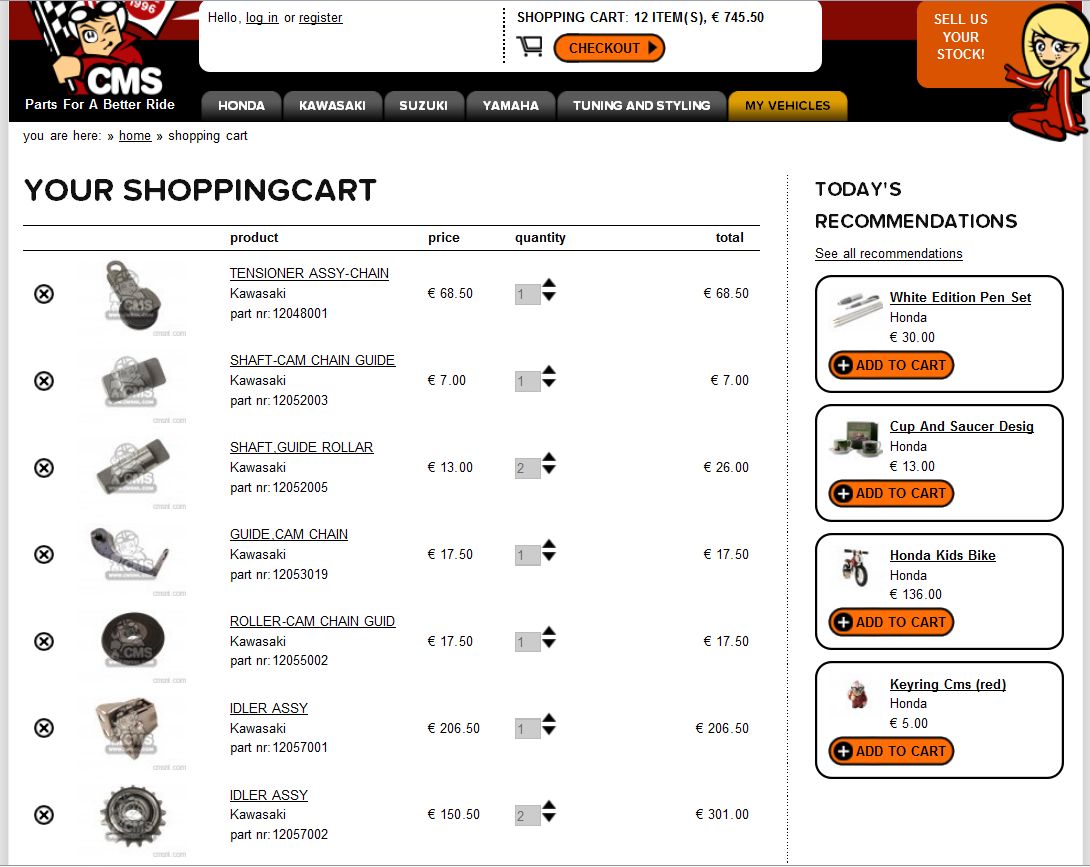

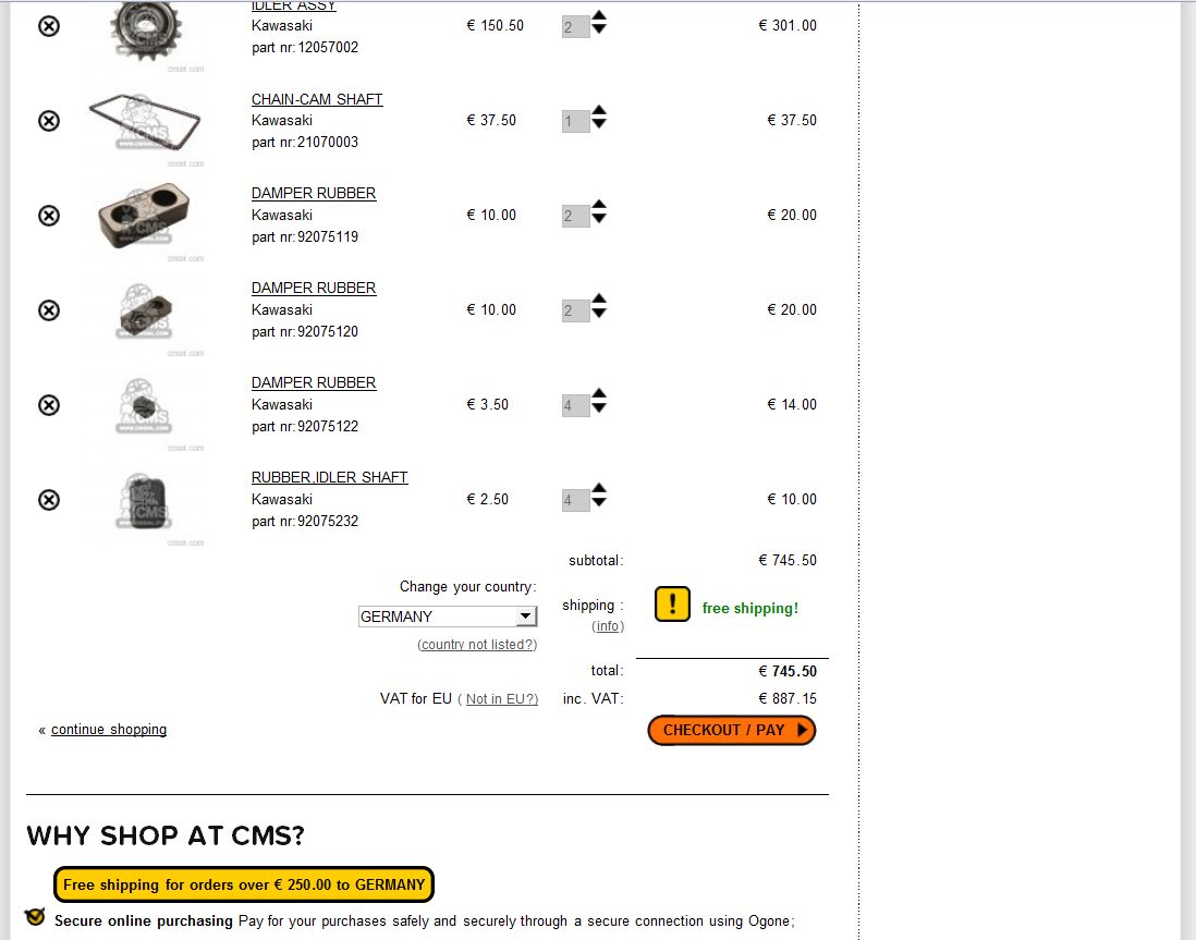

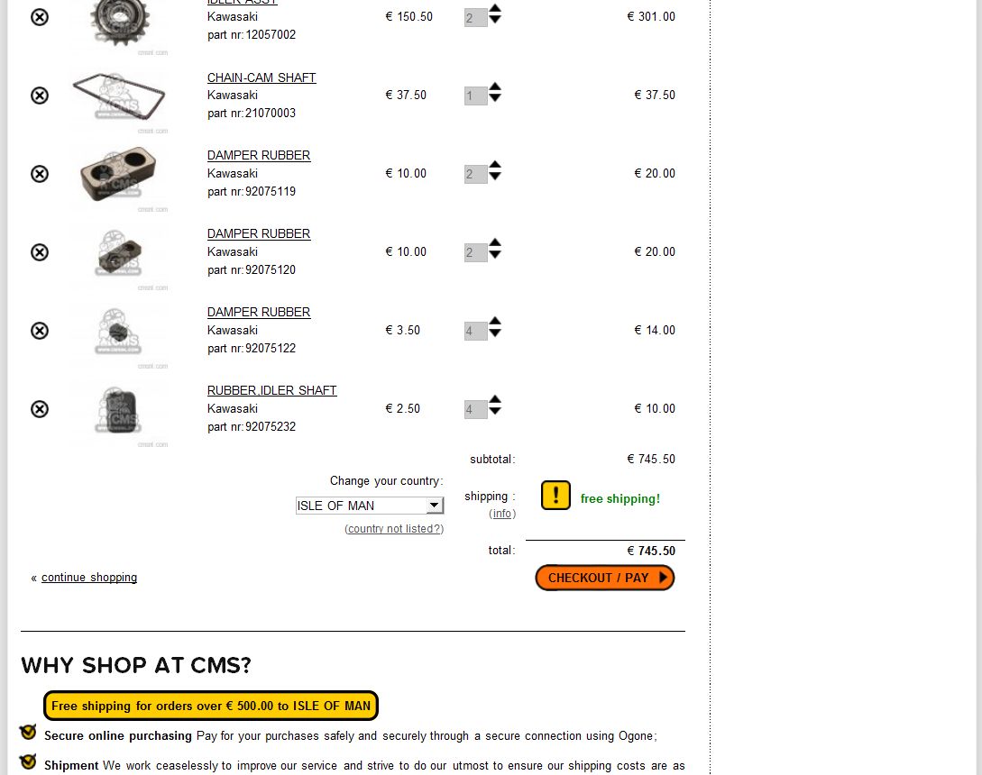

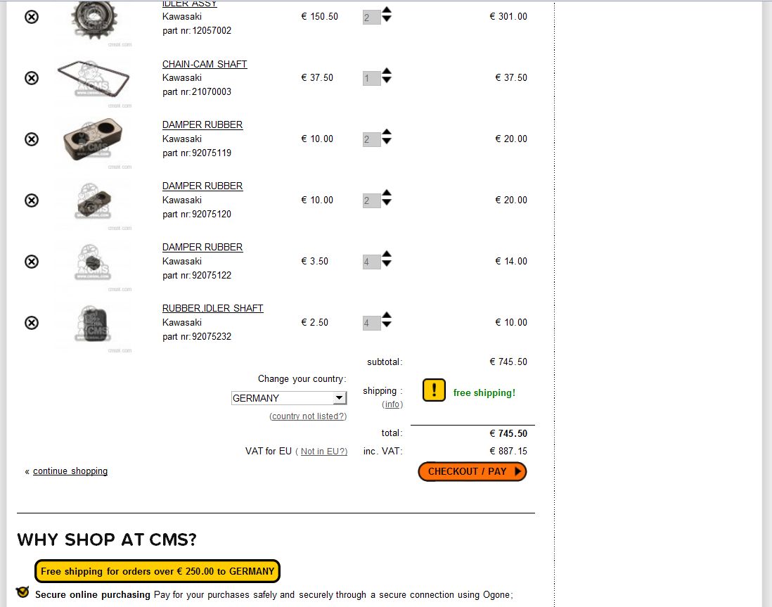

I do a quick shopping list
The two Idler Assy sprockets are the expensive part of all needed parts
www.cmsnl.com/kawasaki-z1b-1975-usa-cana...t/61209.html#results
Price for Germany and Netherlands = 887,15 EURO
Price for Isle of Man = 745,50 EURO ( no taxes )!!!!
Michael

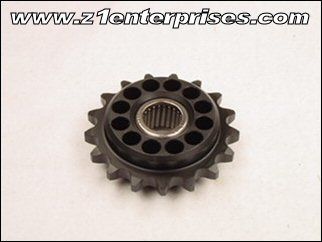

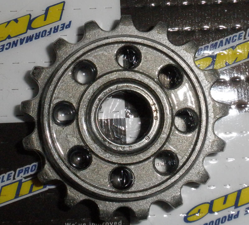

I also found these parts in Holland but more expensive, luckily I am going to the states again in a week and it still saves me some money when I pick it up there.
But the big money saver is, if I buy the other brand (I think it is Liska) they are not as well damped as the original Kawasaki parts but half the price.
or these from PMC
Anyone has experience with these?
