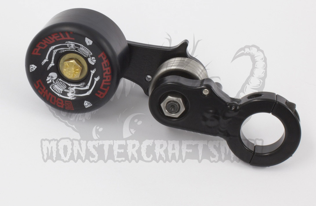

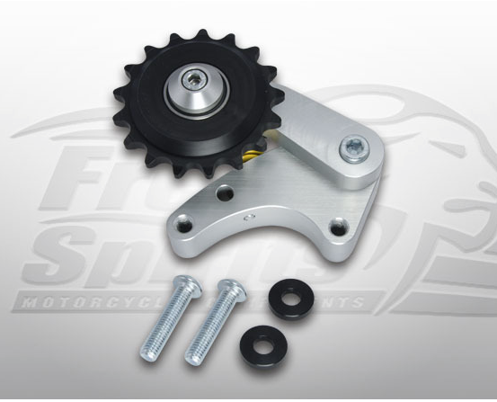

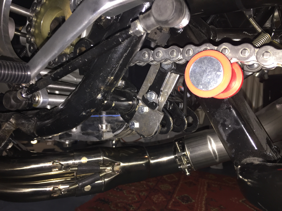

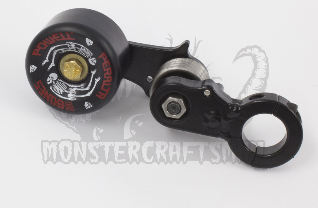

Poor man's Chain tensioner.
Just for tryout.
Next month I have a trip to the US and will be ordering a professional one.
One of those 3, any advice which is better?
Eric
Just for tryout.
Eric

09 Feb 2017 12:33i have used the one with the skateboard wheel on a customers bike.no idea how it performed tho :whistle: .
i have heard that the ones with the sprocket are really noisy tho fwiw.
hth,

09 Feb 2017 14:25
Leon,
The one with the skateboard wheel looks better but I think the other one keeps the chain more aligned.
I have to do some more research on the web to make a decision.
Eric
Eric

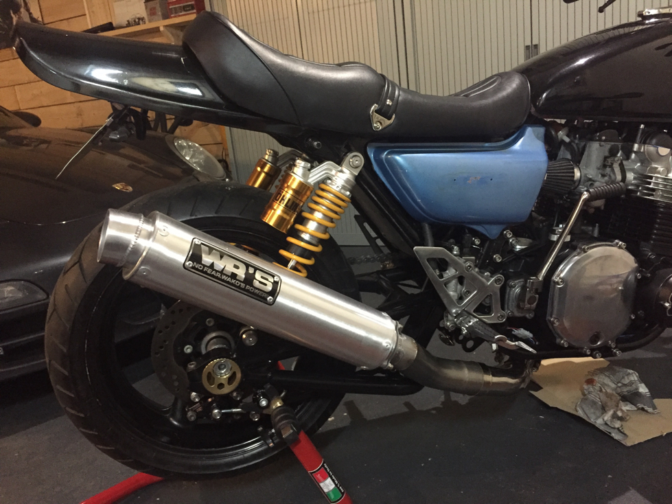

09 Feb 2017 16:10 - 09 Feb 2017 16:13Wiers wrote: Leon,
Eric

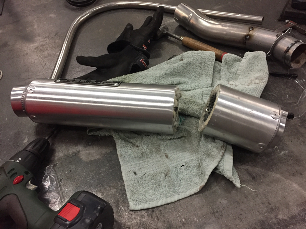

Don't worry about alignment Weirs, that's what the front and rear sprockets are for. alignment is no problem at all... {unless a sprocket falls off :woohoo: } How much did you cut off the muffler ? I have the same one except without the tag, cheap Chinese but well made... What did you do to mount yours, mine has the same coupling set up ?
