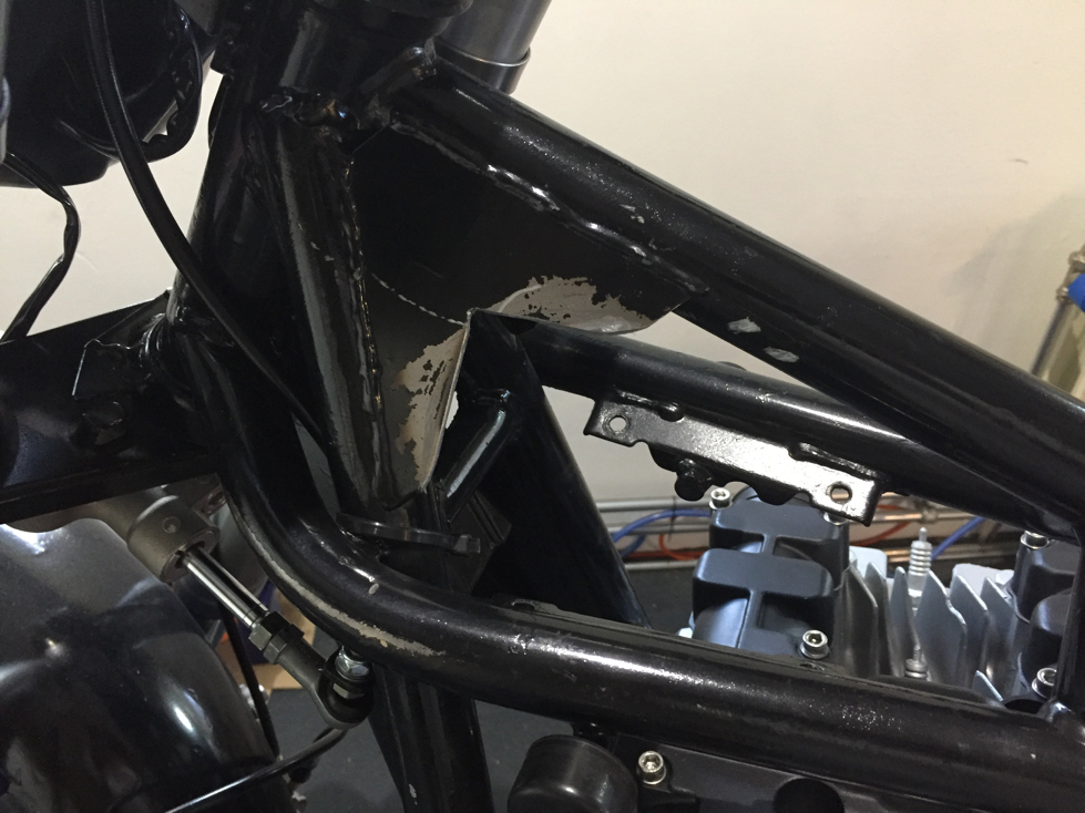

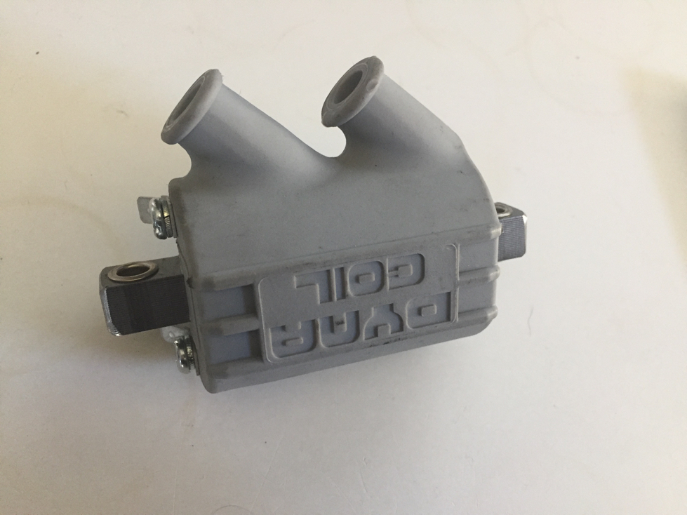

Steve,
I was thinking about denting the tank a little, will it not damage the inside?
These coils are part of the Dyna 2000 kit.
I will make a bracket which will turn them inwards so that I have more space for the other cables.

I had to position my coils under the mounting brackets, It isn't a problem because you can't see/ notice them (on the Z1R anyway) when the tank is fitted. The only time its a pain is when removing the valve cover.
The other issue I found that when the coils are too close together they can cause a miss now and then.

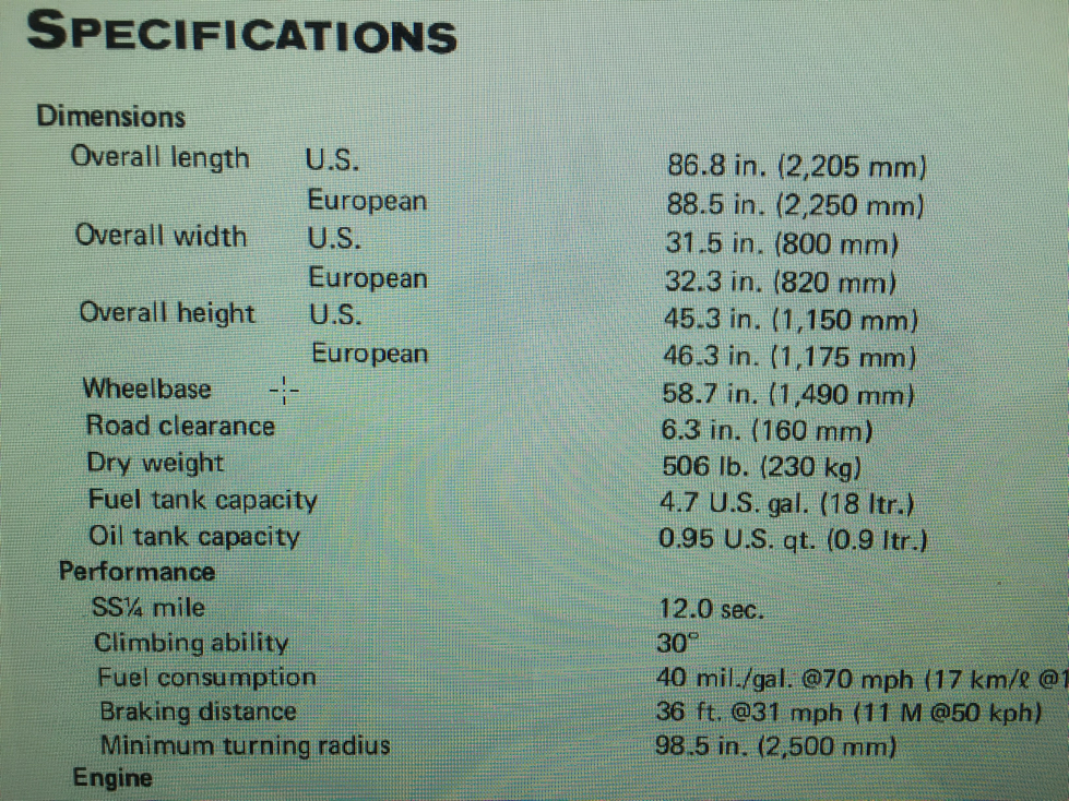

This is what i found for a Z900 wheelbase but I think Z1000 is the same.
Just measured mine, 151cm so well within limits with a GSXR front and a ZXR rear end.
I guess you are not far of from that.

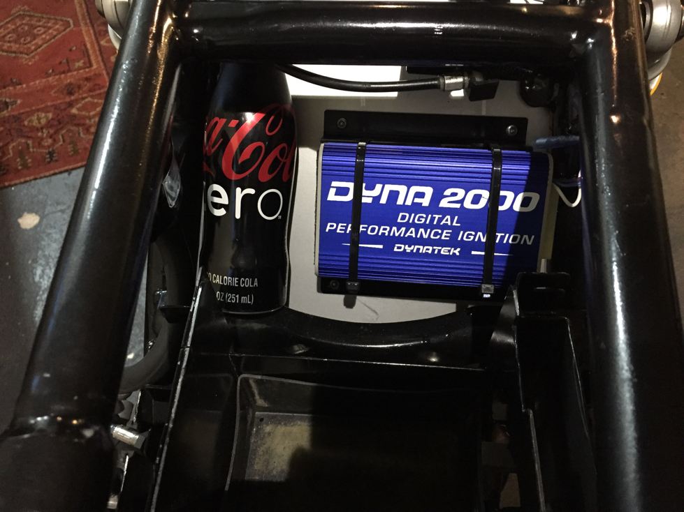

You weld some and you grind some :S
All cables will fit now.

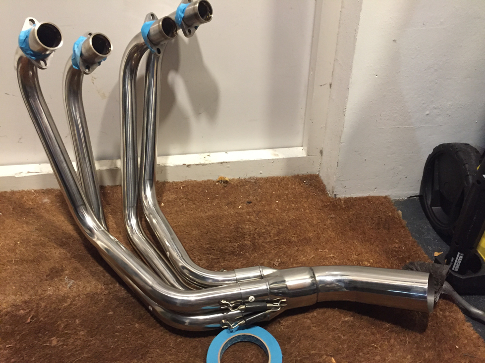

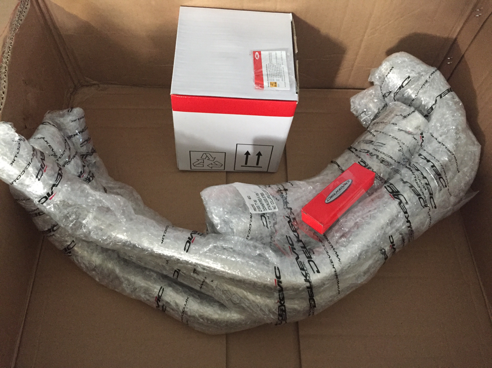

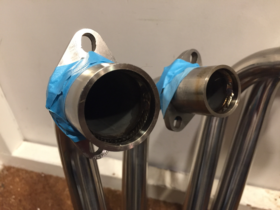

Also just in, late Christmas present :laugh:
New headers from Delkevic and a new battery.

congrats on the parts arrival!

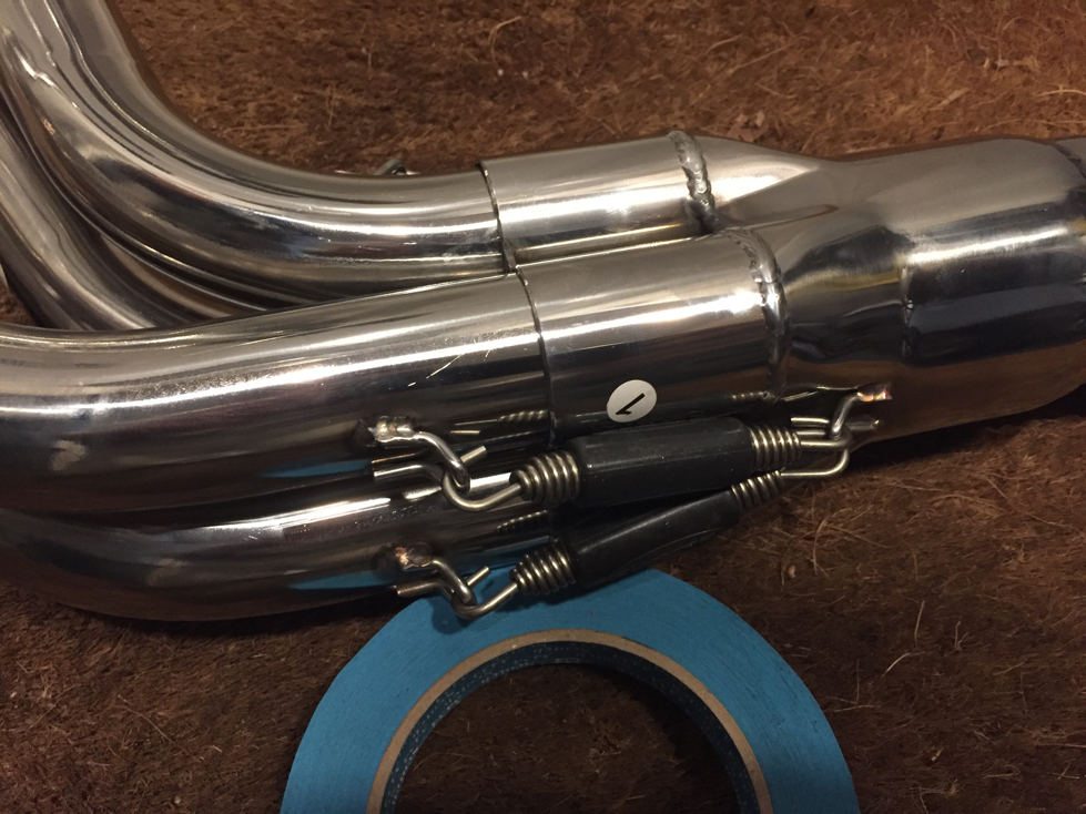

11 Jan 2017 14:34
That's a nice looking bike Leon.
Keeping that subframe in mind
The quality of the Delkevic looks promising.
I have the bike on a stand for the moment so the I cannot try them out.

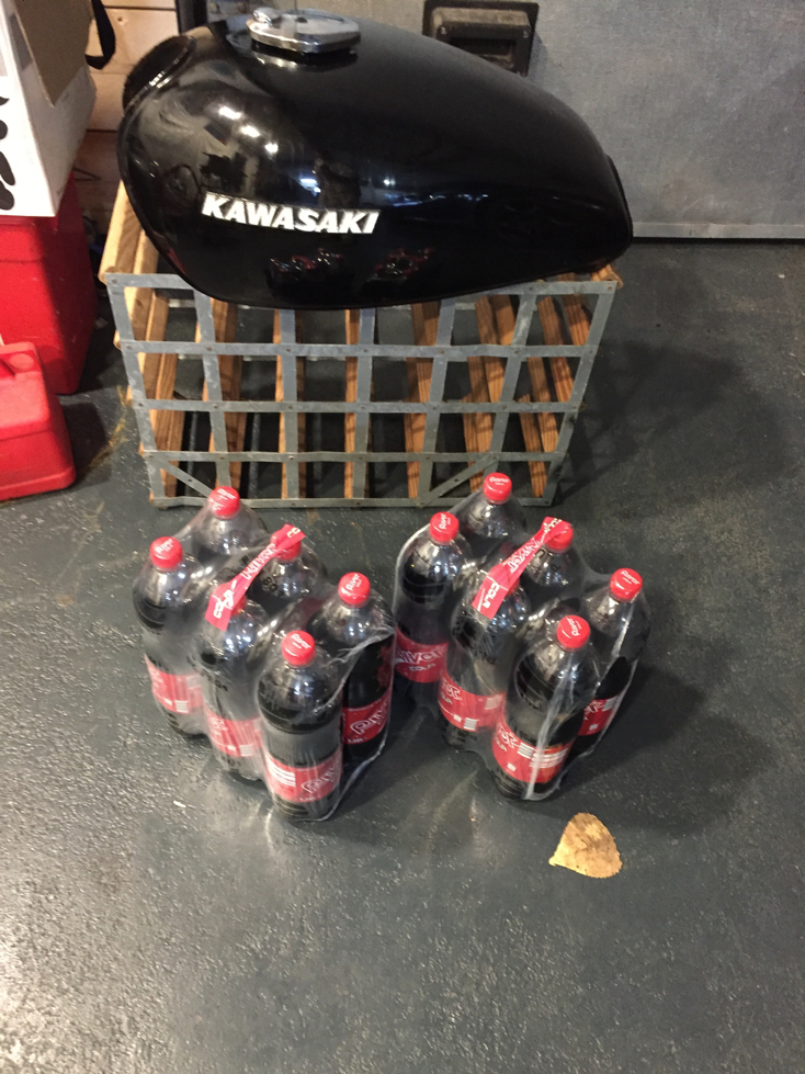

I think there are more Dutch builds on the Dutch forum, but I like this forum and the people on it
Cleaning the inside of the tank.
Seen a lot of different mixtures but my tank was not that dirty so tried it with 2 liter real Coca Cola.
Turned out nice so then I bought 18 liters cheap crappy Coke :laugh:
Let it rest for a while and then a lot of flushing.

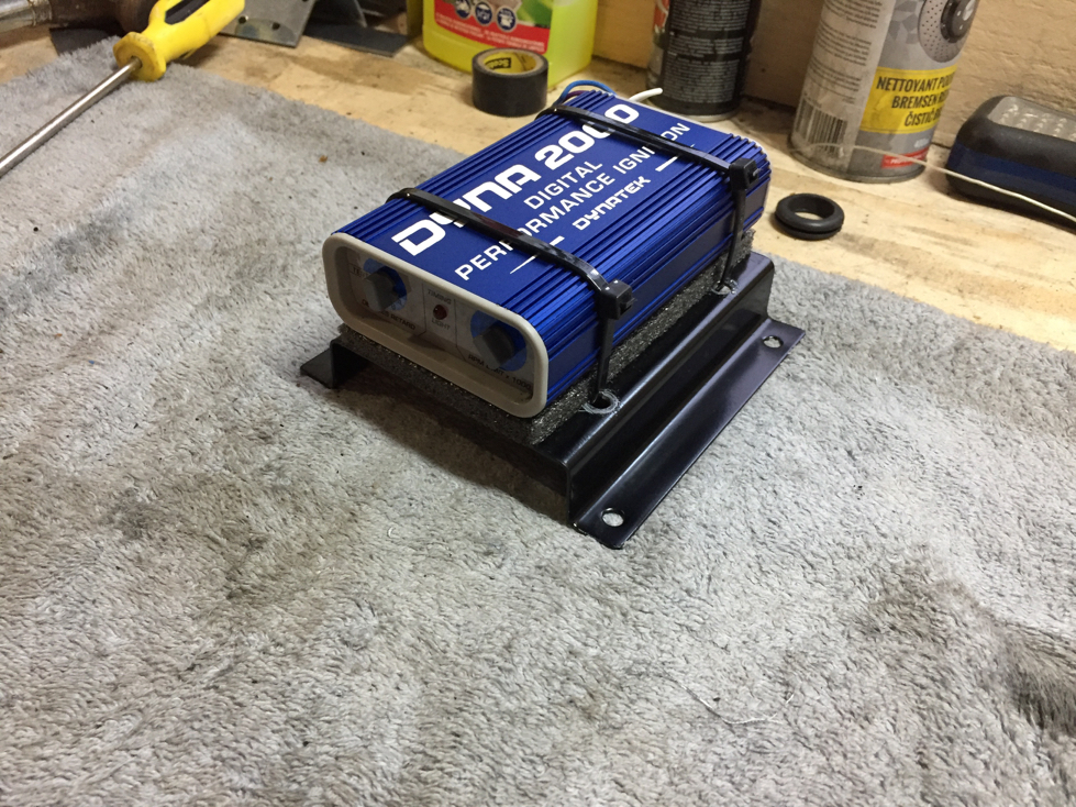

So done withe liquid department on to the nerve center.
Made a bracket for the Dyna and next job is the wiring loom.
Eric

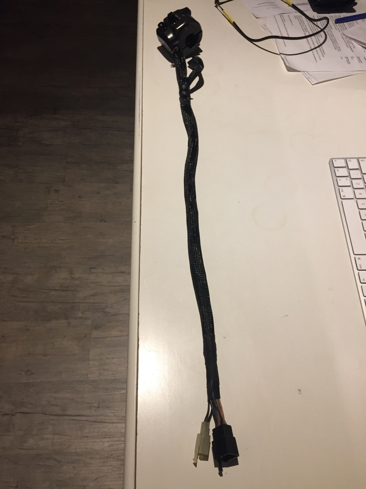

Not much progress, down with the flu :sick:

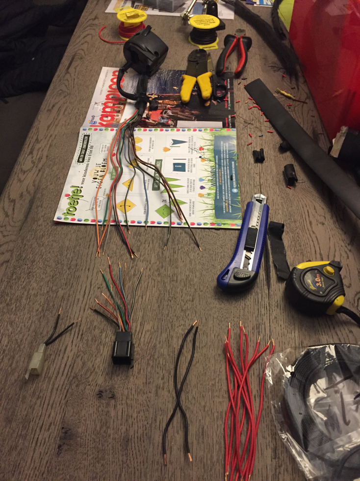

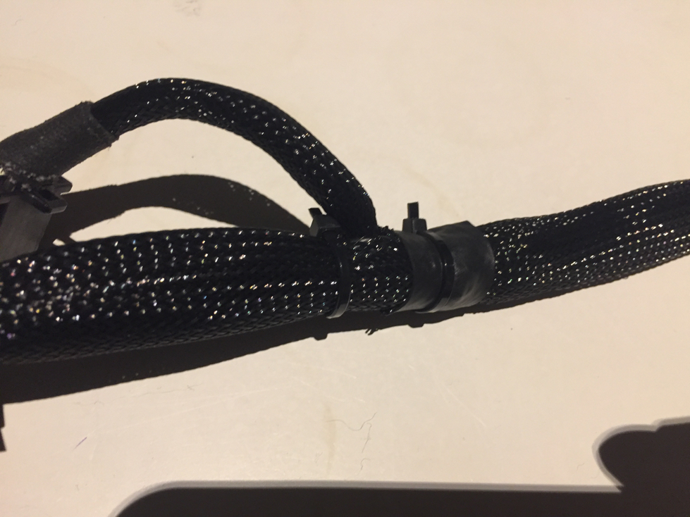

Extended the wires of my left handle bar.
Cut them and then soldering 15cm long pieces of wire in between.
Gives me more flexibility but 11 wires X 2 soldering is 22 changes of failure
Also had to relocate my bracket for the Dyna unit because I forgot that this was also the space for my circuit brakers.
And cut the extra long piece of the coils.
