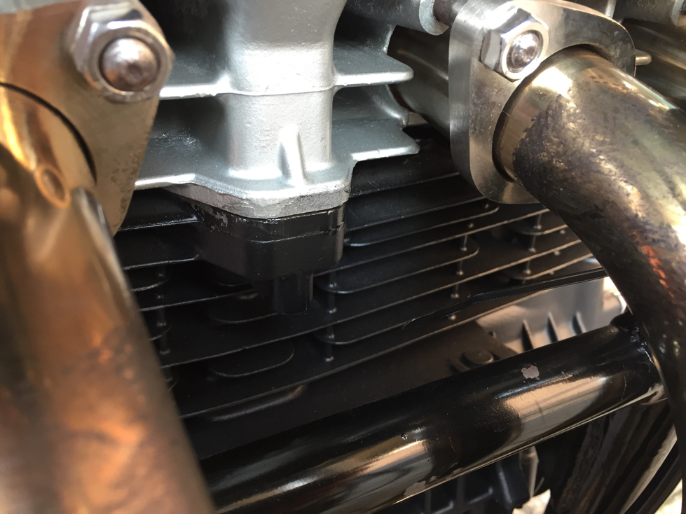

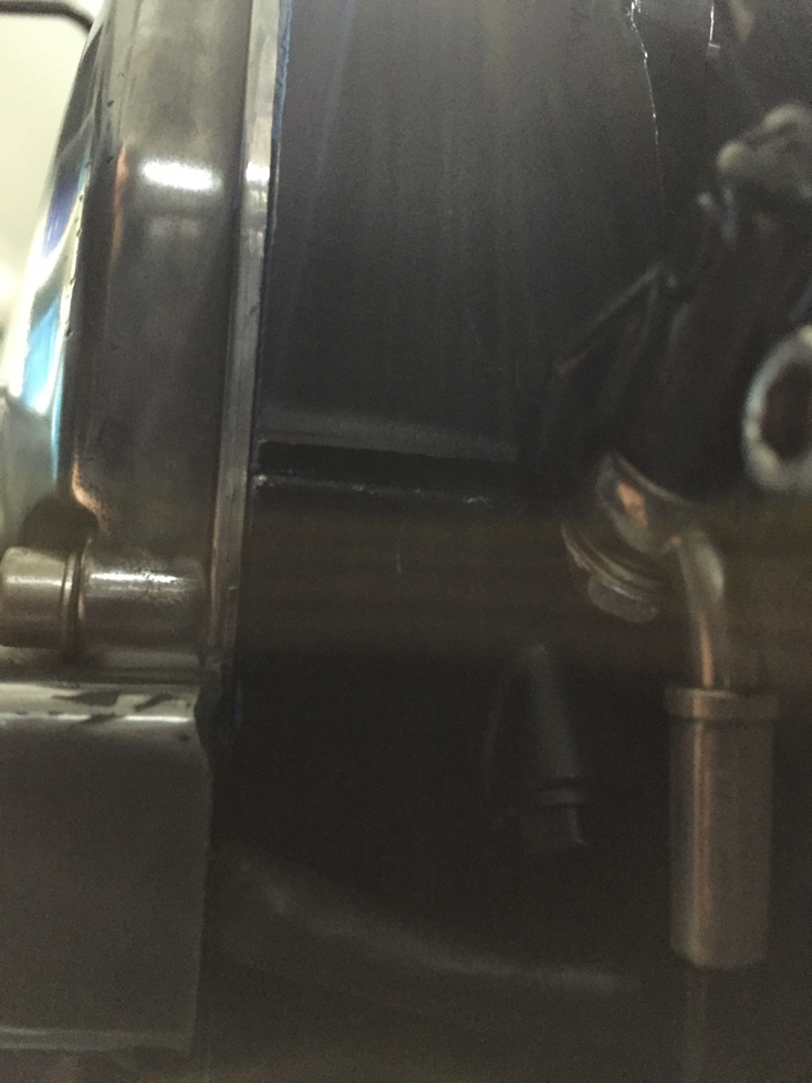

About the muffler.
I can make something at a friend of mine but than I won't have my bike with me for test fitting.
And when I am at my bike and it does not fit I don't have the tools to adjust it
Most stuff from Ali is for mopeds and scooters and the diameter is 54mm and my collector is 63,5mm.
But I have all the stuff I need now to make the connection.

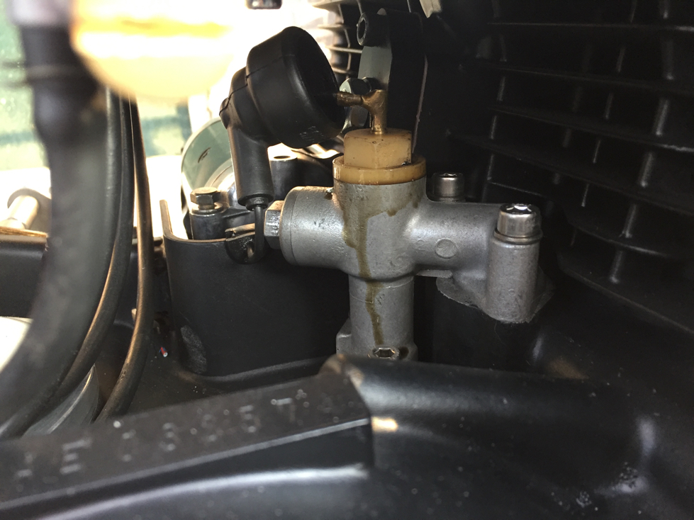

Also after starting I had some minor leaks :S
Head gasket, oil pressure switch and exit of generator cables.
The last 2 I can fix but the first one sucks.

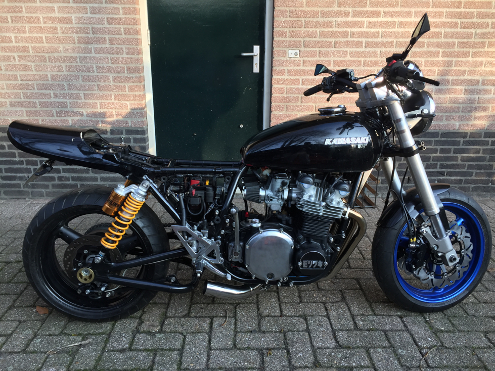

Re: Dutch 1977 Z1000 Build
26 Jan 2017 09:15 - 26 Jan 2017 09:18

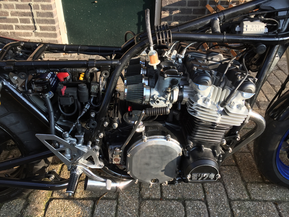

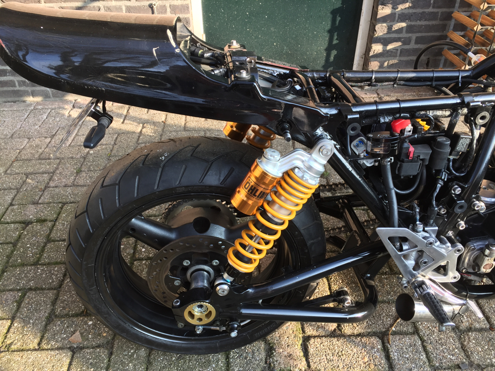

And some pictures in daylight.
Now I have to do some studying and working for the boss so it will be another week for more progress.
Eric
Eric

26 Jan 2017 09:23 - 26 Jan 2017 09:25
Wow!! It looks fantastic.Well done Eric. I have heard that the point where the wires exit the generator are a weak spot on a lot of bikes.Not just Zs and not even just Kawasakis. Mine was loaded with some sort of silicone kit.I cleaned it out and put on a fresh gasket.I havent thought to check it yet.
As for the exhaust, What about making the ends of your midsection,slightly oversize,cut a slot in them and clamp them on with jubilee clips.Then wrap it up with a bit of exhaust wrap.Not perfect but it shou;ld do to get you on the road and last until you can find a better solution.
Good luck with it.
Good luck with it.
