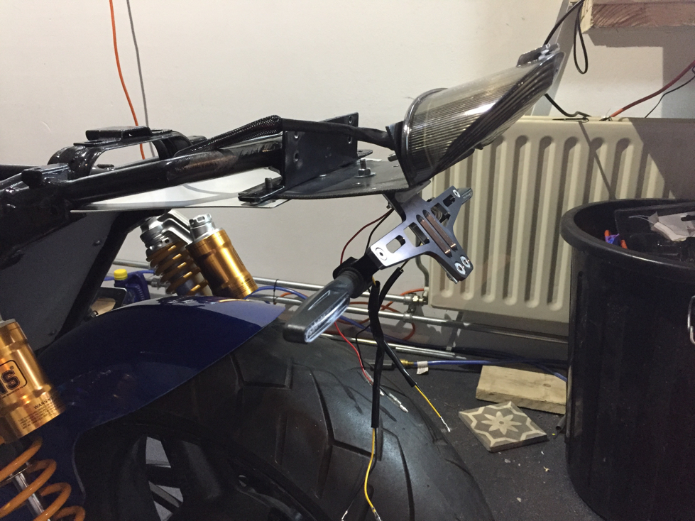

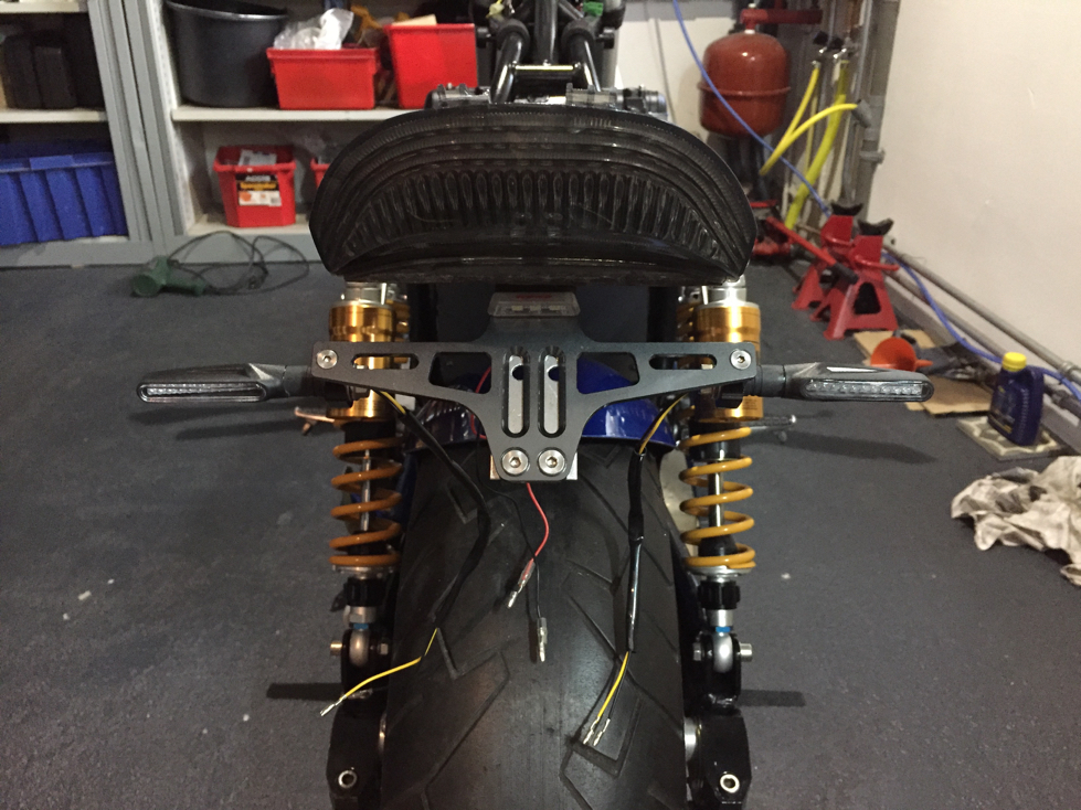

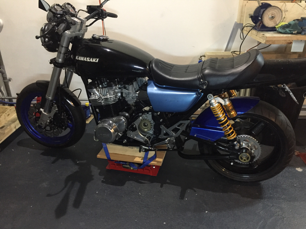

Licence plate holder and blinker, done.
Throttle cables from a ZZR600 , done.
Hydraulic clutch, done?!

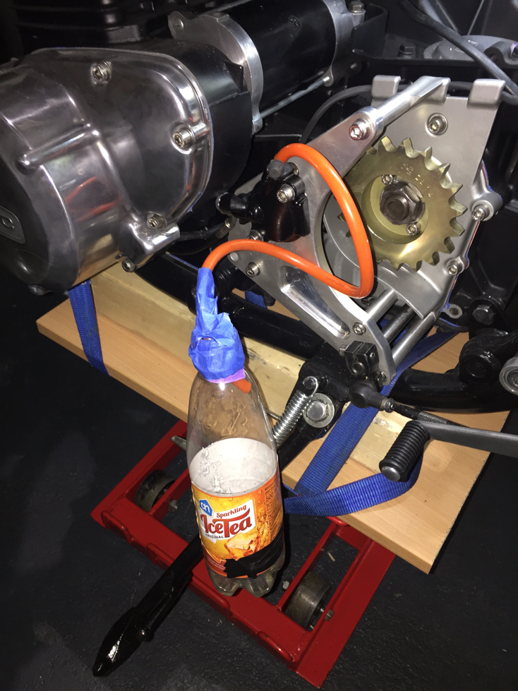

I cut 5 mm of the clutch shaft.
Bled the line and have a cylinder moving.
However..... it moves only for about 2mm, is this enough for the clutch to disengage?
Headers will be arriving end of the week.
Carbs are fitted with 122 main jets (metal ones)
Hope first start in about 3 weeks.

the bike looks awesome wiers!!! :evil:
i'm a lil curious about you having vibration (metal fatigue/cracking)issues with your flat sheet metal tail light bracket tho .?
it seems an upright piece of sheetmetal on edge welded or rivited in line between the frame and the back of the light could go a long way to damping the vibes there.
bike turned out great thanks for letting us follow along.

Hi Leon,
You are right about the tail light bracket, I am gonna change that to something with a vertical piece of metal.

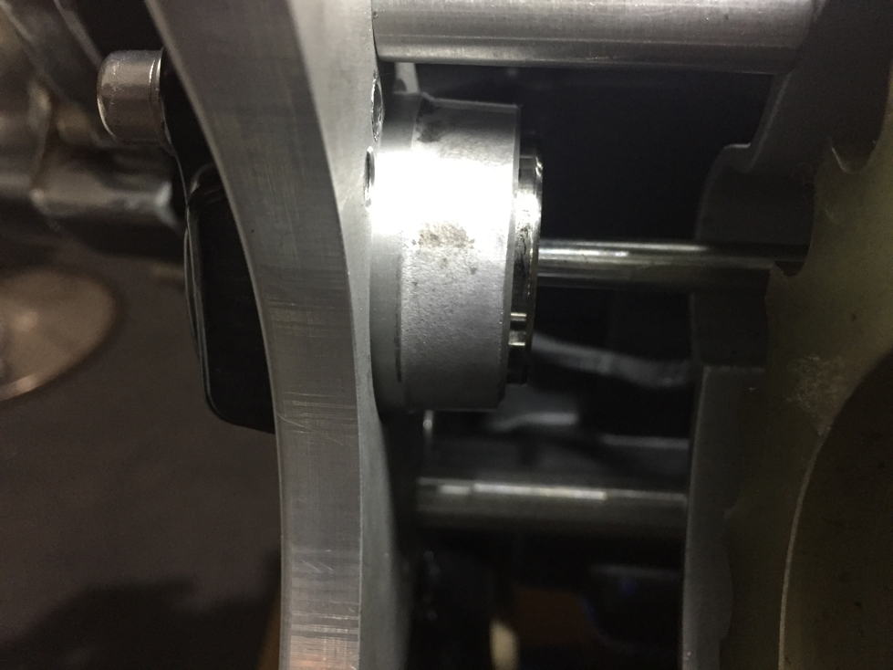

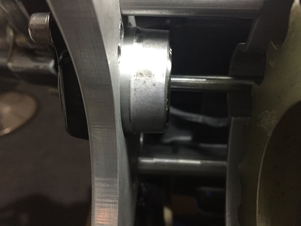

The spacers are the standard length from D&G, I just put the piston against the rod and measured the distance between the hydrailic clutch and the D&G plate.
This was about 5 mm and this is wat I cut of the rod.
Now the unit unit is flush with the D&G plate and the ball of the piston is gently pushing against the rod.
After bleeding the line the springs of the clutch keeps the piston at its place (it is much stronger than the spring behind the piston).
My only concern is that it moves for only 2 mm (see pictures) and wonder if that is enough the disengage the clutch.
Thanks for following my build and for your positive input.
Eric

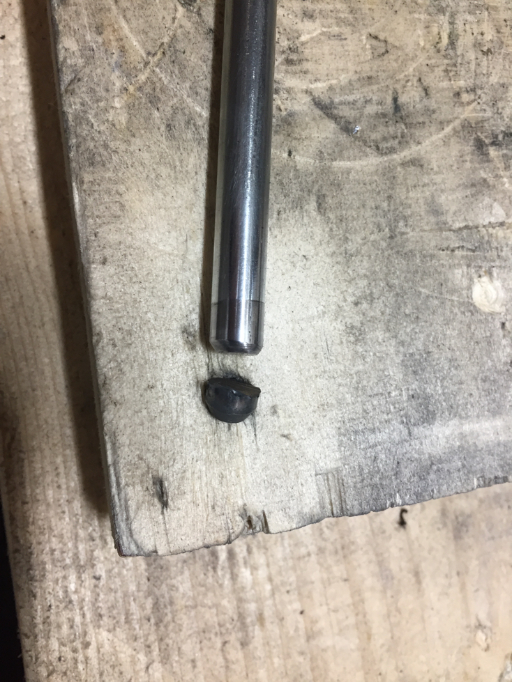

Lovely work Wiers....I think you may have to harden the end of the push rod having cut off that 5mm. I believe they came with both ends hardened from the factory.

What Clutch Slave Cylinder are you using?

I do not know from which bike the clutch slave cylinder is.
It came in a box of parts with the bike.
I think it is from a Kawa and have seen it a lot on this forum.
About the rod ends, how can you harden them?
Eric

Re: Dutch 1977 Z1000 Build
08 Jan 2017 16:10
I don't think that's necessary.

It isn't necessary to harden the shaft on the pusher. Drag race buddy who is the local god of Kawi engines says the clutch only opens about 80 thousands of an inch when working properly. You may find another bleed after riding a bit may allow a little bit more air to escape, it doesn't take much to soften the action.
Good luck
David
Good luck
David

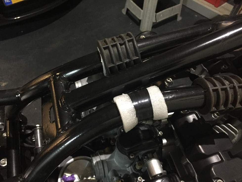

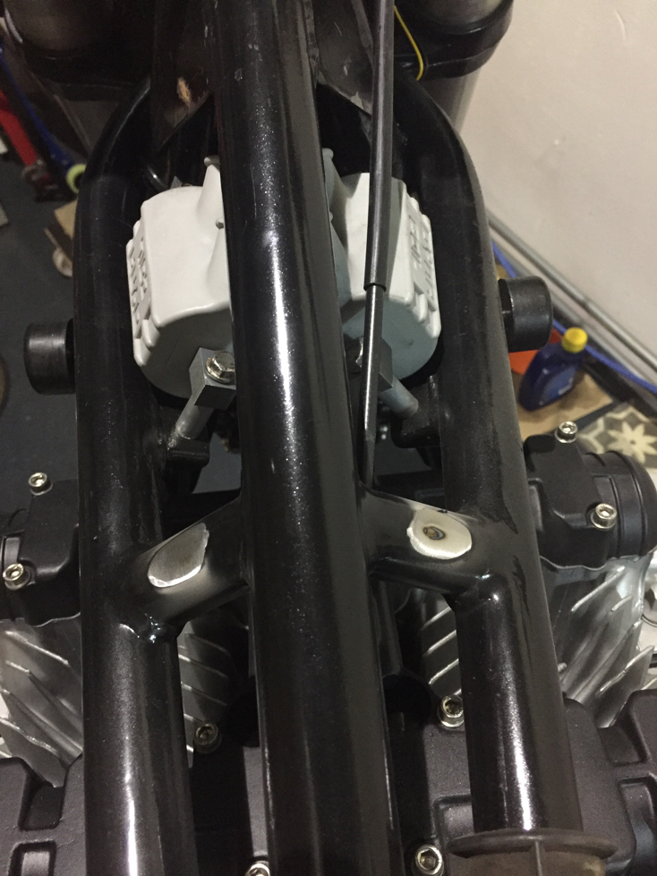

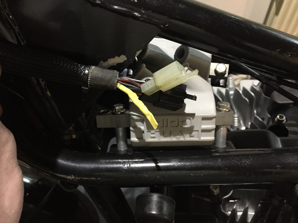

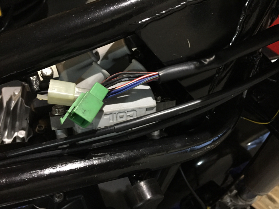

Throttle cable, Dyna Coils and wiring are all fighting for the same space
And the winner is..
The fuel tank :pinch:

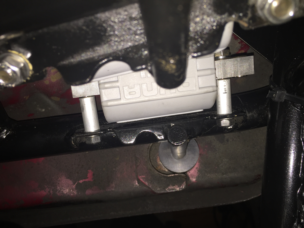

The fuel tank is hitting my welded braces and does not leave any room in the front for electrical kabels.
When looking under the tank I found this.
It looks that there is an option of welding the rod one point further backward.
Is that for other model tanks??
Not an option for me because if I put it further backwards My seat would not fit anymore.
Only option I have is taking the grinder and start attacking the frame.
And lifting the backend a bit by taping some foam under the tank rubbers.
Also my front brakes started leaking again
Taking the day off tomorrow.
09 Jan 2017 15:34
I'd be worried about the tank leaking. Maybe denting it in those places?
