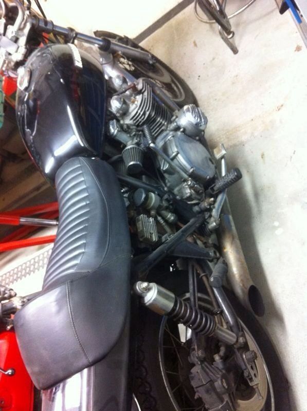

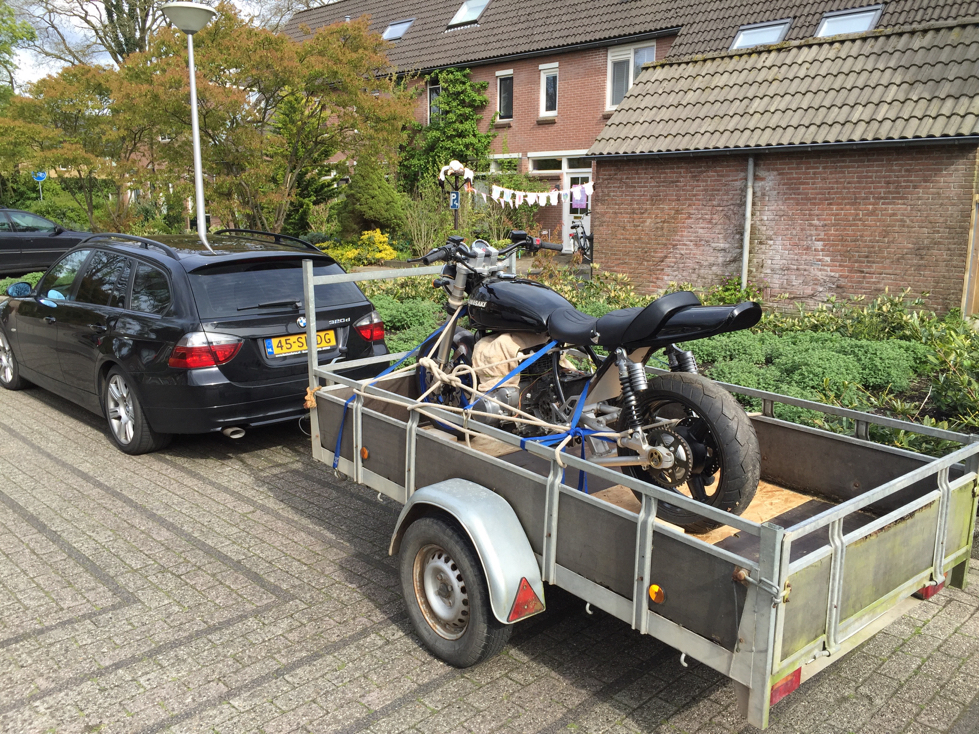

Already to manny words and no pics so before loosing attention I will start with some pics.
as it was bought by the previous owner.

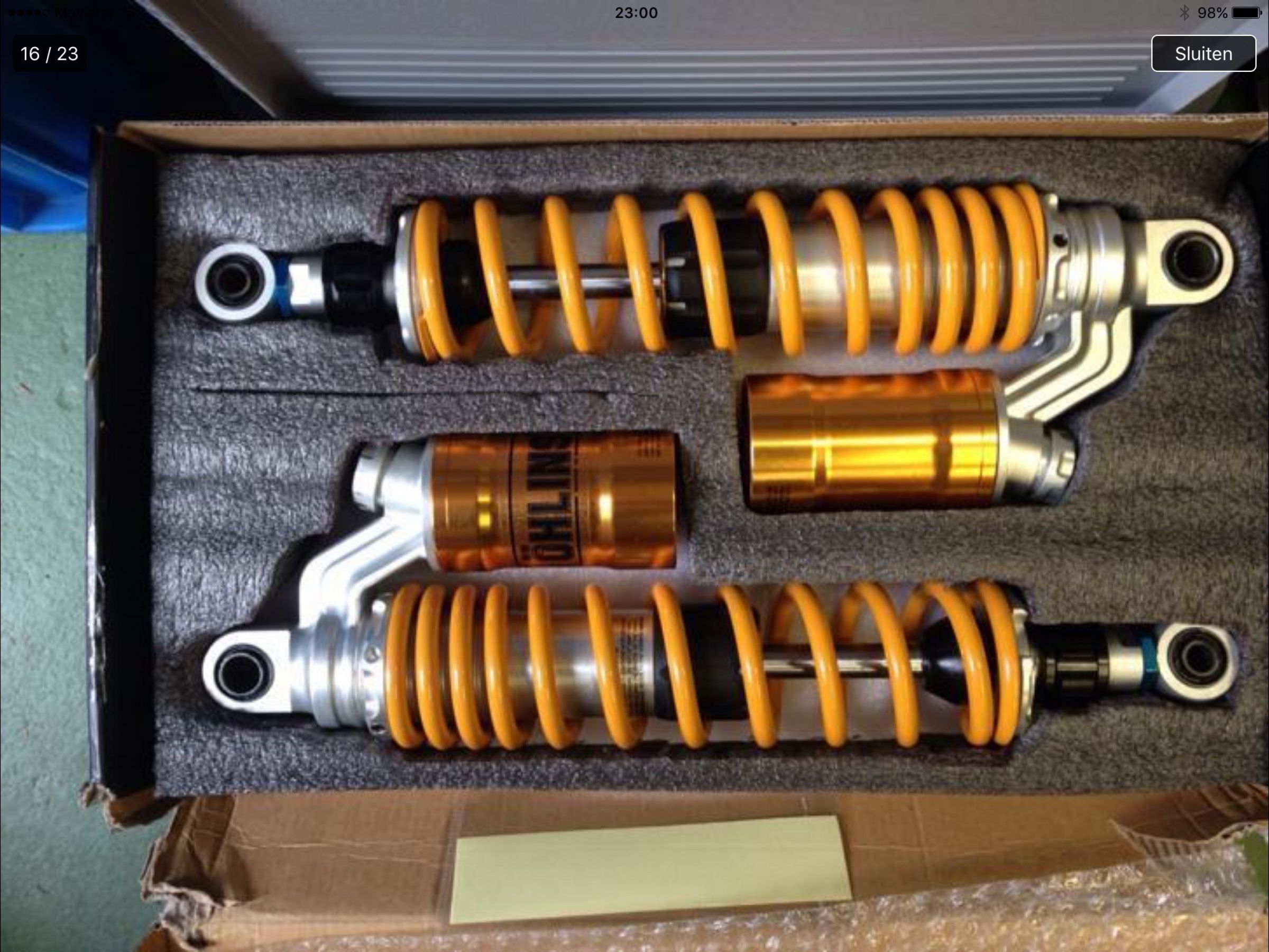

Welcome aboard! I hope those shocks were from a reputable source and not from Ichiban Moto (see link below). Just kidding.

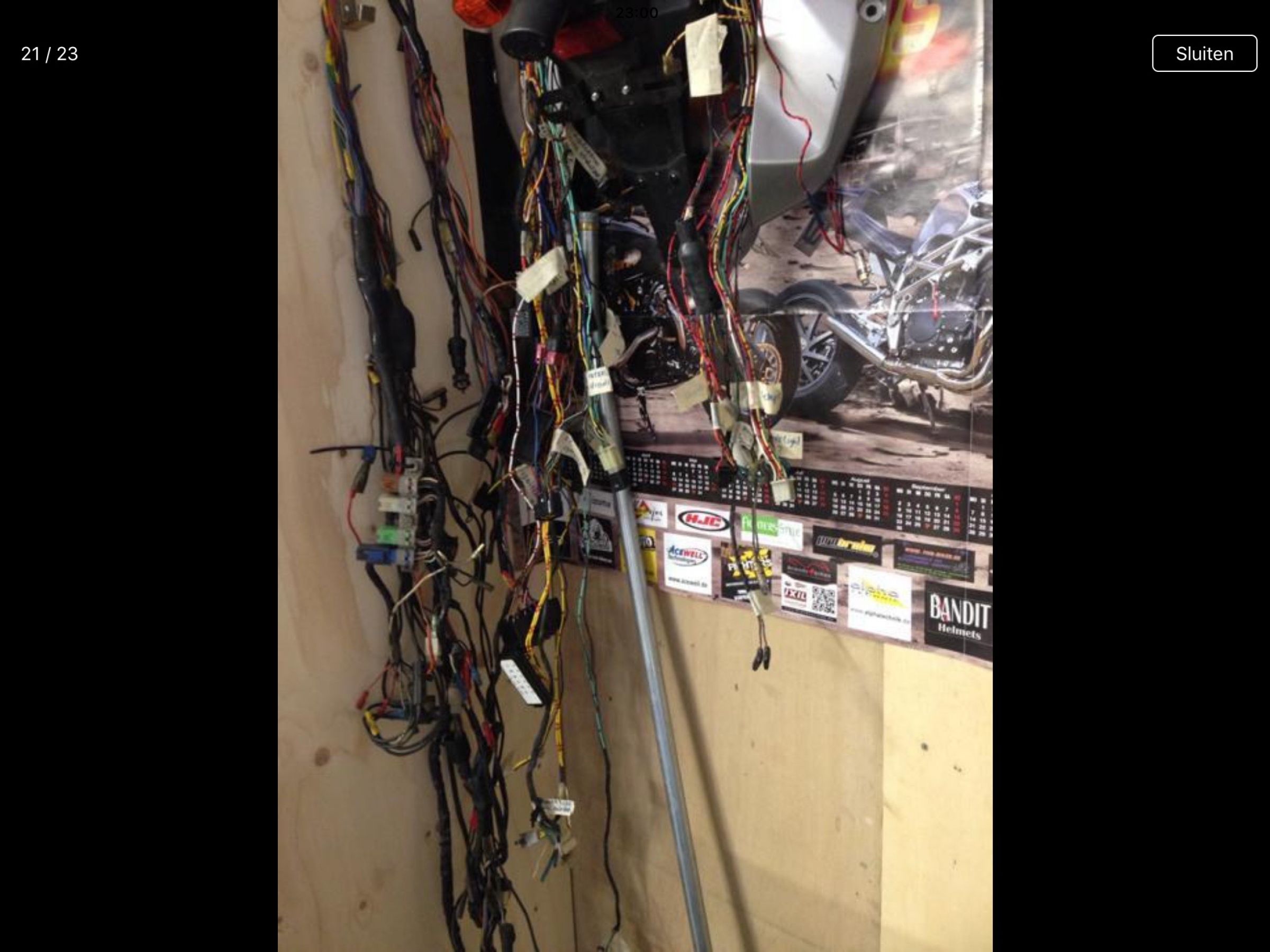

Ed, I admit I have some items from China :woohoo:
But those are more for show and things like wires, waterproof connectors, blinkers and heat shrink cable.
Nothing where my life depends on like drive train or suspension :laugh:

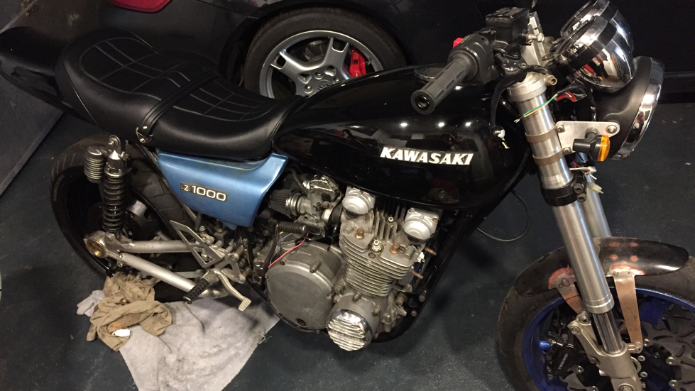

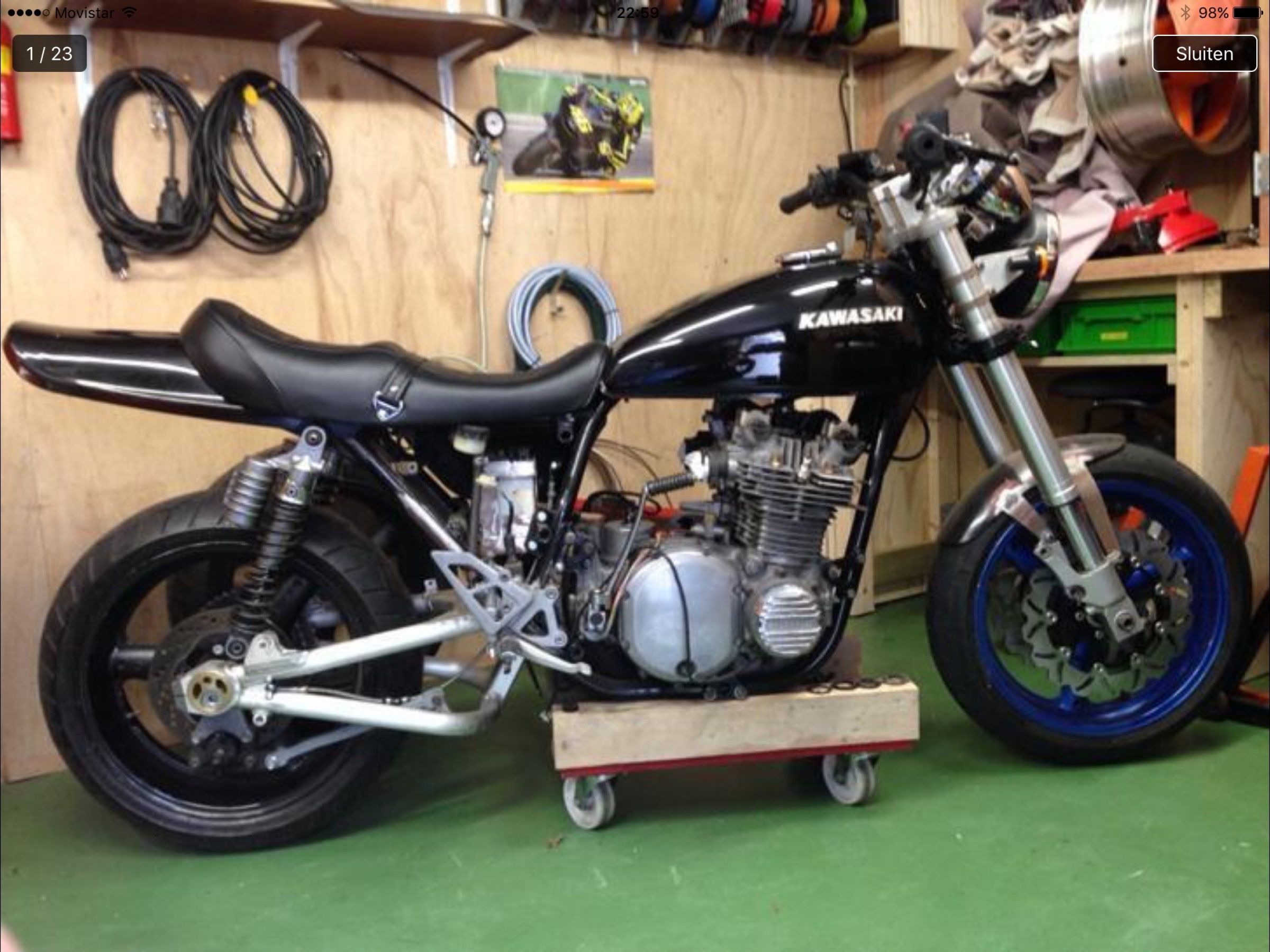

First thing I did was sorting things out.
What I have to start with :
-1977 Z1000 frame,tank side caps seat and engine which was running a year ago according to the previous owner.
-1993-1998 GSXR110 Suz front and wheels plus brakes.
-rear of a Kawasaki ZRX1100 (don't know the year exactly)
-wiring loom of a ER5 Kawasaki
-Handles of a ZX6R and I think also the cockpit and ignition switch.
Things I already bought:
-Dyna 2000 ignition
-DID 114 link chain
-14mm offset 19 tooth front sprocket
-40 tooth rear sprocket (took my a while to figure that out. Z1000 offset front to Suz wheel on ZXR110 rear :pinch: )
- numerous small bits and parts.
The Plan!:
-Fixing wiring loom(done)
-Fixing sprocket alignment (almost done. tomorrow will be shaving 2 mm of the rear hub)
-Clean carbs with fresh seals and needles (partly done, will be spraying some parts before reassemble )
-Remove and clean engine for spraying (Is the only thing I will be doing to the engine apart from electronic ignition)
-prep the frame for welding ( most is partly done but need some professional looking at it)
-refurbishing the Tokico brakes.
-Installing hydraulic clutch on D&G clutch release mount.
etc,etc
