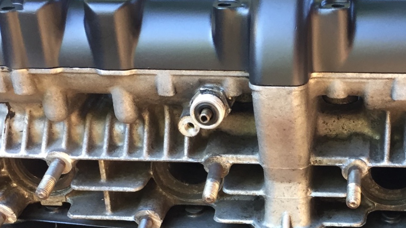

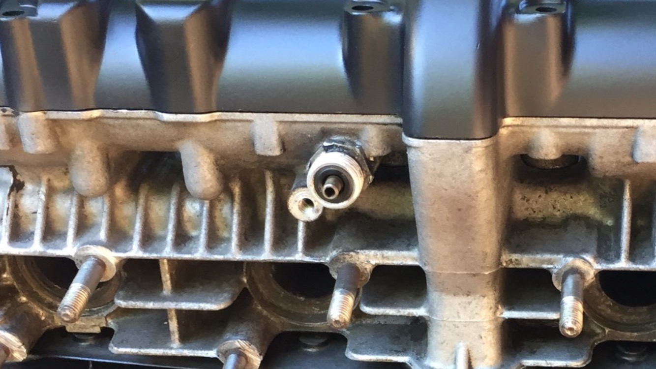

Need help on removing tachometer part on the engine side.
Put a wrench on it and it turns but does not come out.
Any ideas?
Any ideas?
- Posts: 7442
Re: Dutch 1977 Z1000 Build
26 Aug 2016 05:44 - 26 Aug 2016 05:46
it is only held in by o-rings .it just slips in and out.
here is a tach drive block off for reference www.z1enterprises.com/product/PM81-2290
Last edit: 26 Aug 2016 05:46 by 531blackbanshee.
The following user(s) said Thank You: Wiers
26 Aug 2016 07:25 - 26 Aug 2016 07:27
That explains why it turned easily, I did not want to use force to get it out.
Thanks again Leon, you are a great source of information.

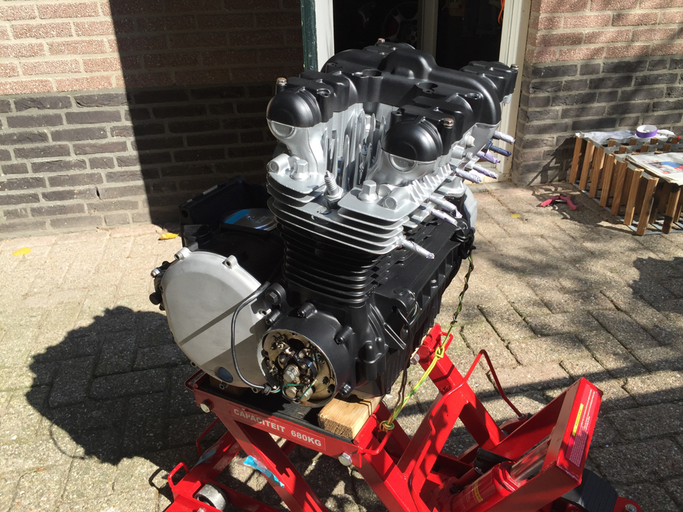

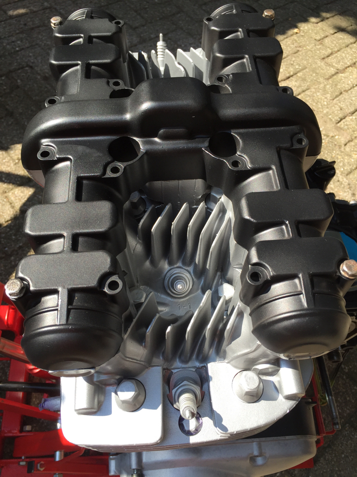

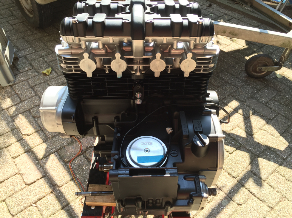

Last update for now.
Painted the cylinders and some parts silver/grey.
Don't know of it stays on for long because my wife would not let me put the entire engine in the oven
Need some polishing to do and have to order some gaskets.
Can't wait to start putting stuff together instead of taking things apart.
But first a few days at the office and than next week taking my other toy for a road trip trough Europe.
Eric
