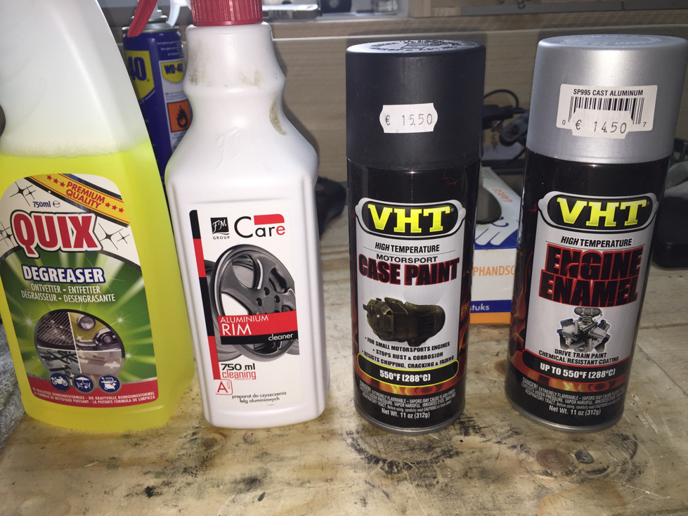

- Wiers
- Posts: 256
- Thanks: 28

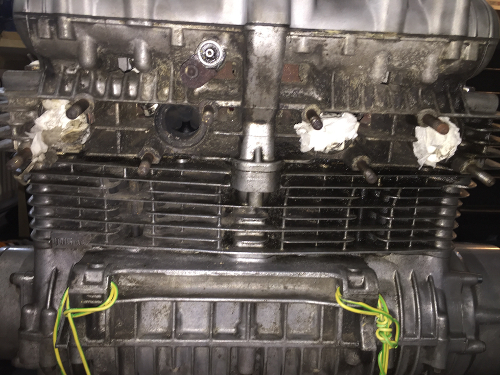

Re: Dutch 1977 Z1000 Build

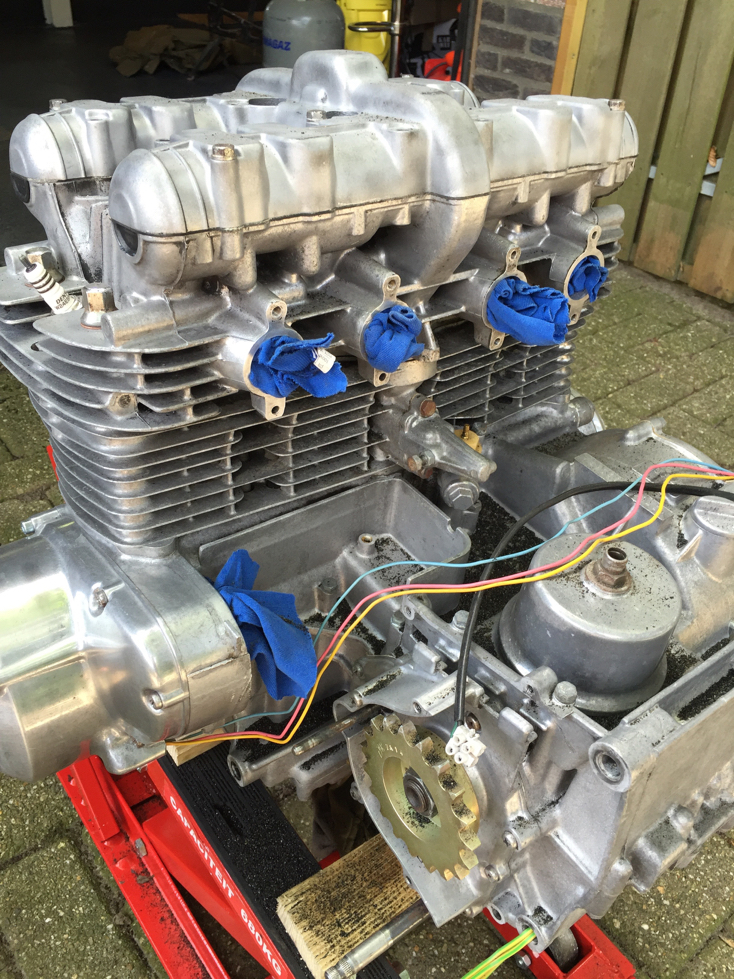

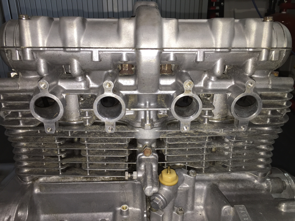

16 Aug 2016 05:27

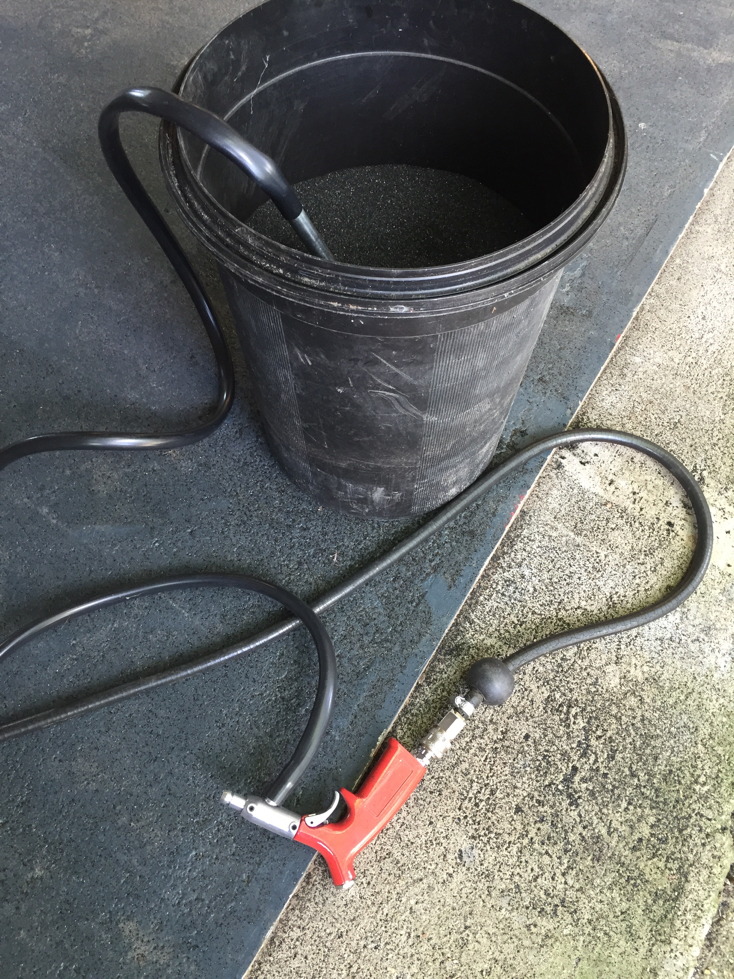

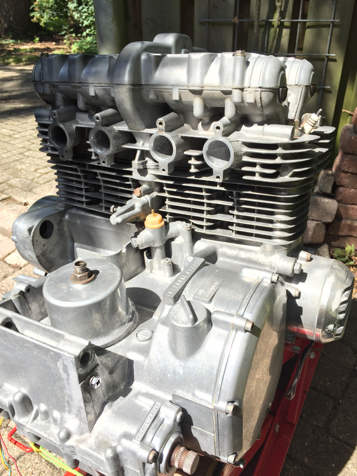

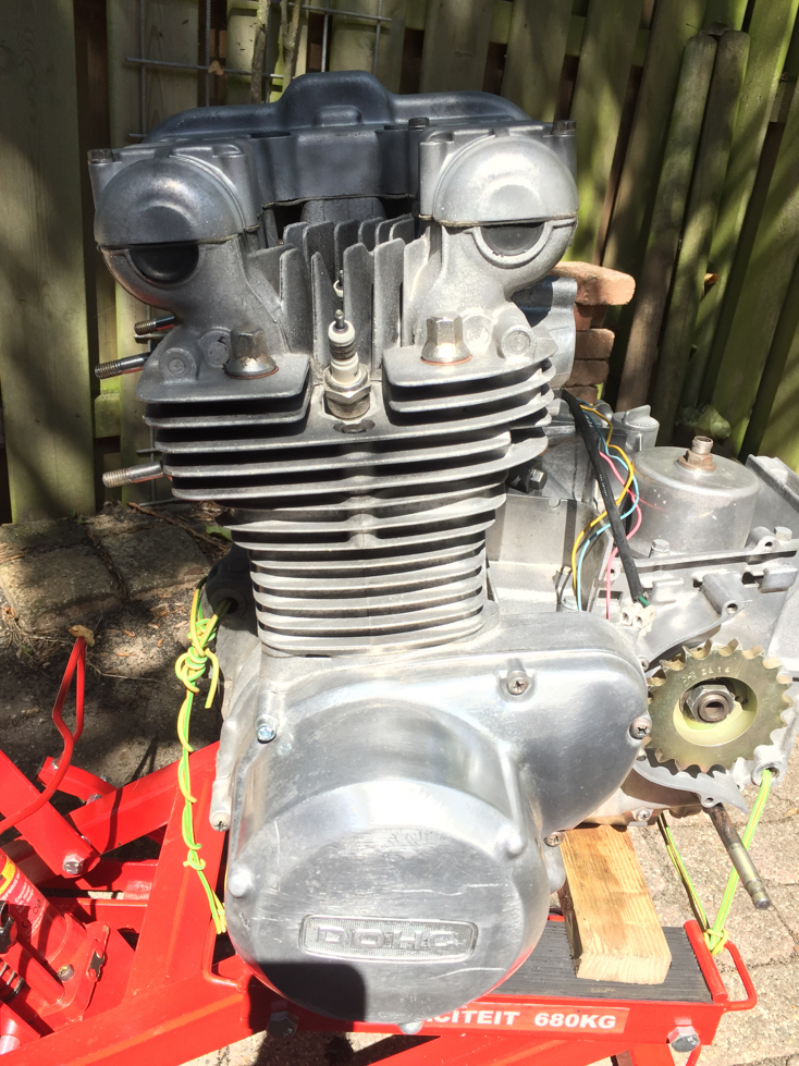

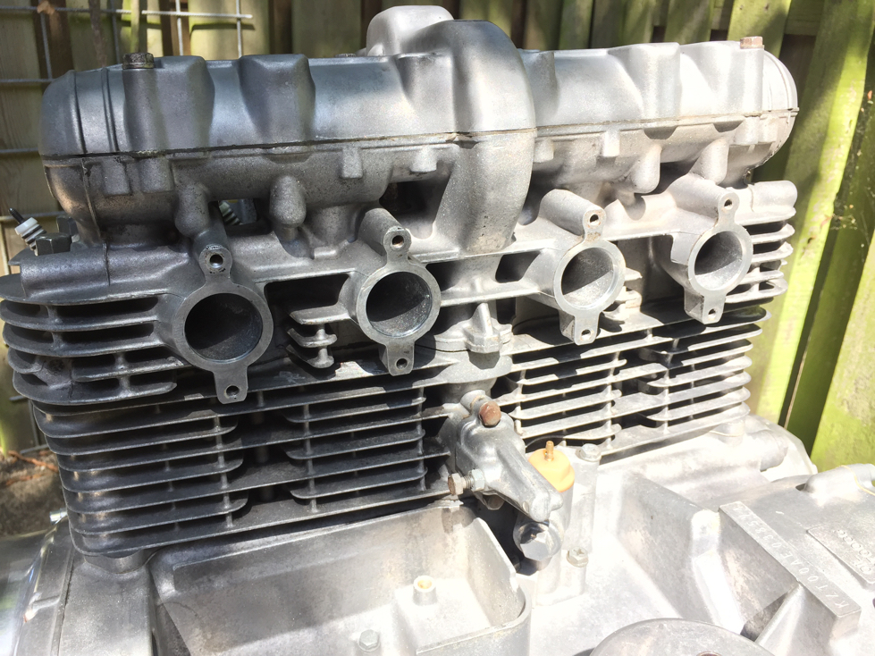

After cleaning with degrease and high pressure hose.
Then the $20 grid clean equipment
And verry happy with the result.

I have tried soda blast with a different gun but it blocks easily.
Maybe I give it another go with this air gun.
If you start blasting protect yourself because the return blast can hurt your skin

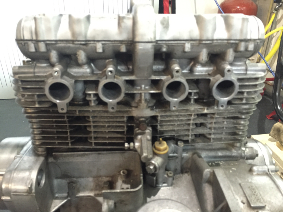

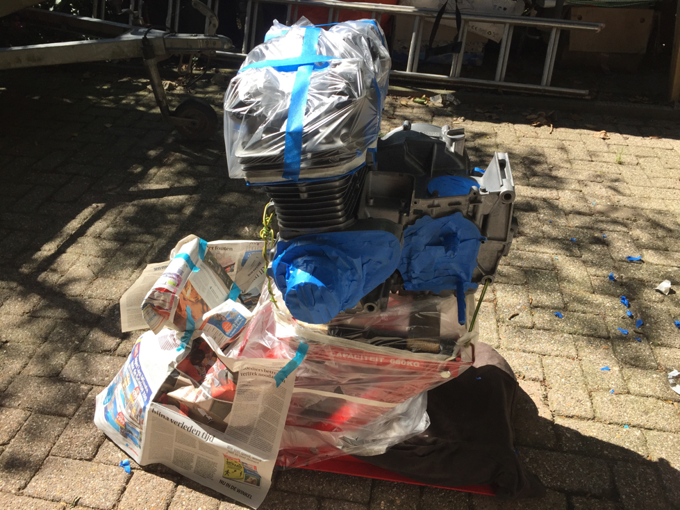

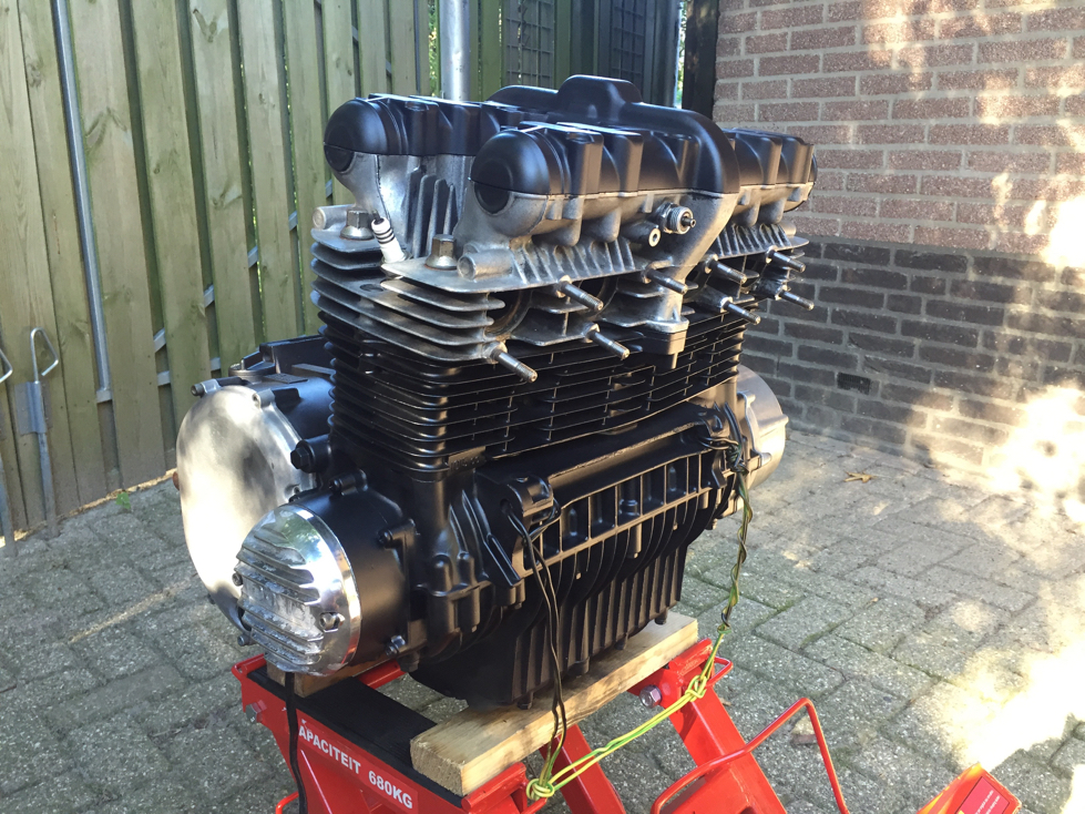

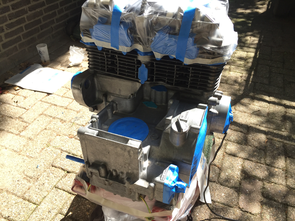

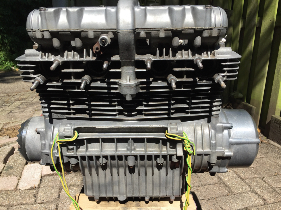

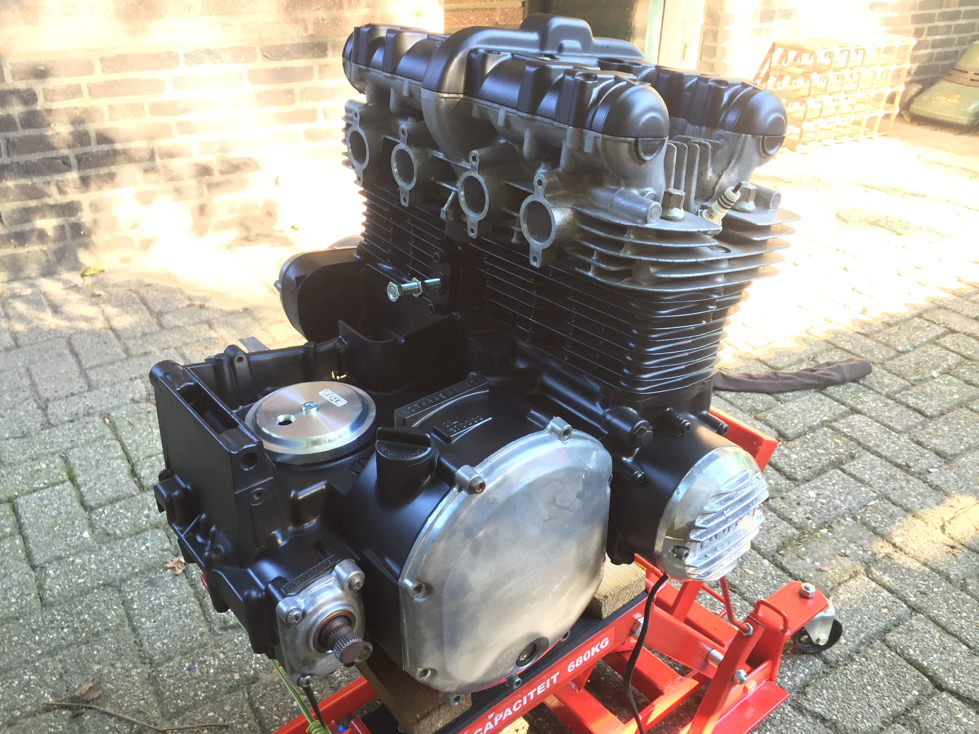

24 Aug 2016 08:46

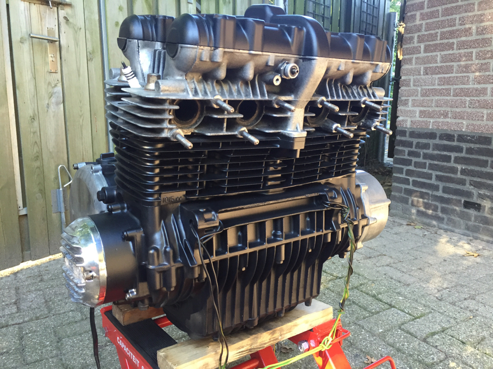

Finally summer in Holland.
But before relaxing in the sun I got a job to do.
Painting the engine while it is dry and sunny outside.
200 meters of masking tape :pinch:
And after spraying could not resist to put on some covers (wil be done later)
Very happy with the result :woohoo:
Now of to the pool.
