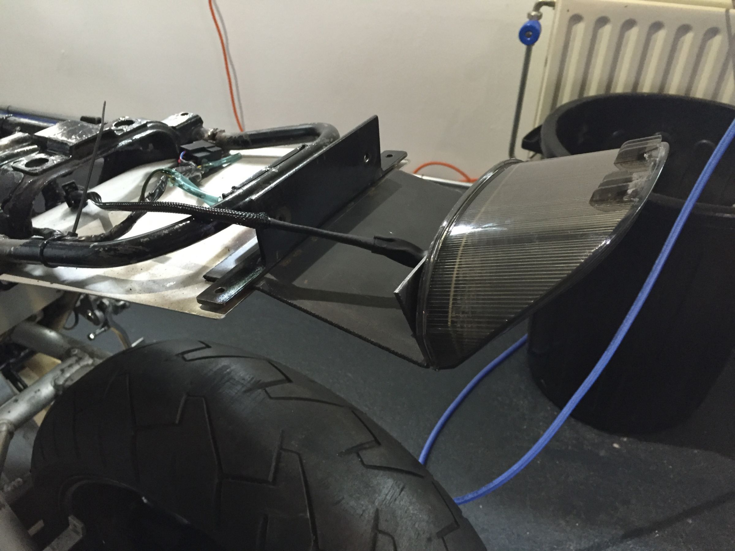

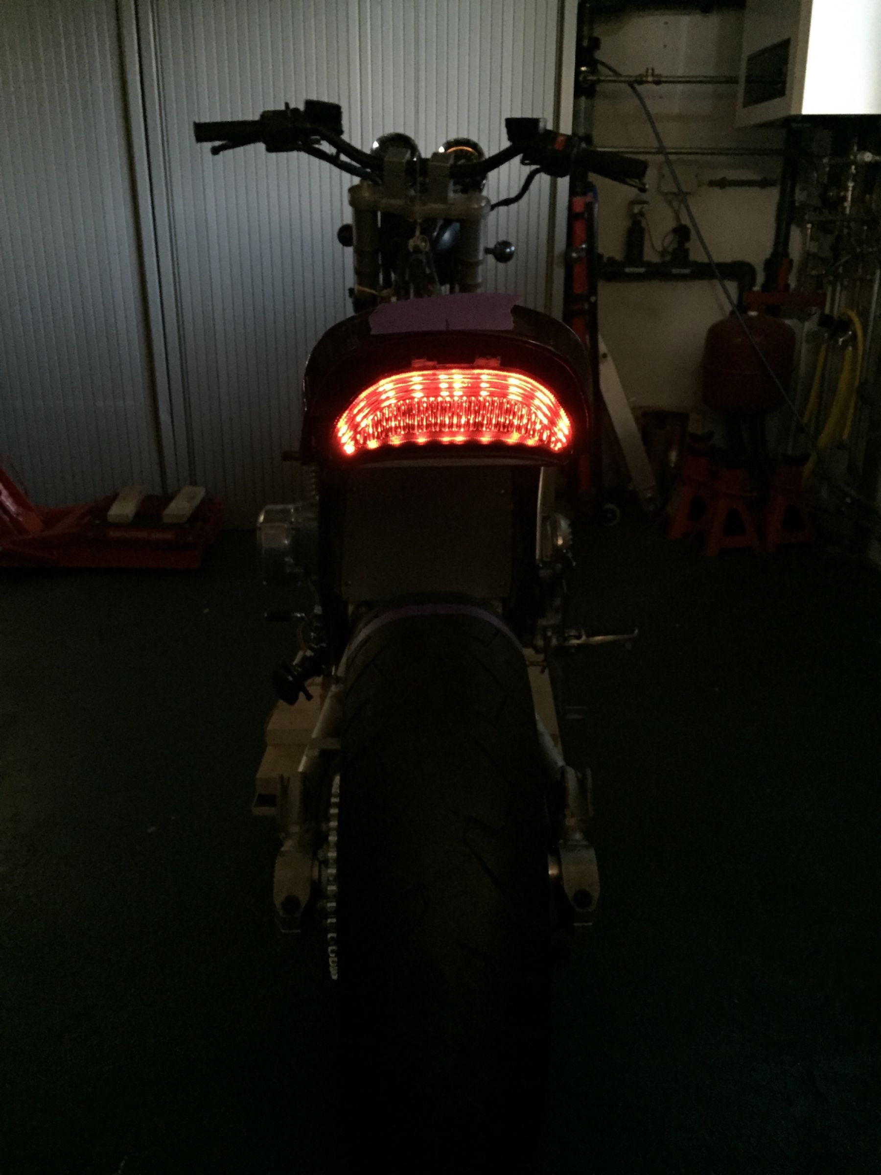

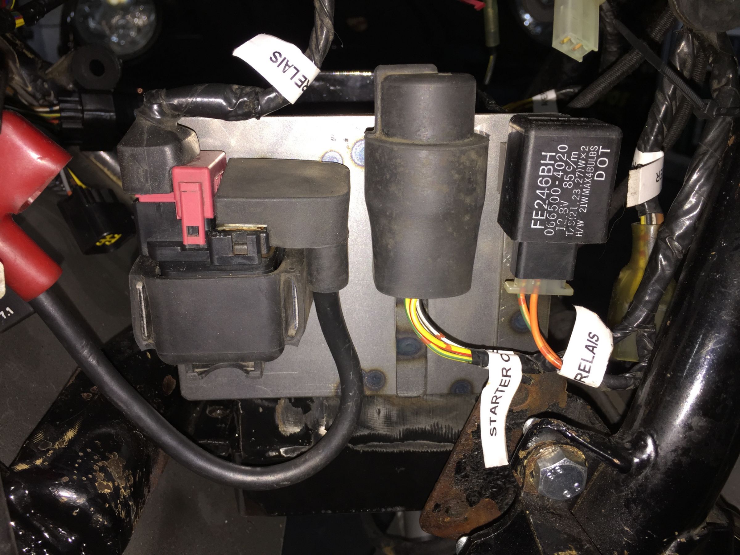

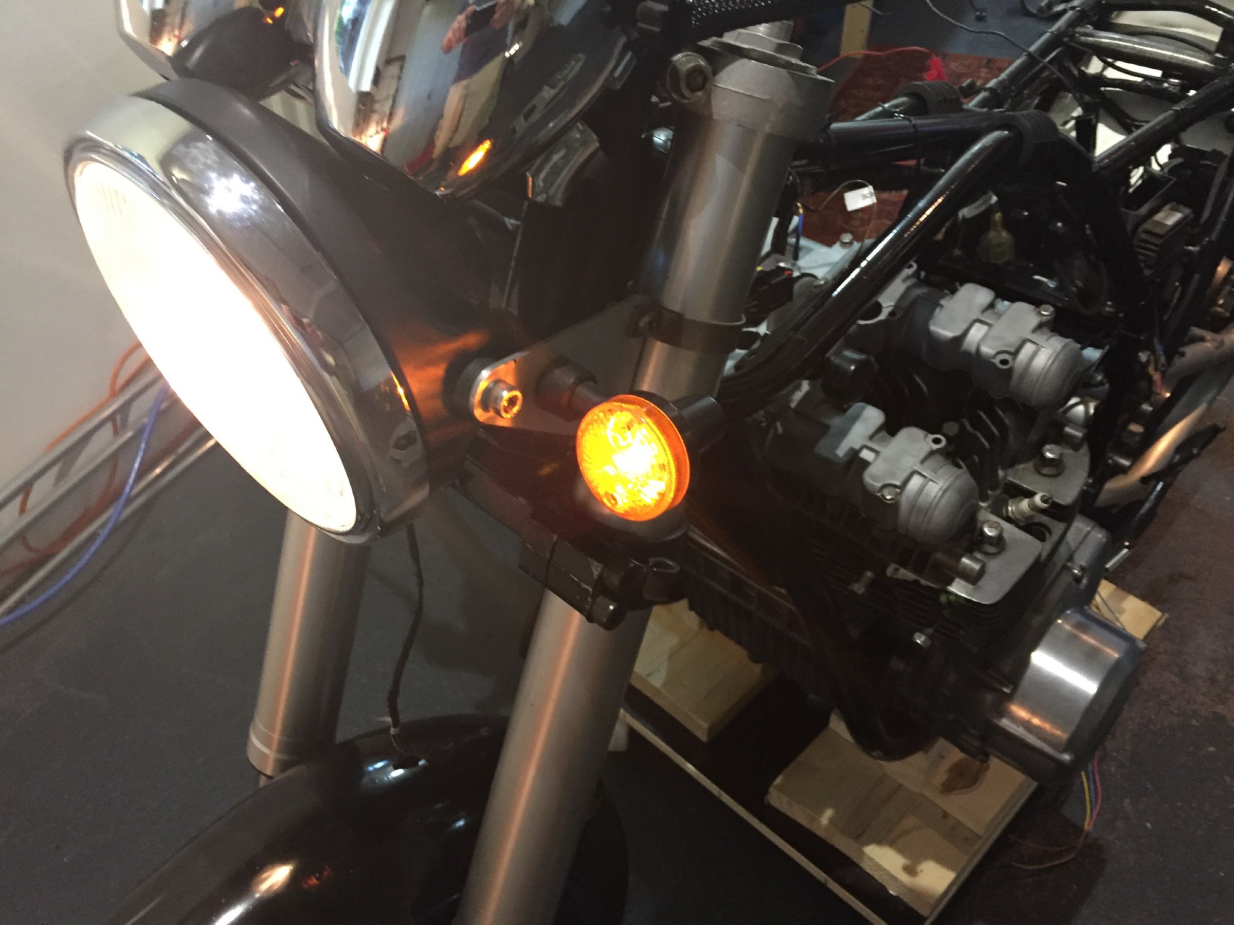

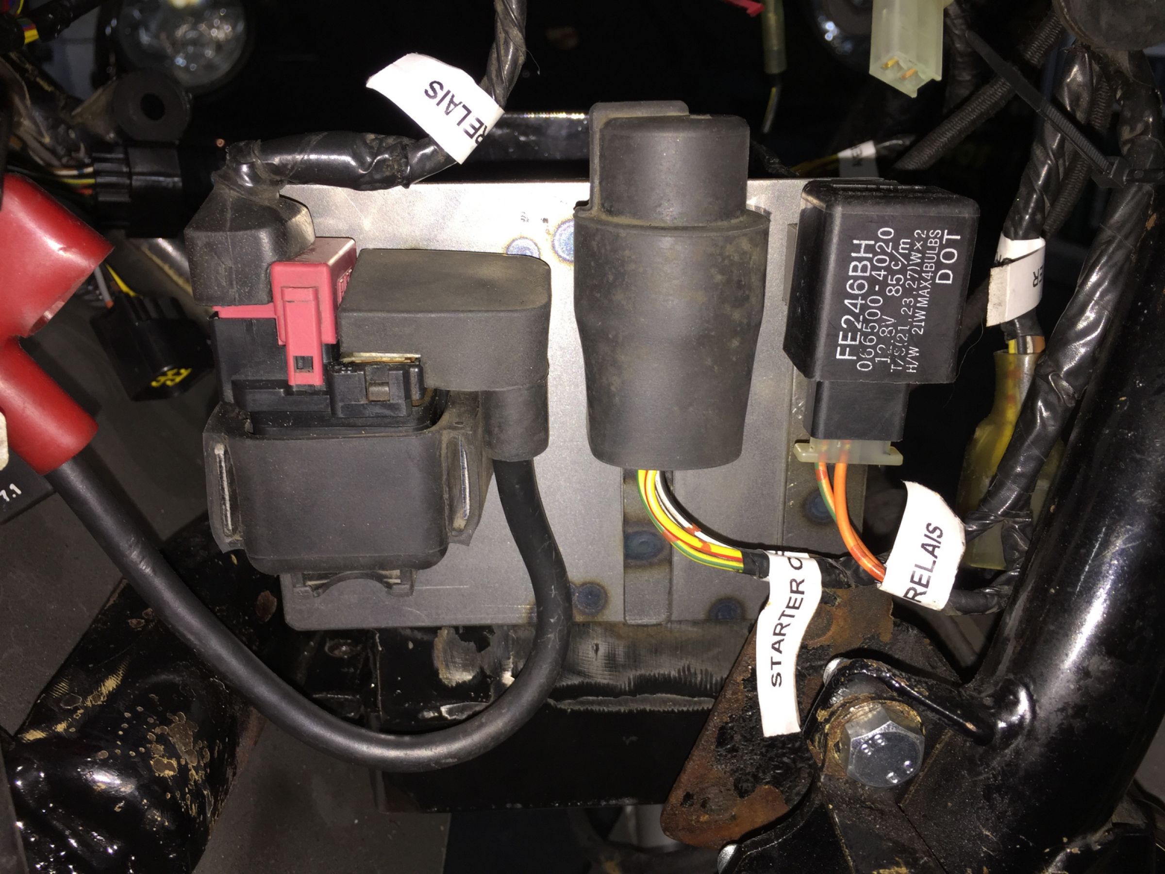

Some other jobs done or almost done:
Bracket for rear light (CBR600R)

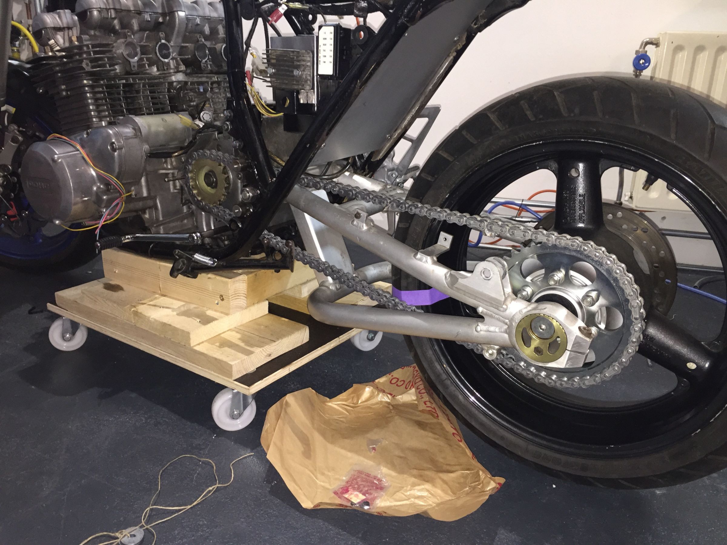

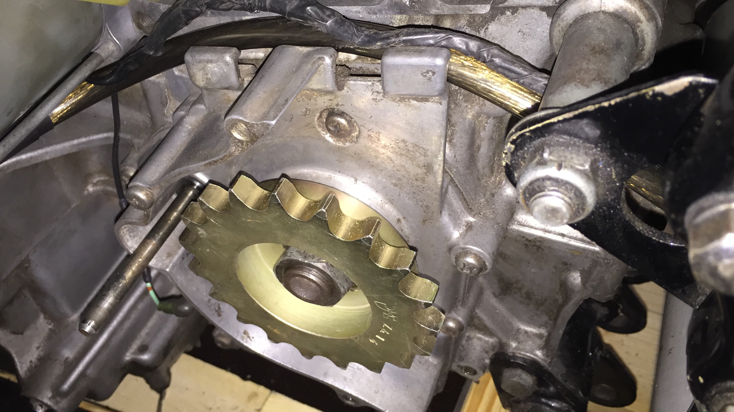

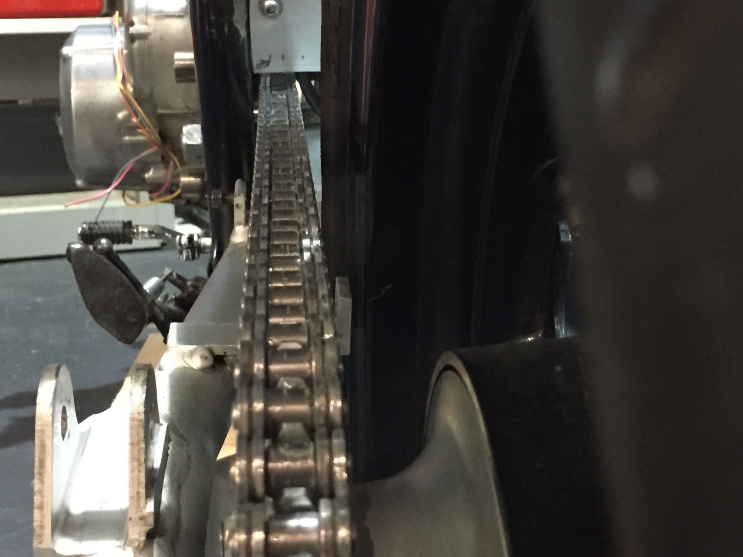

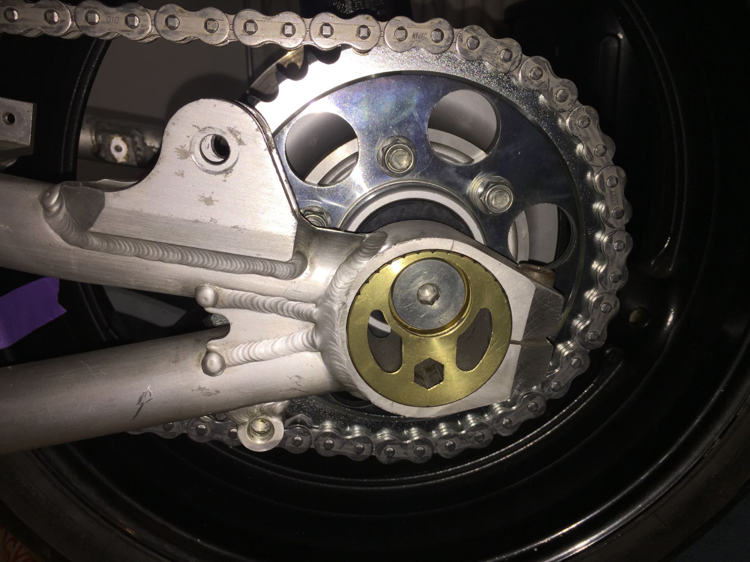

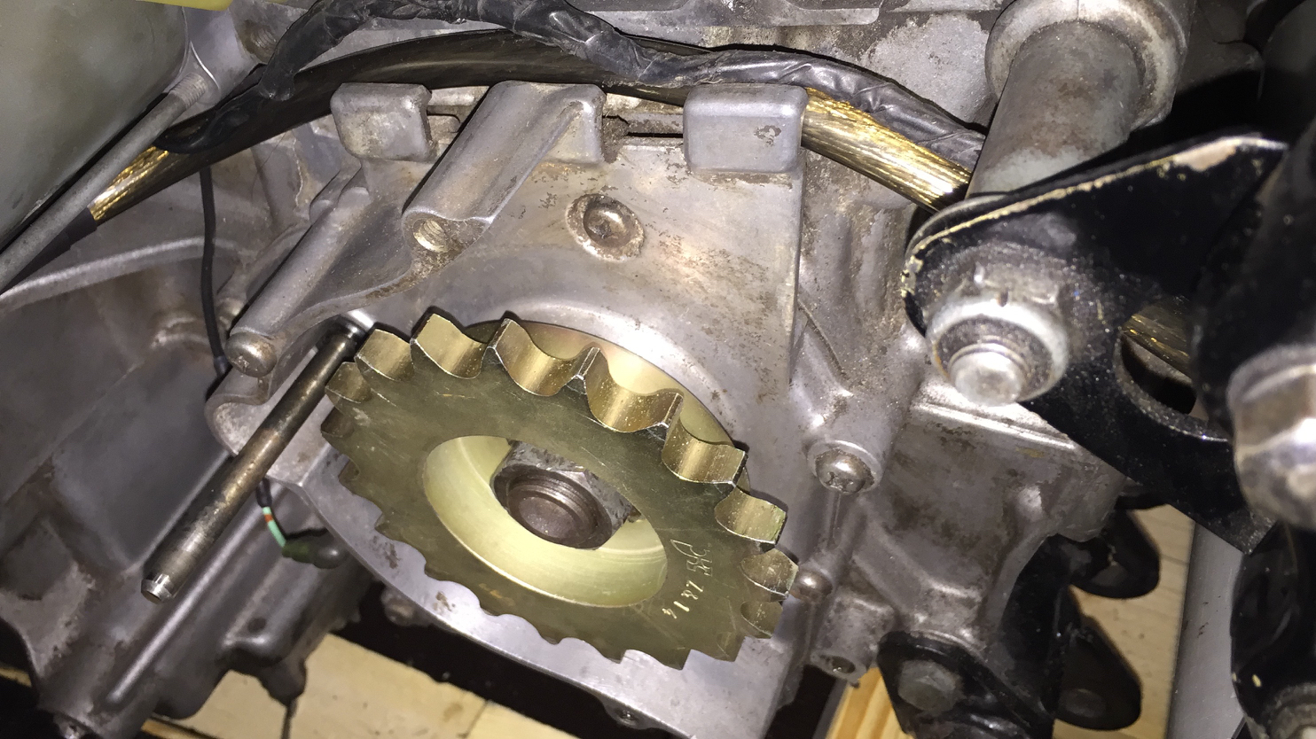

Chain and sprockets:
Good clearance on both sides, need 2 mm of the hub to get better alignment.
Have about 5-6mm between tire and chain so that will be ok.

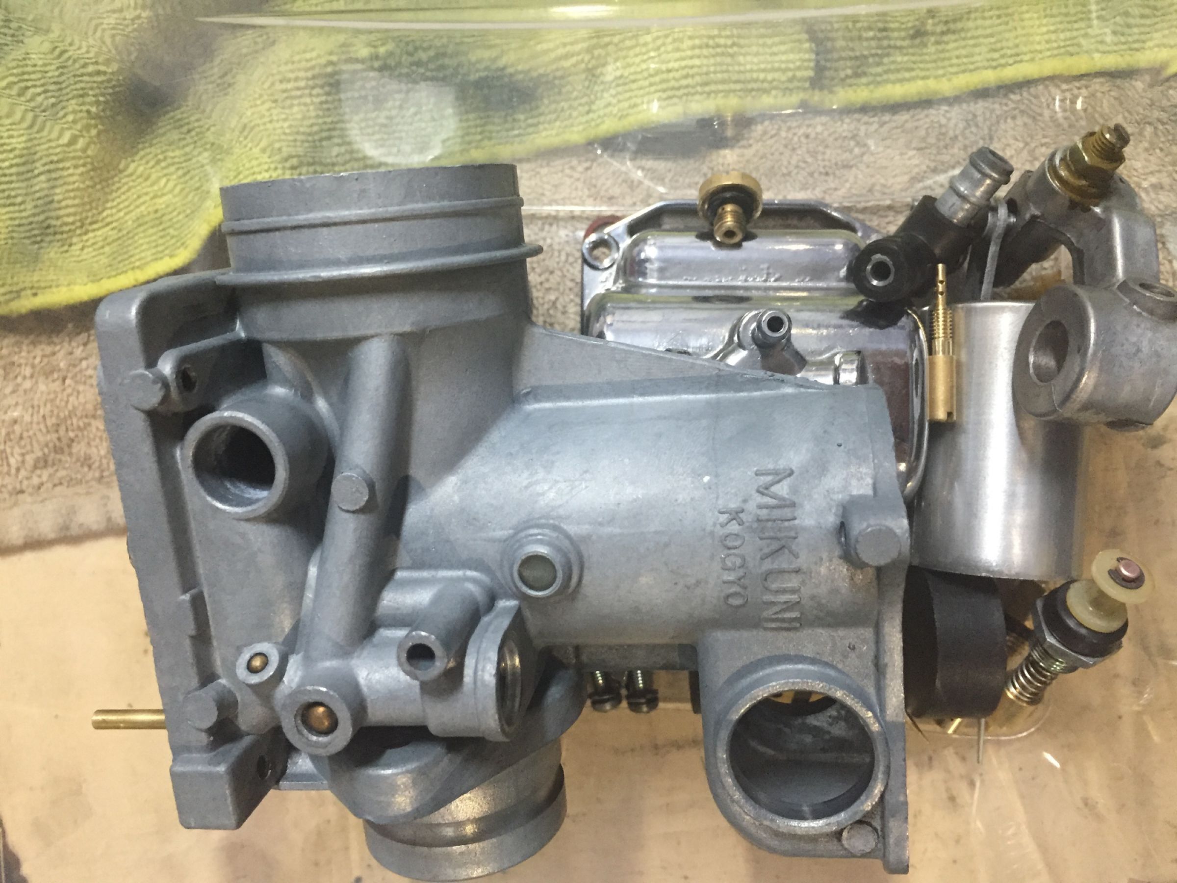

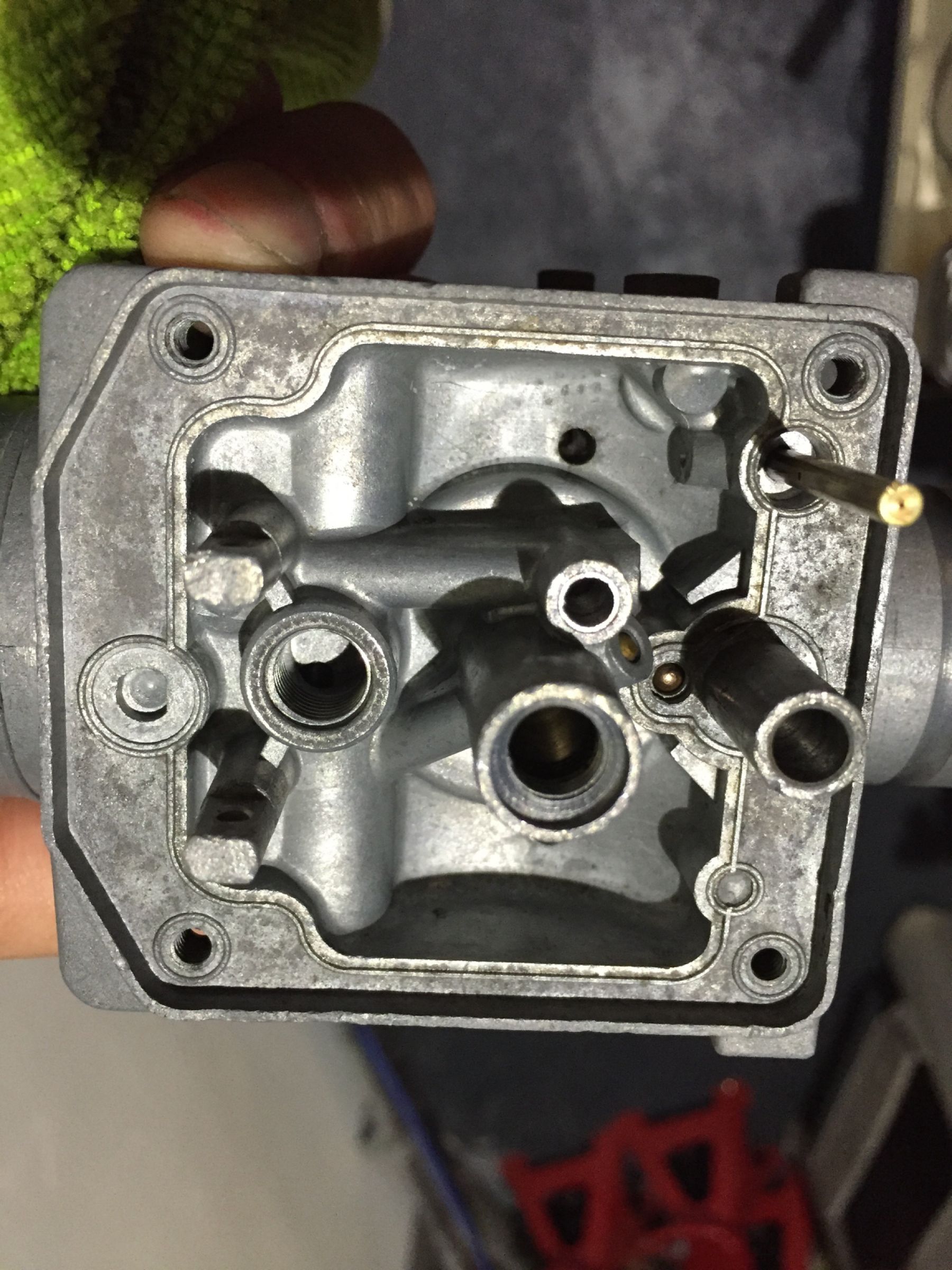

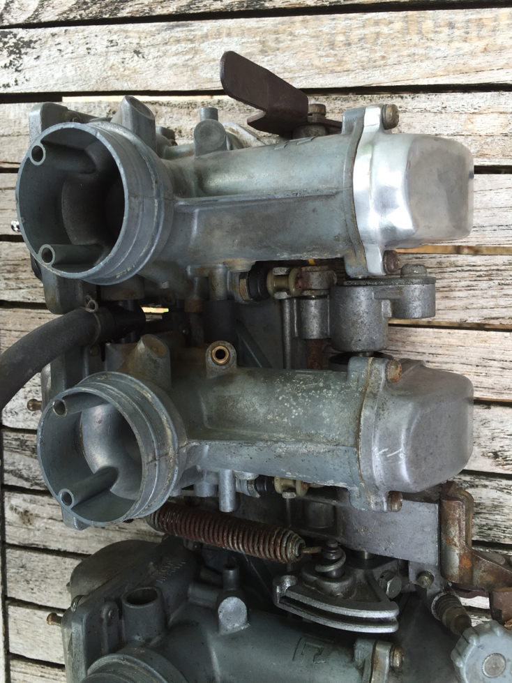

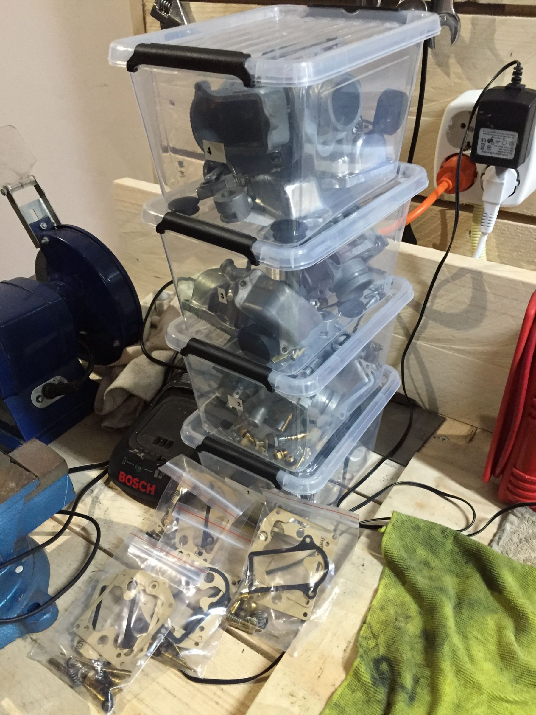

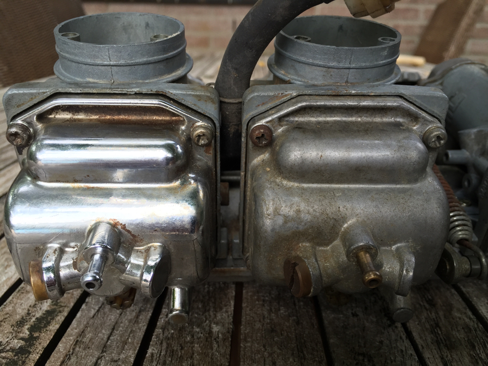

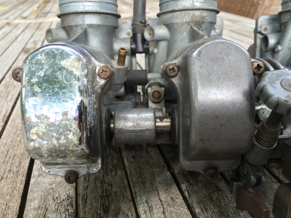

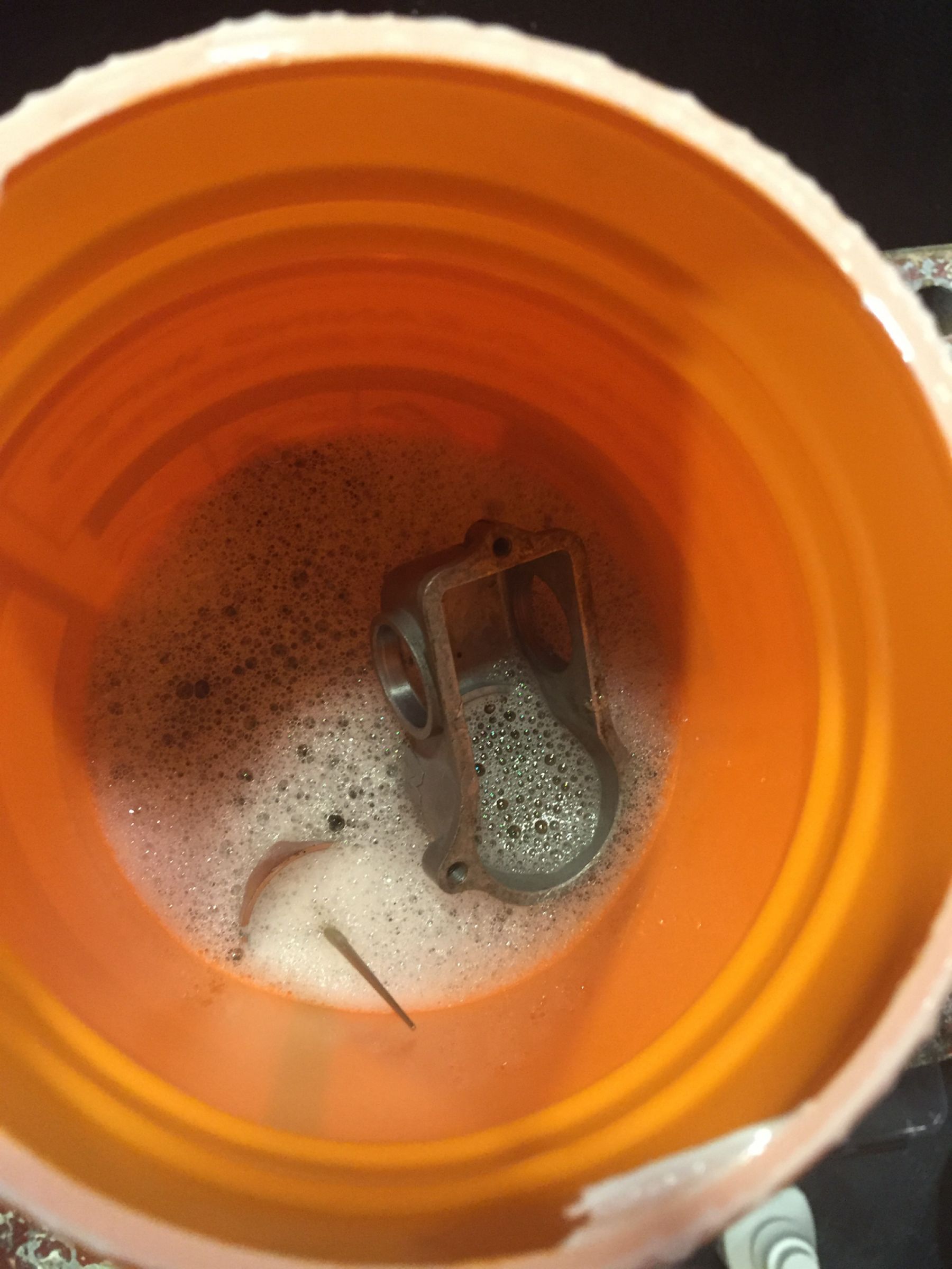

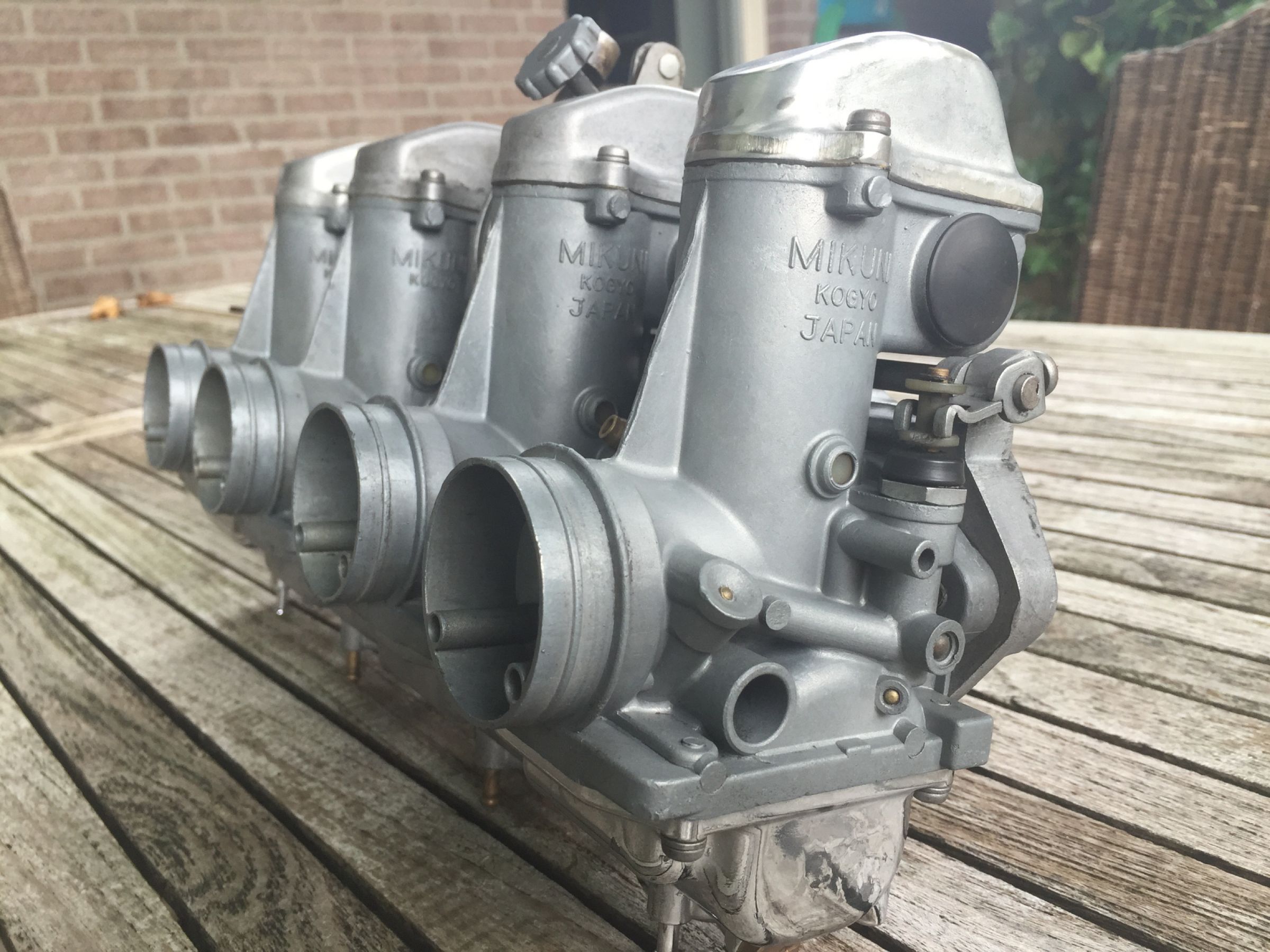

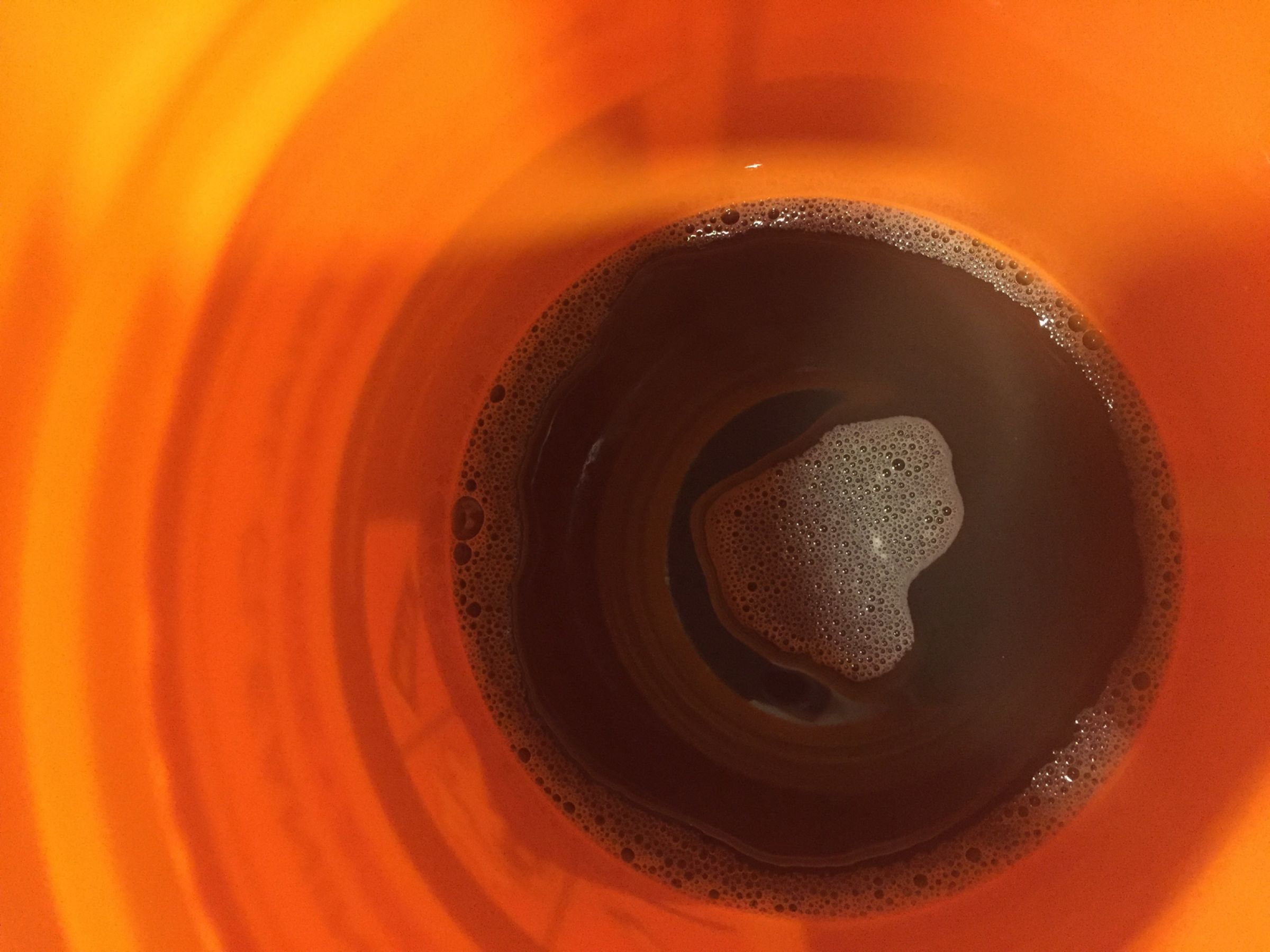

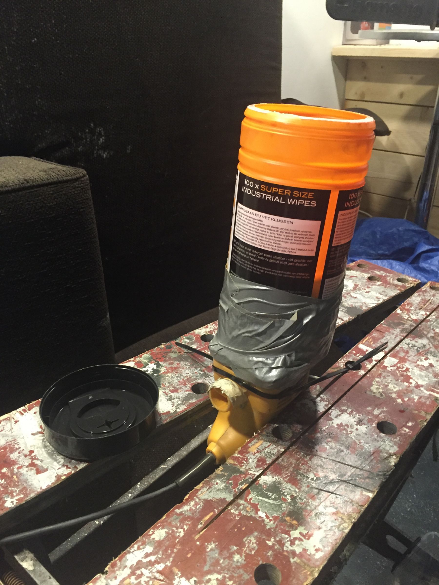

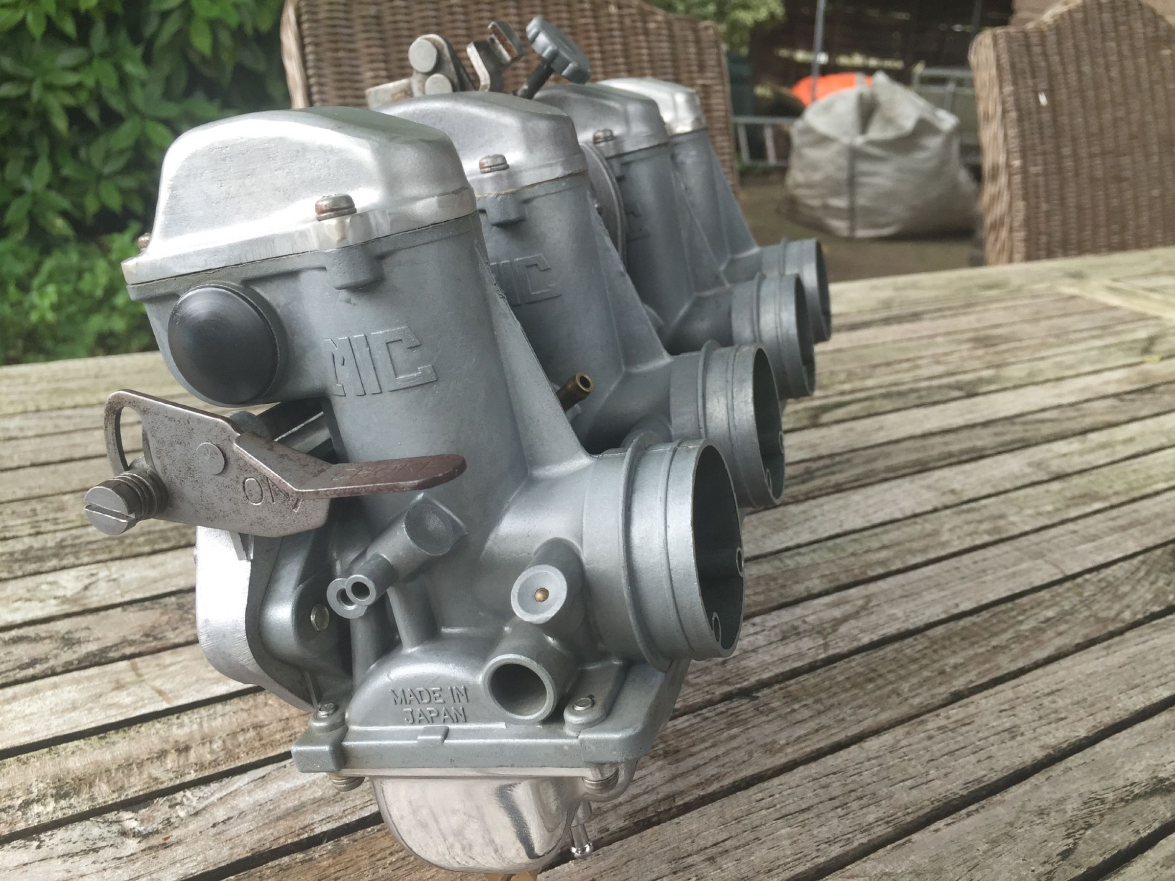

Cleaned the carbs:
This is why this forum is gold! found a "poor man's" ultrasonic cleaner from another member :lol:
Before blasting and ultrasonic:
After:

Wiers wrote: Chain and sprockets:
You can flip the rear sprocket around if it's flat on the inside and dished on the outside. It won't gain much but it will be something.

Thanks Doug,
Will look into it tonight, maybe saves me some milling.

Could not resist and went to the shed to take a look at my rear sprocket.
And yes if I flip it, it will give me another 1,5 mm.
Maybe that will be enough but than I wil have a not so shiny side visible and looks are important :laugh:

Its easier to let a machine shave 2mm of than destroy my elbow on some polish and a cloth :S

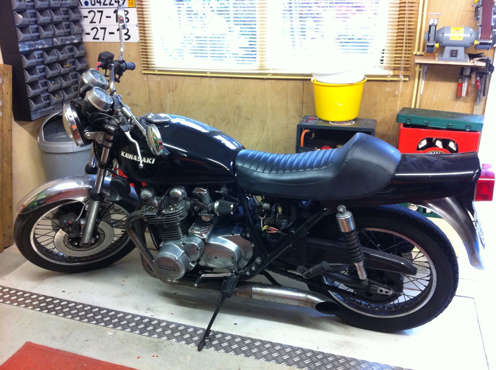

Any plans with the old seat ?
