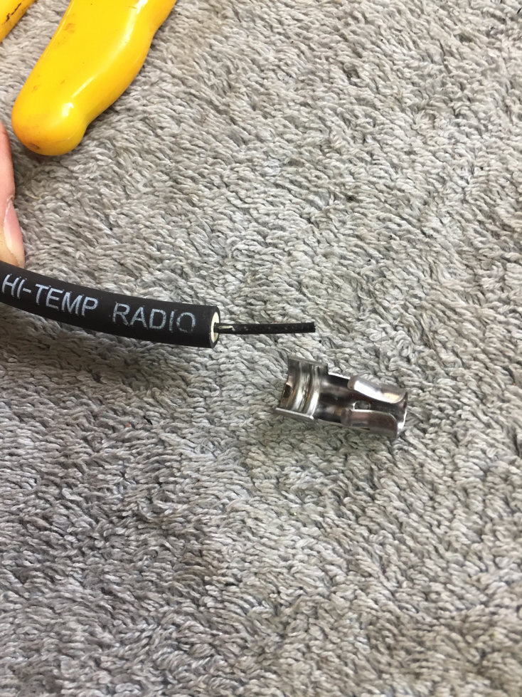

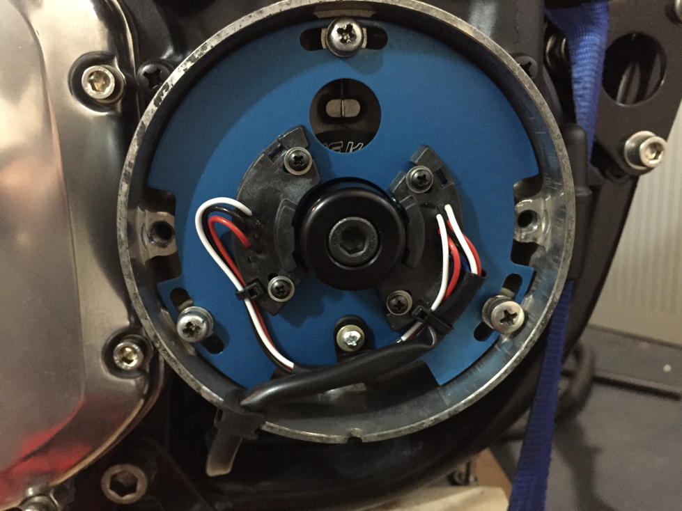

Started on the Dyna.
Hard to find some decent Manual with pictures for installing on a Kawasaki.
Problem with stripping the wires from spark plugs to the coils, I have the high suppression wires and don't know how far to strip them.
There is no metal inner core so I stripped them back to the black stuff and folded that backwards in the metal clip.
Anyone have experience with these wires?
Eric

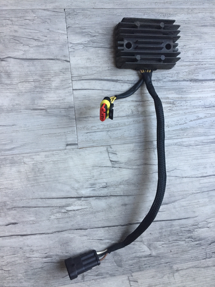

Another question.
I have this rectifier I believe is form A Kawasaki Er5 (same as the wiring loom I am using now)
It has the numbers SH230-12 0,3 on it.
The cables which I made new connectors on where a little bit corroded but the units looks ok.
The questions are:
1. can I use this on a Z1000? (it fits in the wiring loom I am using but it was intended for another generator)
2. is there a way to test it before I put it on the bike and possibly fry my Dyna kit?
thanks

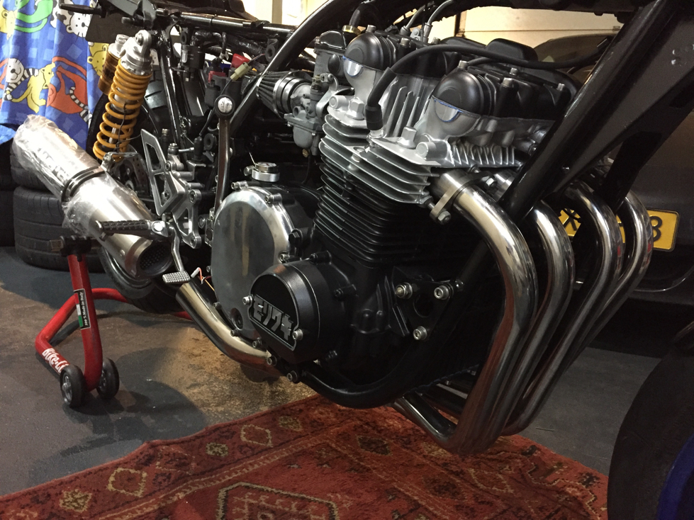

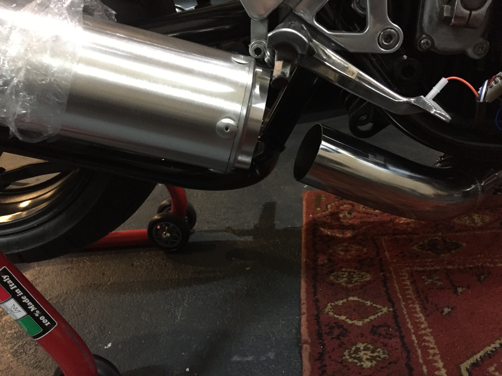

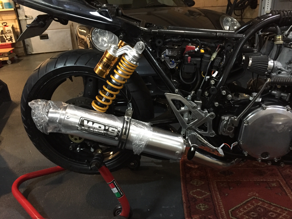

Ready for starting.....
Only missing one piece of tube.
Wiring loom is finished and everything is connected and working.
Find it hard to figure out how to connect the exhaust and fit a twisting piece of metal in the gap.

24 Jan 2017 09:52 - 24 Jan 2017 09:52
What about (To get the bike started) sliding the silencer forward a bit to connect it? Fit the Delkevic silencer for now? Bang out a connection from some old piece of thin steel ( Ventilation pipe/ an old paint tin/beer cans ) .
Youve come this far.Surely youre not going to be beaten by a few cm's of missing exhaust!!!!!

24 Jan 2017 13:01
I am going to start it anyhow :lol: with or without silencer.
I don't have a Delkevic silencer, only bought the headers.
Need to do some last cleaning of the tank and then its game on!!!!
- Posts: 7442
Re: Dutch 1977 Z1000 Build
25 Jan 2017 06:55
No eBay APP ID and/or Cert ID defined in Kunena configurationdid you not get a mid pipe for the muffler you have?
if answer is "no".
do you know which bike that muffleho was intended to be used on?
if answer is "yes" search ebay for the midpipe to fit that bike and see if you can't find some thing you can adapt.
ie,
if answer is "no".
ie,
