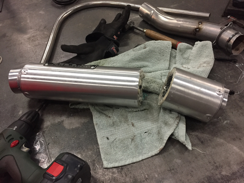

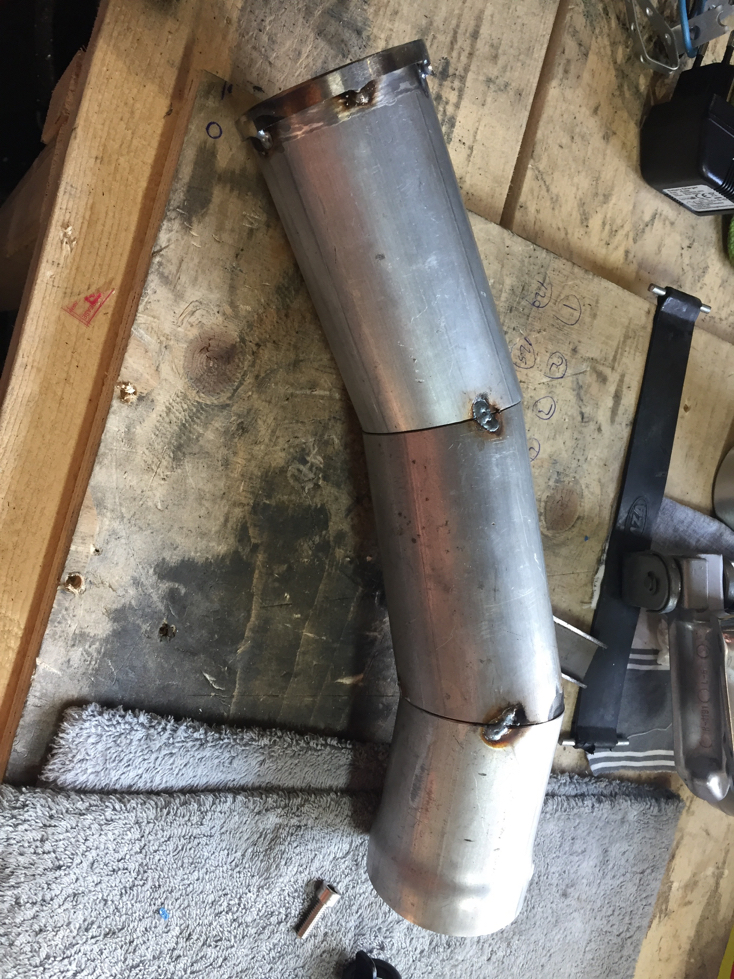

750 R1,
I just cut off what I was thinking what looks good, almost broke my friends saw due to the glass fiber inside clogging up.
For mounting you can just use the clamp and the ring/gasket type of thing.
If you tighten the clamp the ring will expand and seal of the exhaust.
This only works if you have a snug fit with both pipes, mine did not.
I had to enlarge the muffler intake and coupling to the size of my pipe (63mm).
Then I welded a ring i made about 2 inch down the pipe which holds everything together.
Here you can see the ring still at the end but I moved it about 3cm inward.
(don't forget to place the ring with the 3 holes before you weld something like I did :S )
I found a picture with how it is now, top right corner.

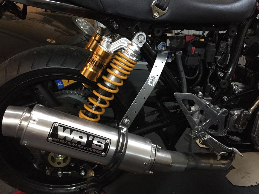

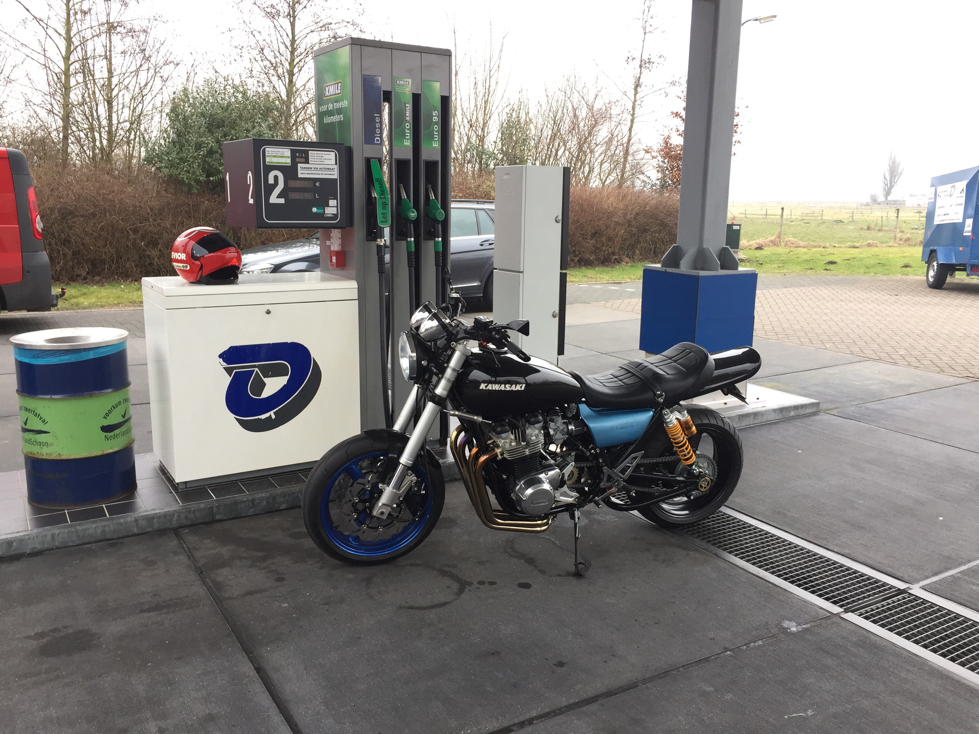

First ride in 12 years for me and 3 years for this bike!
First I made a temporary bracket for the exhaust.
The fact that it is freezing and started to snow lightly did not stop me from my first ride in a long time.
The bike handles well (okay I did not past 45mph :lol: ).
The brakes are working and I did not have any problems (yet) with ground clearance.
Even on the speed bumps.
This saves me a lot of work on fork extension.
So on the positive:
Handling
Brakes
Electrical
Clutch
Sound :laugh:
On the negative:
Could not rev up full.(looks like it is starving and the fuel filters are not filling up fast enough)
When I stop nr3 carb is pissing fuel trough its overflow hose (float bowl??)
Some rattling form parts which I have to tighten or modify.
And strange leaking from the Body breather ( the Chinese hose has to be replaced) but it looks like a sort of foam.
But the bad part is still the oil leak from the head gasket.
Went by the Kawa dealer and if I have it fixed by him it cost me a lot of money.
He charges $200 for the gasket and O ring alone :sick:
So it is doing it myself and take a change of messing it up or find a fellow biker who can do it for me.
Eric

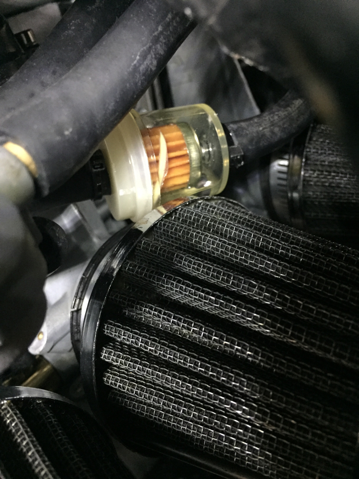

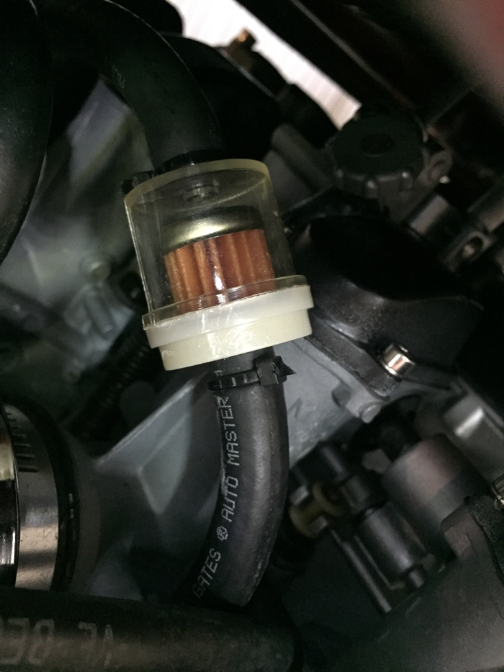

Took the carbs of and found that in nr3 one of the floaty things was bend upwards.
Bend it back equal with the other one and no more overflow:)
Did a few more test rides but same problem with "fuel starvation"?
Looked at my fuel filters and this is how it looks.
Not much fuel in there, also slow flow(more dripping)
If I take the tank of and open the petcock fuel streams out fast enough.
Before next ride I will put back old main jets(the plastic ones) and see with that does.
Also exhaust is very open, no DB killer and not welded on the joints.
So I will put in a DB killer to try and compensate for all the leaks in the exhaust department.
Now it is waiting for the weather to clear up and do some cosmetic stuff.

Check to see if the gas cap vent is clear.
- davido
- Posts: 1602
- Thanks: 304
Re: Dutch 1977 Z1000 Build
19 Feb 2017 09:19
What Steve says.Plus check the fuel tap and make sure thats ok. Also,try a bigger fuel filter and see how that goes,the one in the photo looks quite small( and Is it the right way around?).Another thing to think about,how dirty is the filter? If its clean (and you have been running the bike) then do you really need it??
