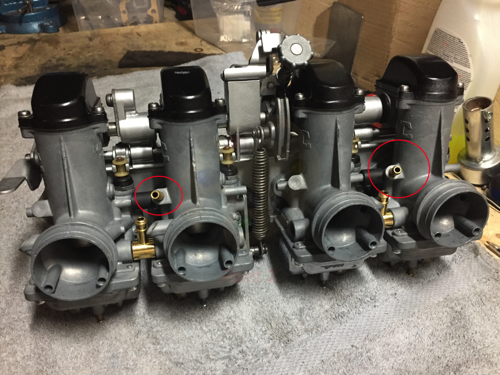

Alther question...
What are these for? I have short tubes on them but not connected to anything.
Eric

Hello Wiers
These are the air vents for the float bowls, don't block them.
Put some fuel lines on them and route them under your seat or side covers.
