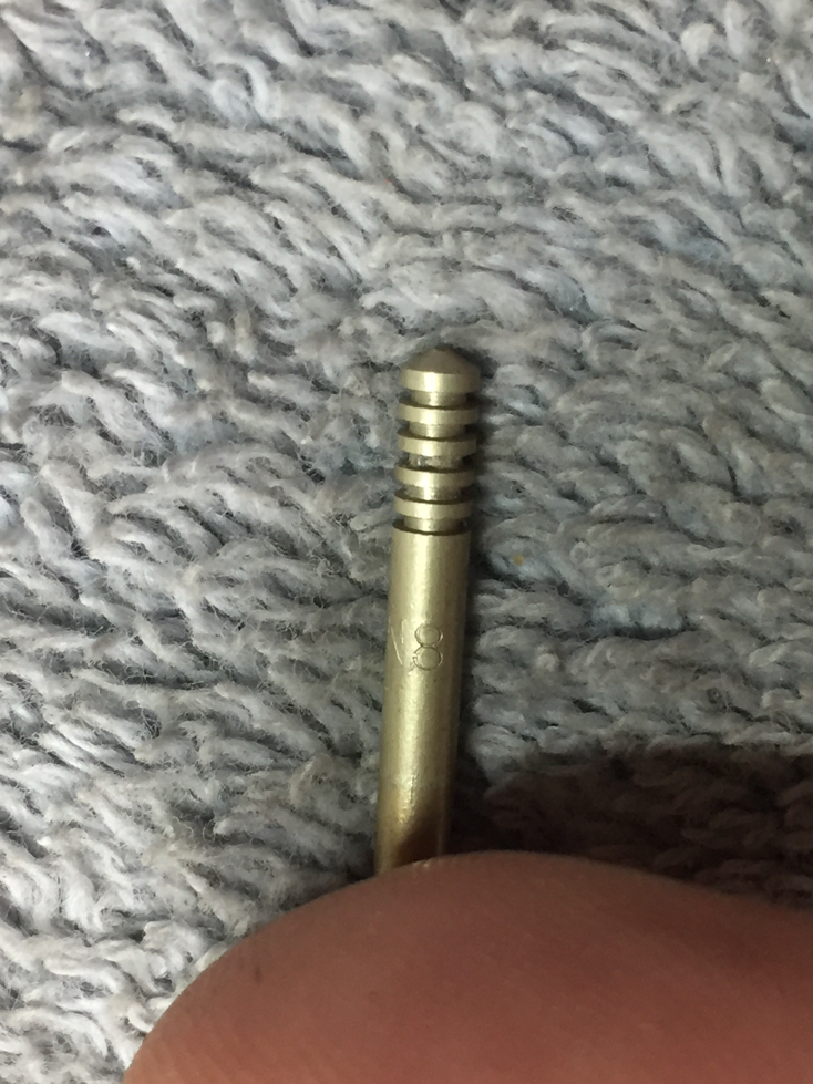

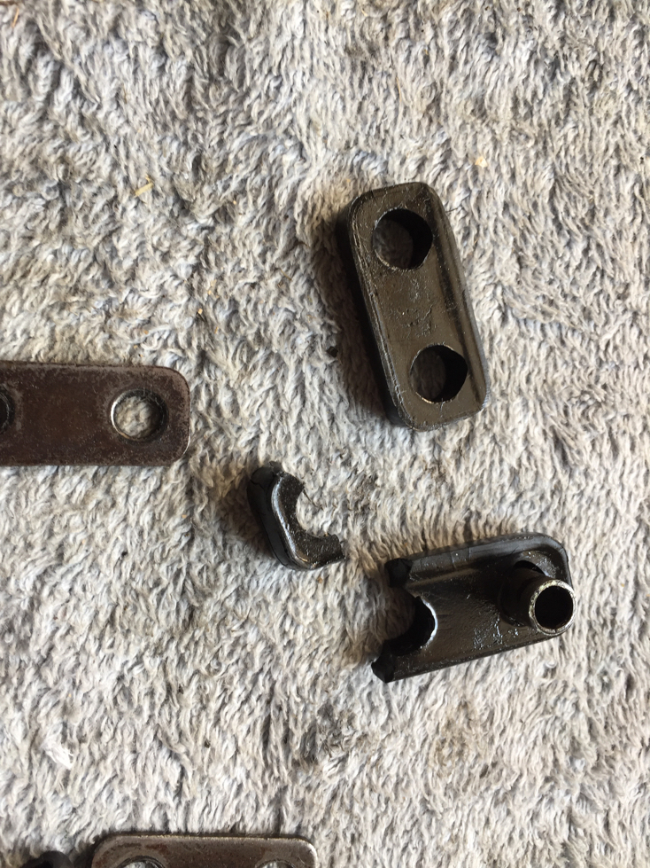

Took the carbs apart...again :pinch:
Found this..
Clip loose from nr4 and from both nr 3 and 4carb, position 3 from the needle worn out so the clip did not stay in anymore.
Put them all 1 lower/richer and hope this solves my problem.
It will be a couple of weeks before I know for sure.

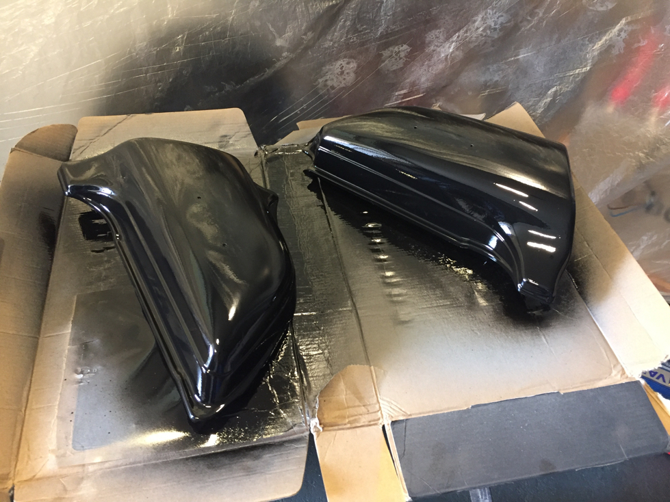

In the meantime some small jobs like painting the front wheel black and tiding up the wiring loom.

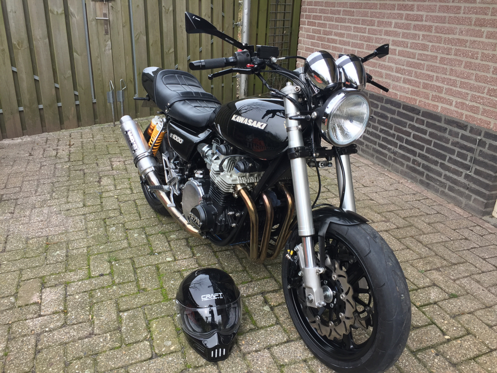

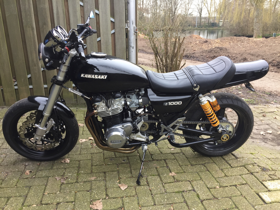

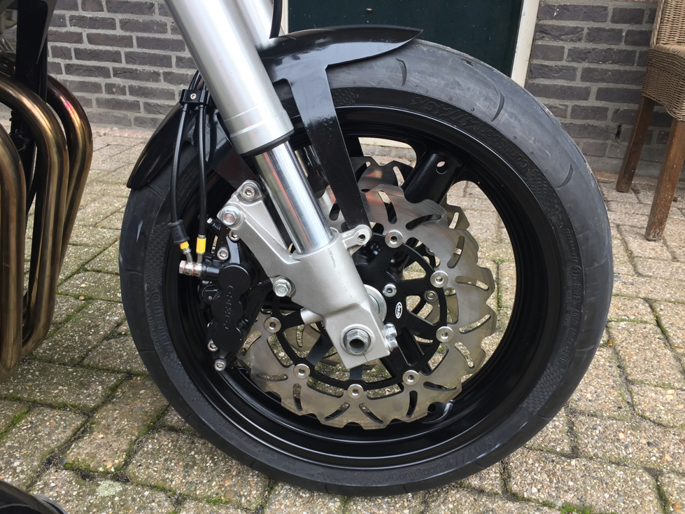

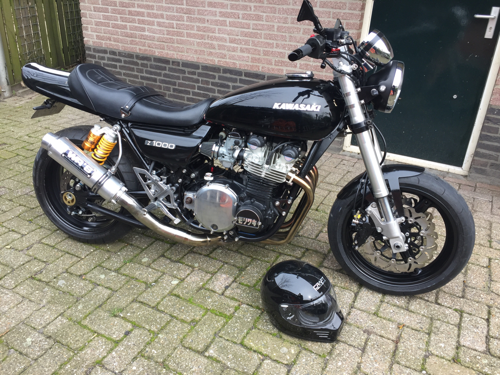

Almost done with part 1
(Riding it this summered finding out what to improve)
Part 2 will be taking it apart next winter for powder coating and painting.
Only thing I need to fix first is head gasket but could not resist putting it together for a test drive
Old Bike new helmet
I am happy now it is all black
Old Bike new helmet

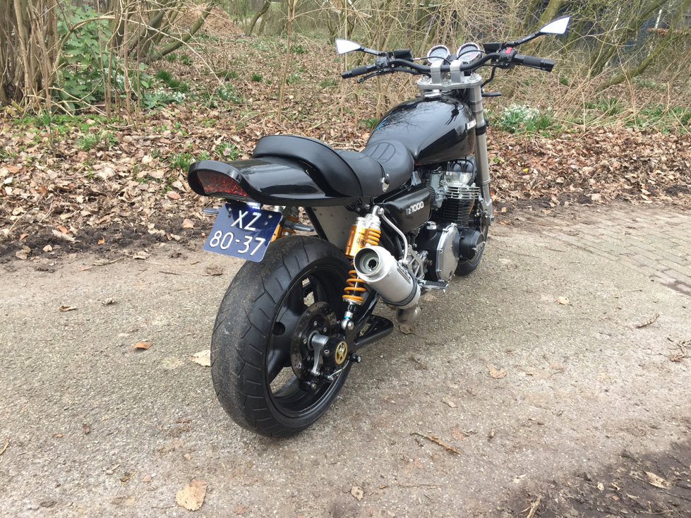

- Wiers
- Posts: 256
- Thanks: 28
Re: Dutch 1977 Z1000 Build
11 Mar 2017 07:41

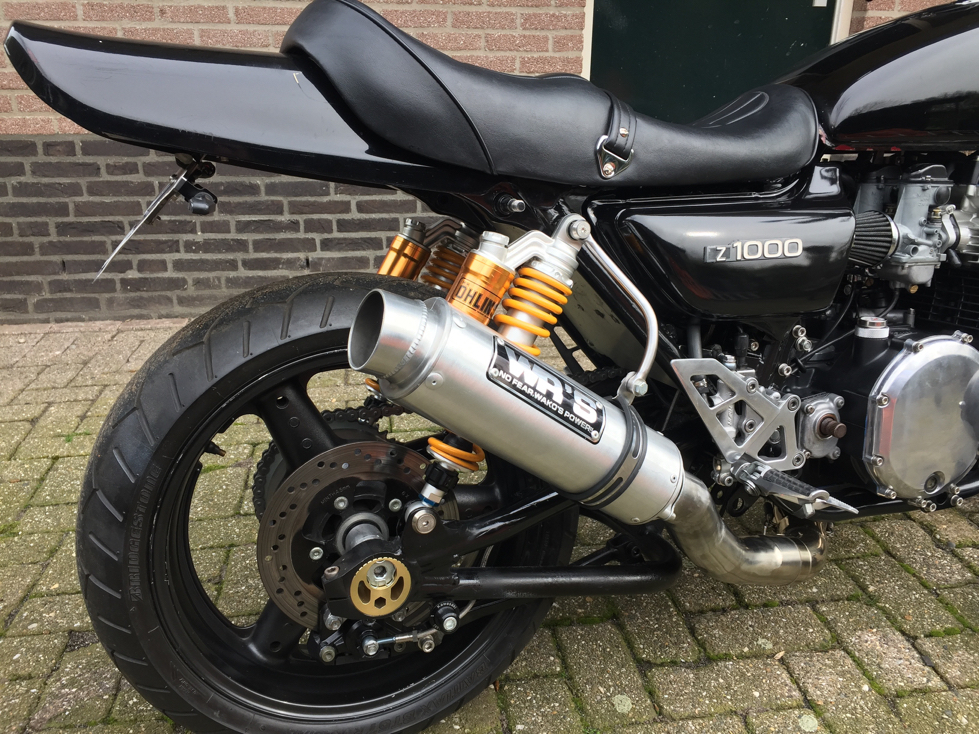

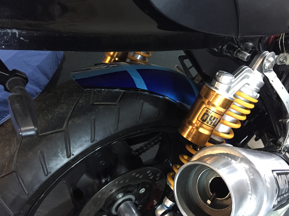

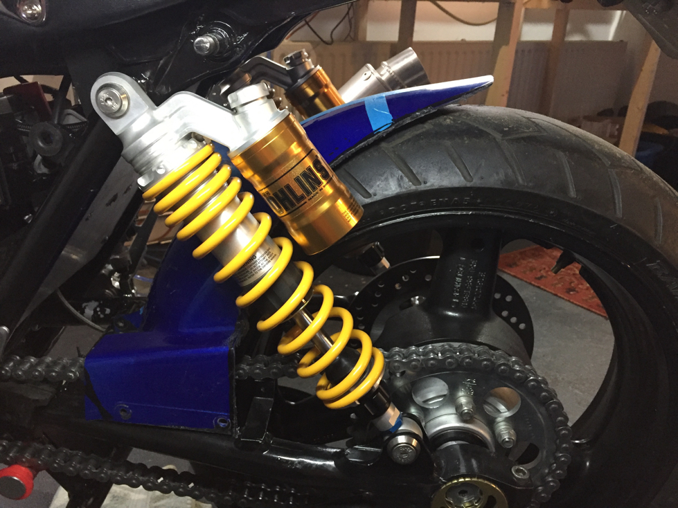

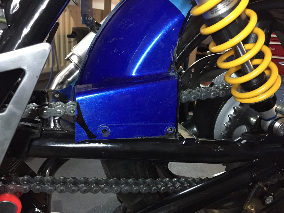

And another one.
Only thing missing is the hugger because I still have to make the brackets for it.
Test drive went great.
Placing the needle one size down almost solved the problem, a light stutter around 4000 rpm but everything else is super
I have to be careful with all the new fabrications but until now it feels very stable.
Some strange rattles from which one is the chain hitting the rear fender.
Also measured the ride hight and now figuring out how to setup the Ohlings and front suspension.
Eric

I really like how your bike has turned out, and to think this is only "part 1"... Can't wait for part 2.
Joe

super job.....looks great

Very nicely done Eric.
She looks great.

the bike turned out very nice!
thanks for posting,

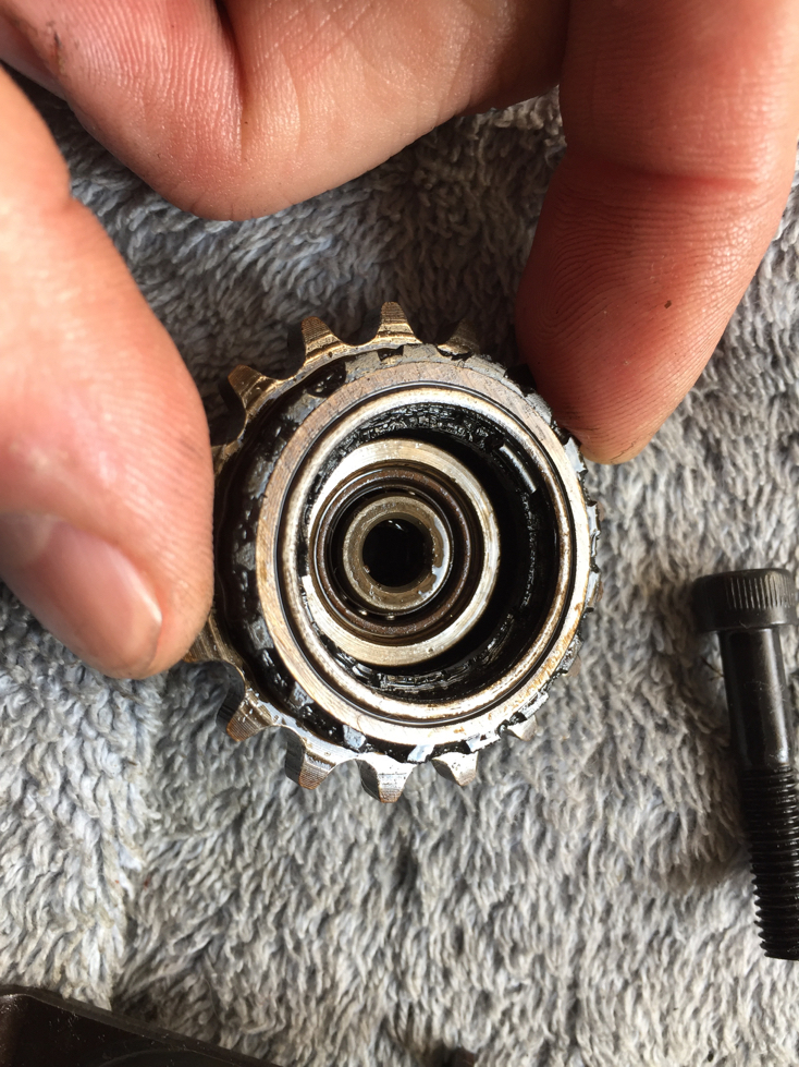

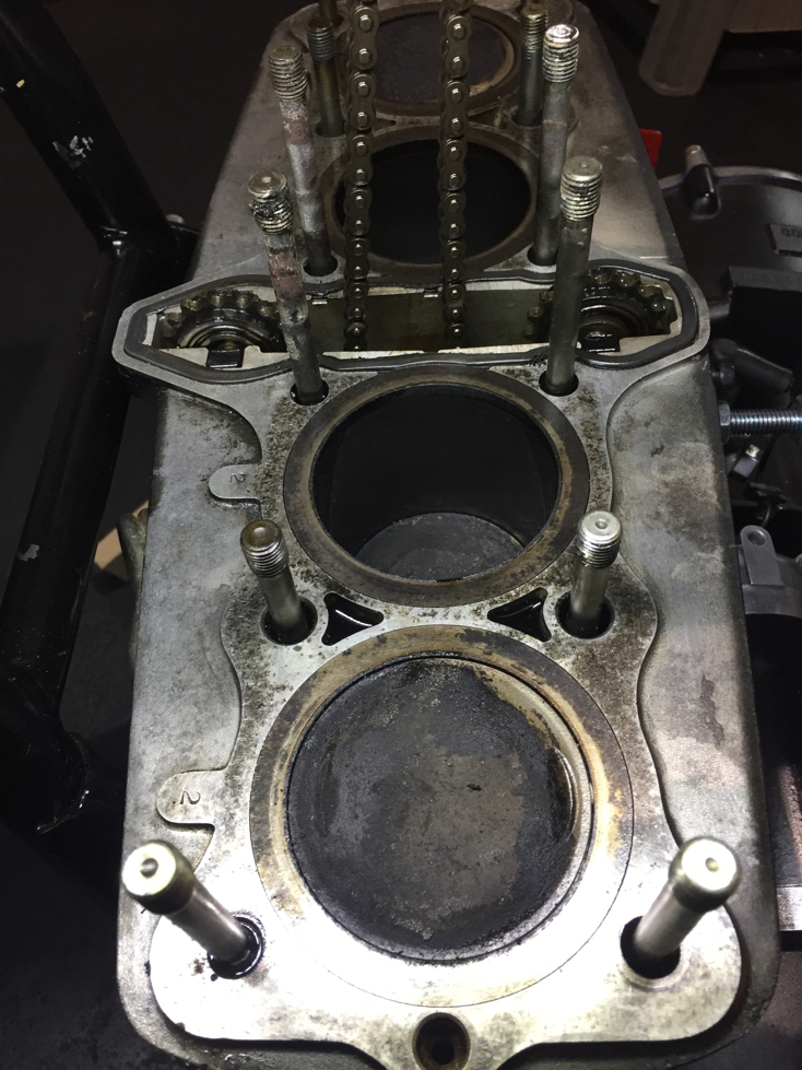

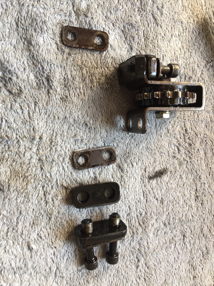

Never thought that I dare to do it but after encouragement from you guys I did take it apart..
No problems dismantling, no broken bolts or cracks in the cylinders.
Only thing worn are 3 small cam chain sprockets.
But these are the most expensive parts of the whole bike :pinch:
There are 2 types of replacements, the expensive non damping Liska and the insane expensive Kawasaki sprocket.
I am reading that the Liska are making a bit more noise.
Anyone has these installed and can confirm?
And also, are these 3 sprockets the same size?
Eric

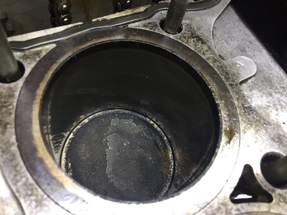

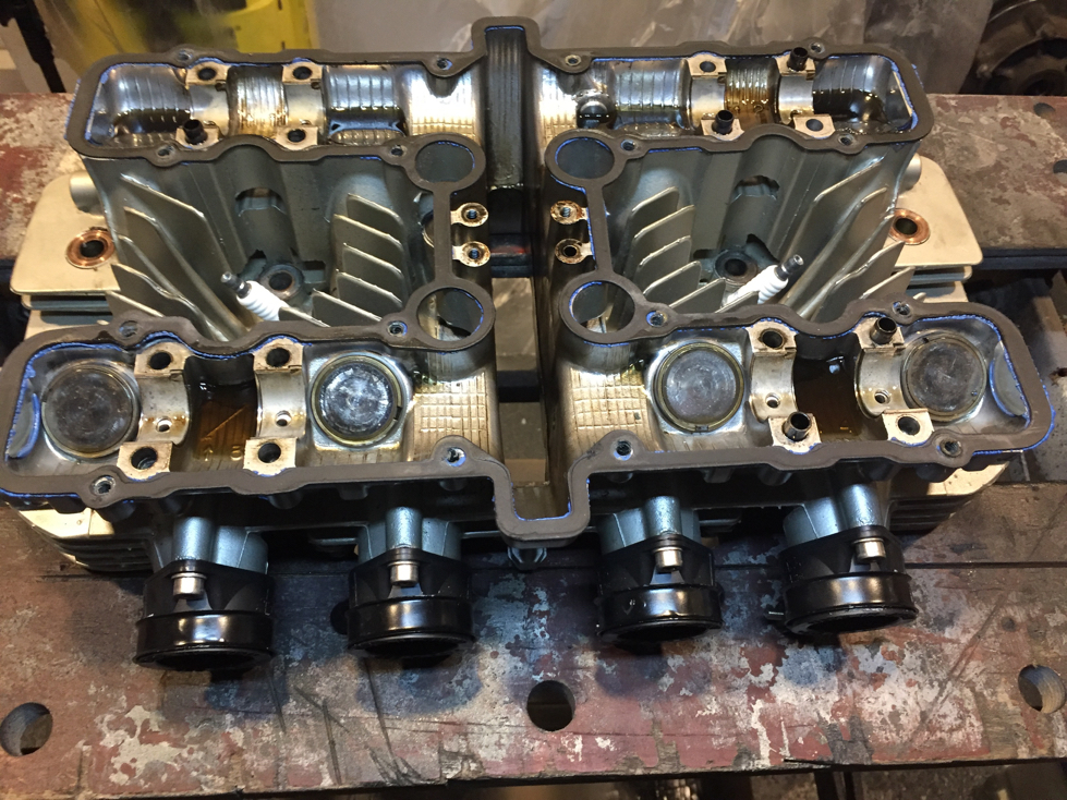

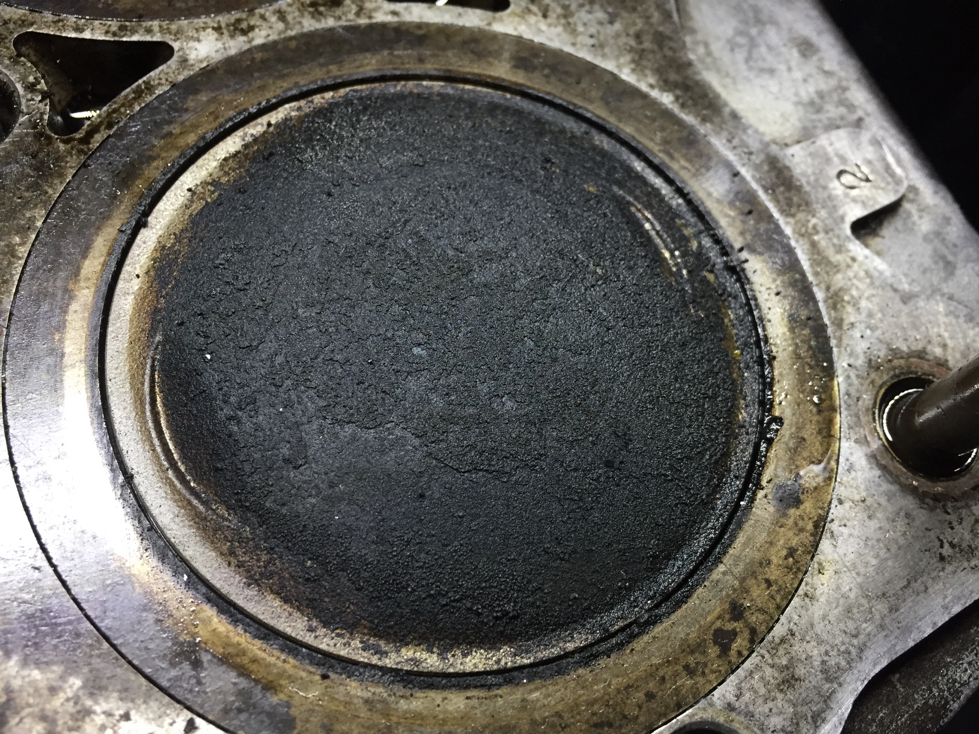

- Wiers
- Posts: 256
- Thanks: 28
24 Mar 2017 03:11 - 24 Mar 2017 03:15

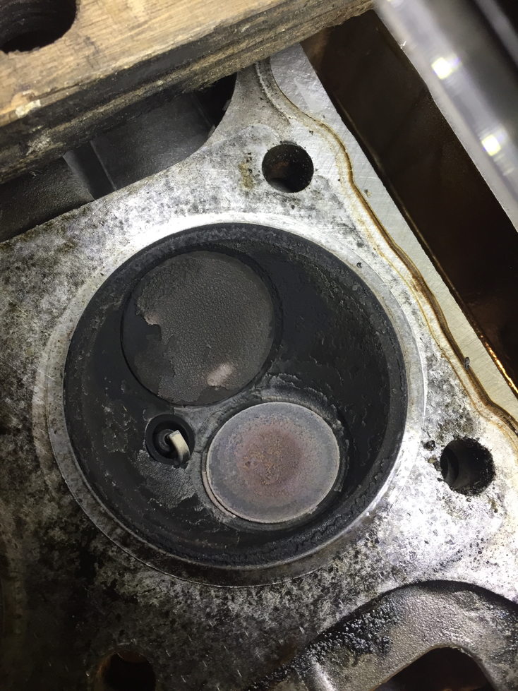

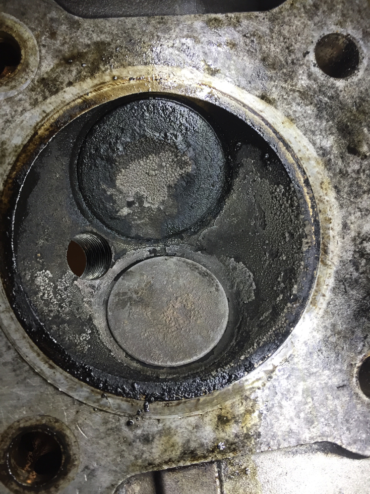

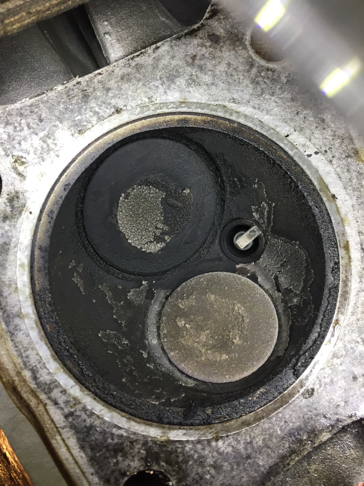

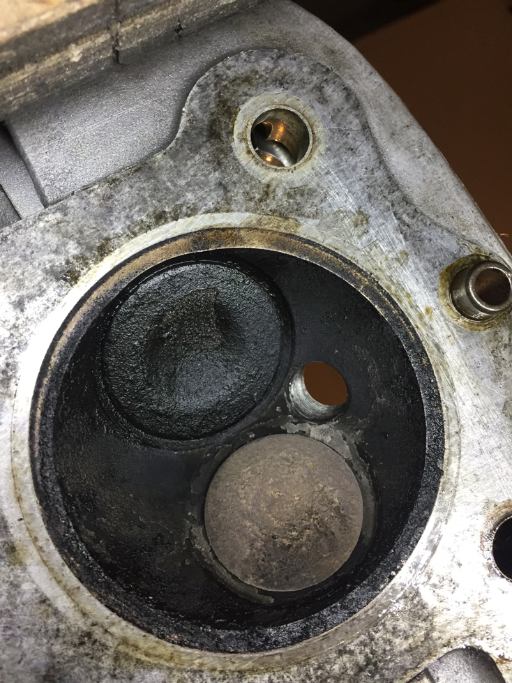

Is this looking okey?
Just some cleaning up?
Nr1
Nr2
Nr3
And Nr4
Did a simple valve clearance check (smallest feeler I have are 0.05 and 0.1mm but these are the tolerances according the manual)
Nr1, 3 and 4 are within these tolerances but in Nr 2 exhaust I could not put in the 0.05mm and the intake was wider than 0.1mm.
I will buy better tools and when everything is put back together I will measure again.
Eric
