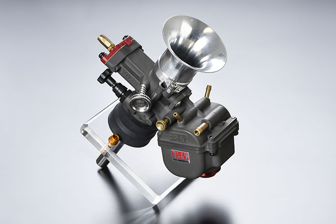

Nice article about Yoshimura, maybe old news for some of you but very interesting.
www.bikebros.co.jp/vb/sports/sfeat/yoshimura-carburetor-en/

Very cool! i see they make a set of those carps for the z1. wonder how much money? yoshi isnt cheap

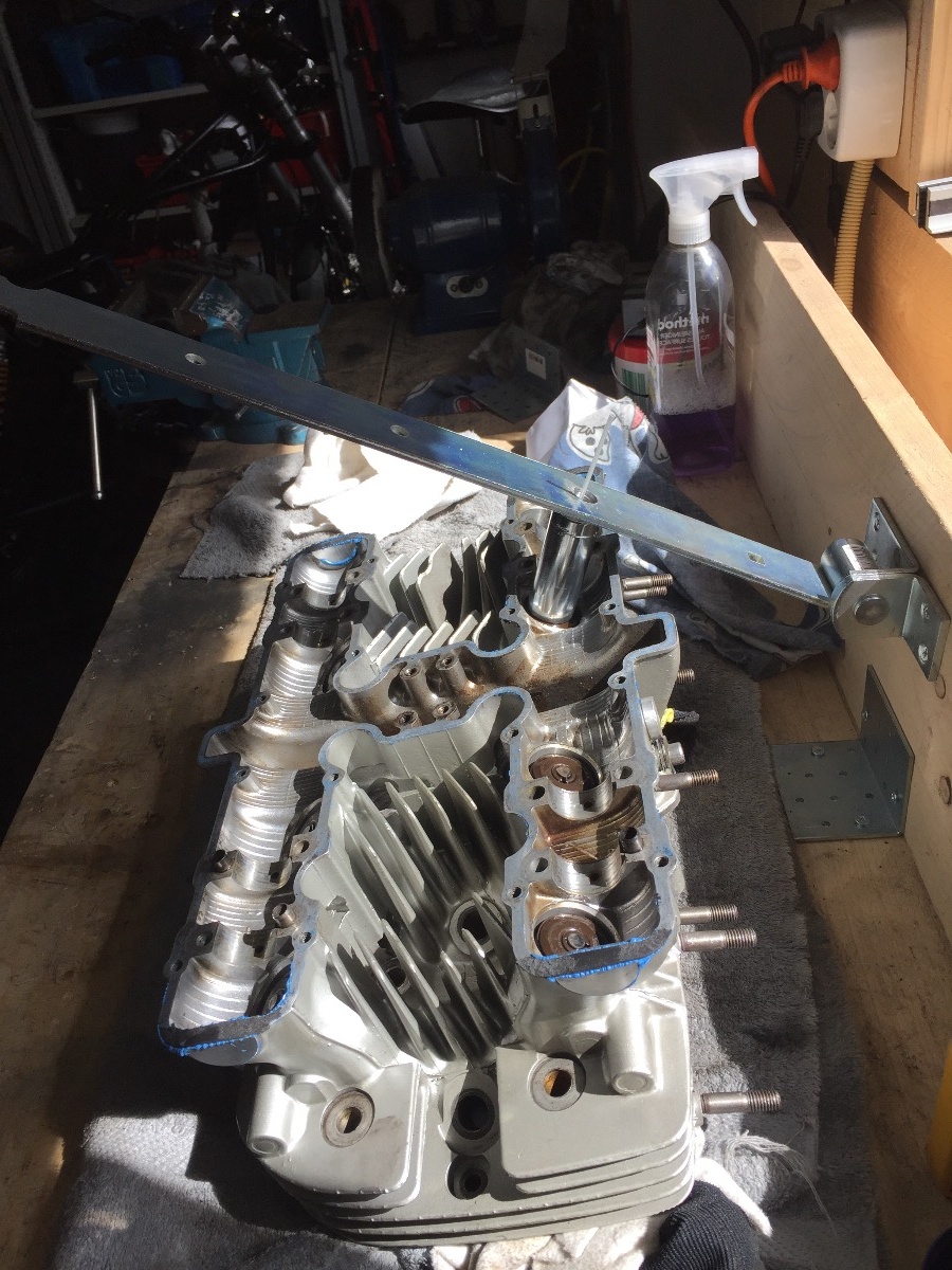

Some small steps due to lack of time.
Removed the valves and seals and cleaned everything up.
Did not have the right tools so made my own from a door hinge :lol:
All masked with tape and ready for fresh VHT paint job tomorrow.
Eric

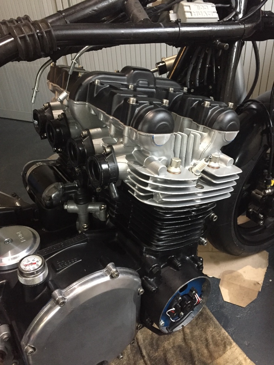

YES||||
An oil leak free Z1000
After the first test-drive I had some leaks around the base seal but after retorquing the head bolts I am safe.
The ride went great but 5 minutes after taking these pictures I ran into trouble.
Hortin and snorting and no full power
After fiddling around with the carbs and petcock I found out by accident (touching the exhaust) that nr 1 and 4 where a lot colder than 2 and 3.
So that told me that should be a the coil and after taking of the tank for the 30th time I found a wire disconnected.
Reattached it and after some flames out of the exhaust from the unburned fuel there, it runs like a charm again.
Attachment not found

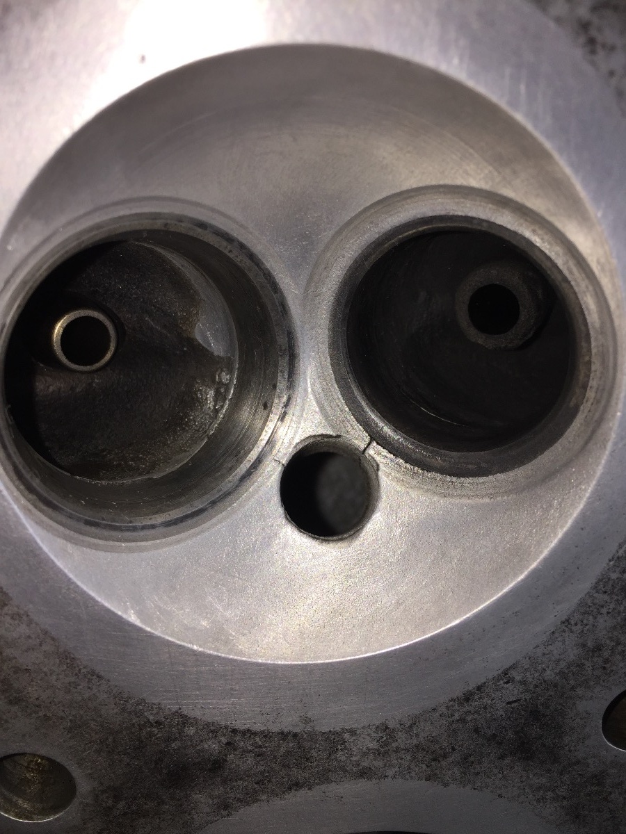

Thanks Vic,
Starting driving in small circels around the block and increasing distance with increasing reliability
Just bought a new head from a fellow in England to have a backup for mine.
If the cracks are getting any larger I will replace it but for the moment all OK.
Eric
