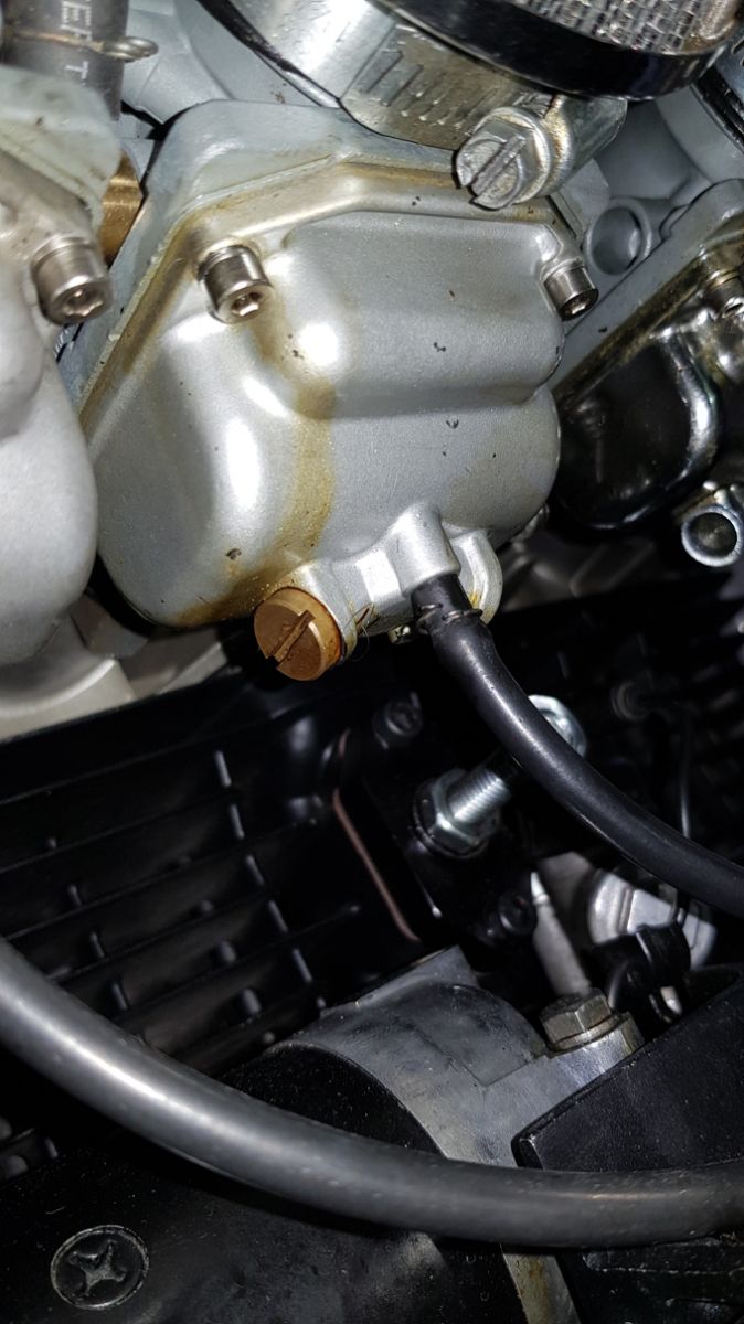

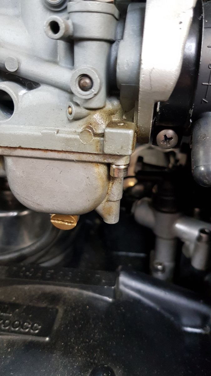

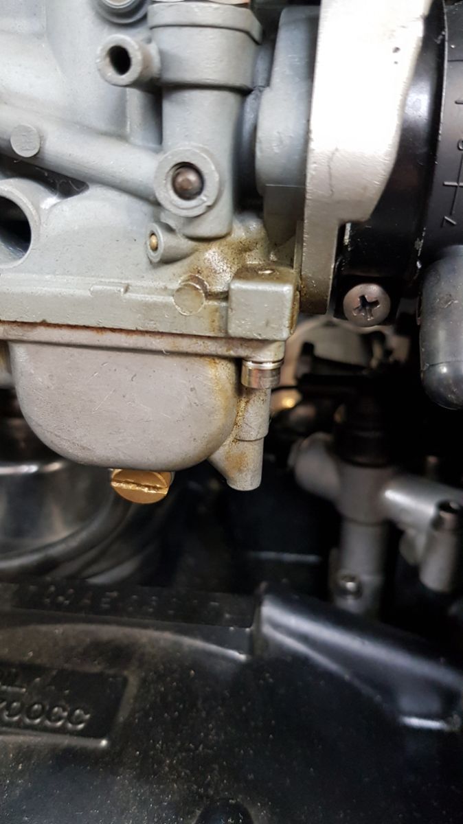

Here are some pictures of the oily substance on the carbs.
If it was fuel it should evaporite, but how can oil come out of the carbs? Via the intake?
Anyone seen this before?
Hope it makes me more productive :lol:

06 Mar 2018 03:42 - 06 Mar 2018 04:03Wiers wrote:
If it was fuel it should evaporate, but how can oil come out of the carbs? Via the intake?
It's the fuel.
Probably a light weep from the float bowl gasket.
The gasket material can act as a wick and the fuel gets drawn through.
The residue always happens to varying degrees as the wet fuel attracts dirt from the air and also some additives in the fuel do not evaporate.
It's got worse since the ethanol content has gone up which also gums up jets etc if left stood a long time.
Also fuel can get blown back from the venturi into those filters , mix with the airboure muck they have caught which can then drip out of the bottom.
This then gets pulled onto the carbs and back of the barrels as there is a low pressure area behind the engine.
This is the same principle which causes the back of vehicles to get more filthy than the front and how slipstreaming works .

Thanks for the explanation Zed,
So I just clean it of and it should be good if you just ride it more often

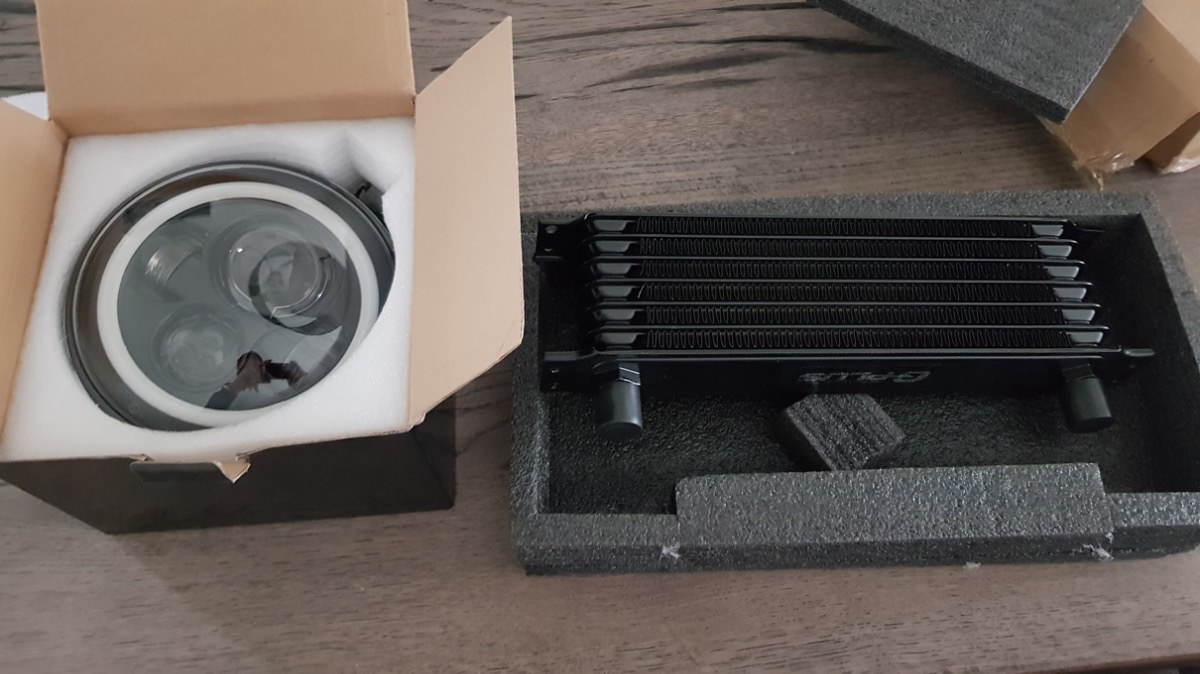

Look what the mailman brought today
A new headlight (Led) and this time the right size of cooler.
Hope the light will fit because I ordered it for it looks :whistle:
Will keep it in mind when filling it with oil.

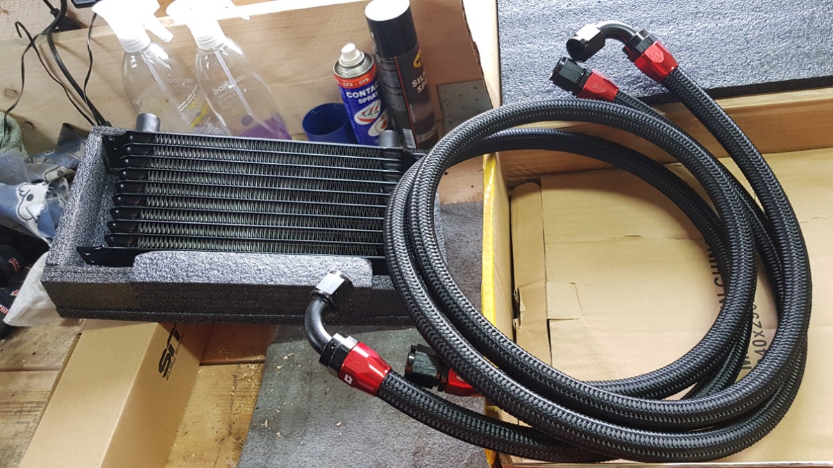

Working on the oil cooler tomorrow.
Just ordered an oil cooler fitting from Z1 enterprise.
Already have a set: oil cooler and lines, but the problem is that the lines are 10AN and the connection on the fitting from Z1 enterprise is 1/4NPT.
And there are hardly any connections from 1/4NPT to 10AN.
So it will be drilling and tapping I guess.
I think the oil cooler I bought was actually for a car :laugh:
