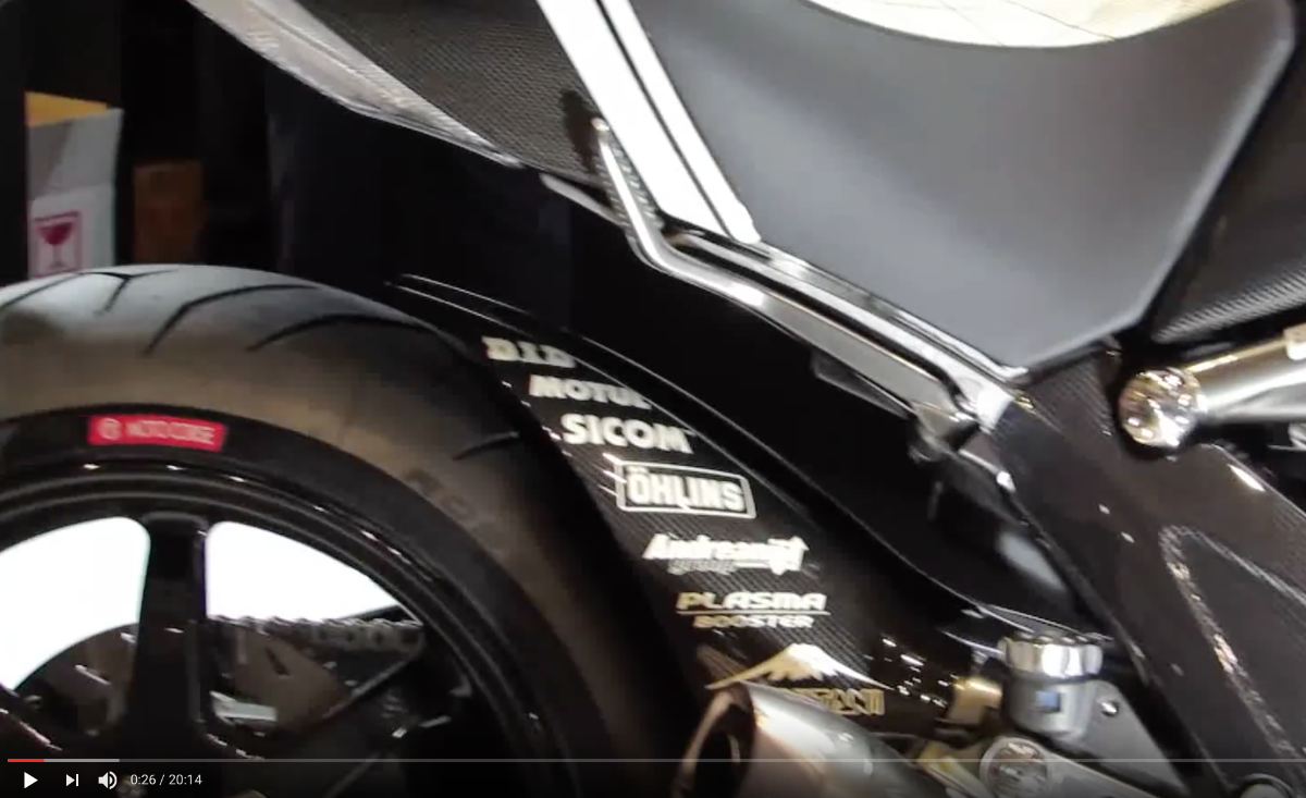

Yes the taillight is from a CBR600RR.
I believe I bought it on ALIExpresss, it has integrated turn lights but I could not get it to work and they are also not allowed in Holland.
The fender is From a ZXR1100. same as my swingarm so some of my mounting points line up.
This is what gave me the idea, I like to cut it like this.
Not to bulky but large enough to catch the most dirt.
Eric
Eric

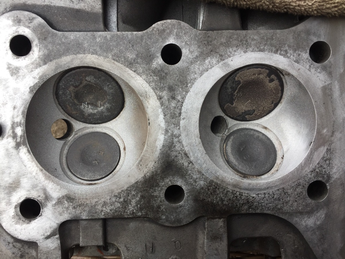

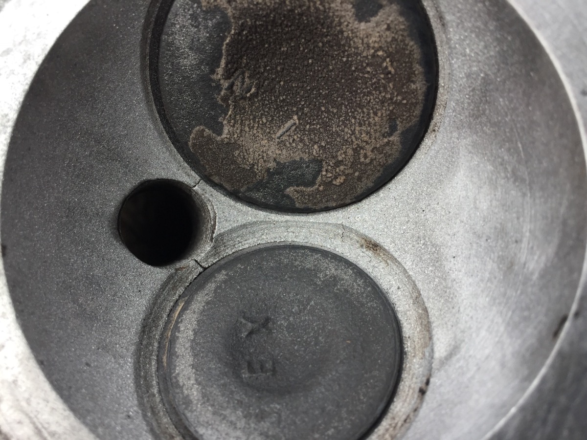

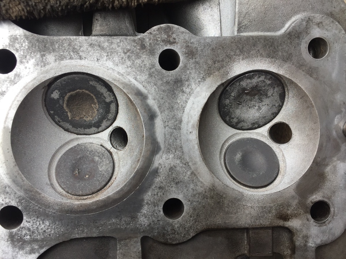

Disaster!!!!
Tried to clean the carbon with my dremel and some copper wheels but did not work.
So then used my grid blaster and that did the work and made me happy for a few seconds untill I found out my head is cracked.
On cylinder 2 and 3 betweeen the valves and the spark plug hole.
I am not sure what to do right now.
Put it back together and drive it untill I find a new head and hope it does not explode between my leggs....
Is it reparable (don't think so).
Try to find another head for a 40 year old bike.
Eric

That head will be fine , Read this
kzrider.com/forum/2-engine/558556-head-c...l=component&type=raw
www.kzzone.com/
The following user(s) said Thank You: GPz550D1, Wiers

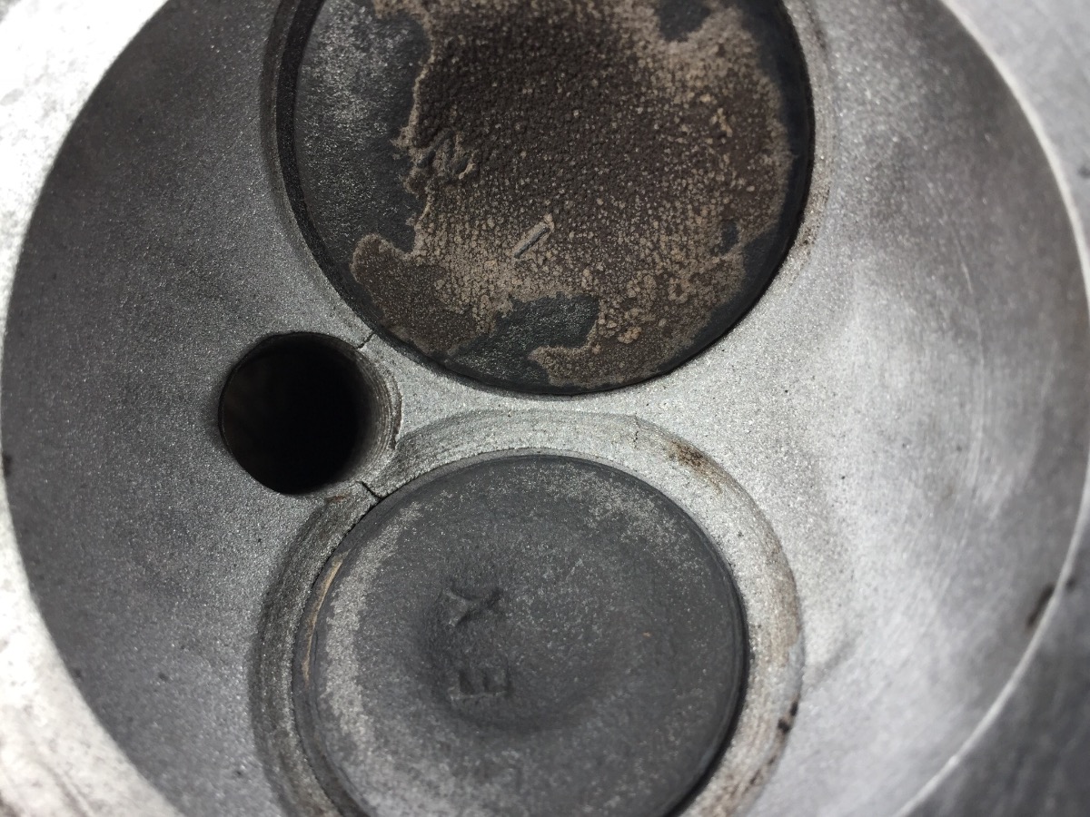

David thanks for the links, I will try to find a replacement.
Peter, I read the link you send me and that gave me some hope.
I could not see the pictures of the first guy but the other one (not the complete crack head :lol: ) had small cracks.
Mine are all the way trough and on 2 sides.
I am taking the head apart this week and hopefully it is not a complete write-off :pinch:
I picked up package from Z1 and when I got home there where 2 more packages which includes a new head gasket ( a steel one from Wiseco)
So, taking it apart do some valve pasta/sanding and build it up again before summer is over in Holland
Eric
