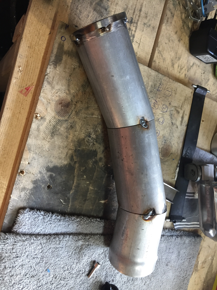

27 Jan 2017 10:00Wiers wrote: About the muffler.
I can make something at a friend of mine but than I won't have my bike with me for test fitting.
And when I am at my bike and it does not fit I don't have the tools to adjust it
Most stuff from Ali is for mopeds and scooters and the diameter is 54mm and my collector is 63,5mm.

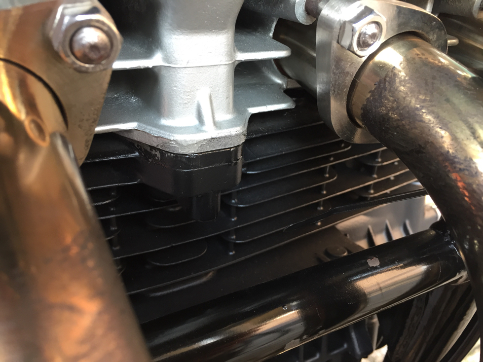

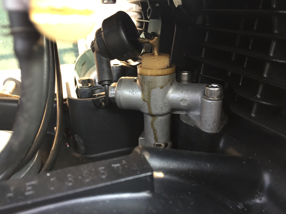

Also after starting I had some minor leaks :S
Head gasket, oil pressure switch and exit of generator cables.
The last 2 I can fix but the first one sucks.
One piece or two piece head gasket?

I do not know what kind of gasket it has, I only took of the valve gasket and replaced it with a new one plus liquid gasket.
Is there a way to stop the leakage without taking the heads of?
That would be great.

No, chances are it's a two piece head gasket. The O ring around the cam chain tunnel has a habit of cracking. I use a one piece fiber one. No more leaks.

Nice sound for sure. Beauty job. Try running it for a while to warm up a couple of times and then re-torque the head nuts as per the manual. Also, check your o-ring on the oil pressure switch as it may have cracked if old or re-used. Put a new fiber one in there with a light dab of grease if need be to stop the weeping.
Keep at it.

Try retorqueing the head ...lossen each head bolt at a time following the torque sequence and retorque them.

I put new oil rings under the oil pressure switch but I was able to tighten the top plastic part a little further so that should be oke.
Retorqueing the head bolts sounds like the a good and easy solution.
What is the best way? Bolt by bolt or loosen all bolts and retorque them all? I am afraid that If I break one of them I have to take the whole engine apart to fix it.
