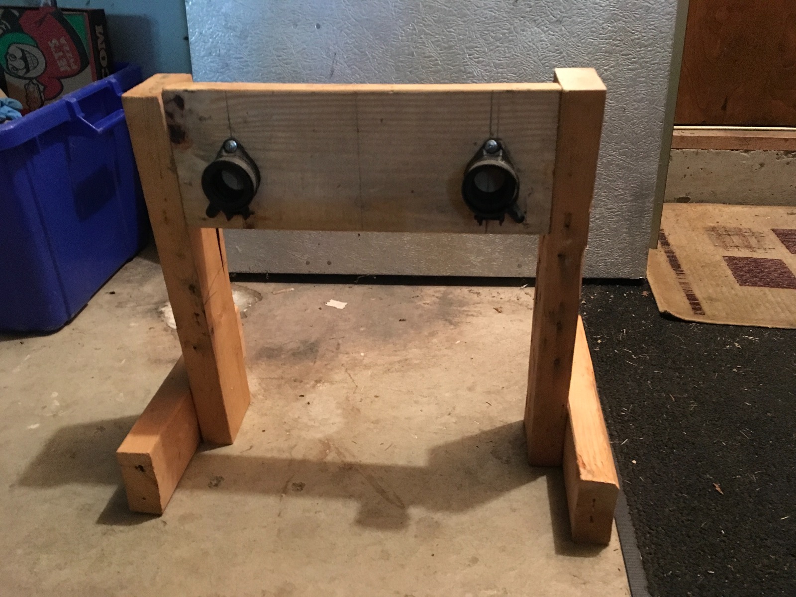

#815345
Made this today to hold them, waiting on the tube to get here hopefully today.

#815351
That should work but make sure it's level from front to back and from side to side. I built mine so that the carb throats are at eye level when I synch them.

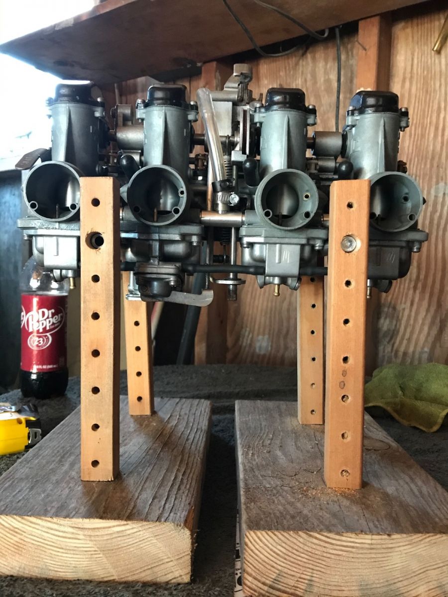

Here's mine. I use c-clamps and wood shims to level all directions and anchor to the bench.
Hardrock, do you use fuel to set floats. I did and it was a stinky job and my hands smelled like gas for days... What other fluid would work?
Not rying to hijack the thread, Just hopefully get a tip out to us rookies.

hardrockminer wrote: That should work but make sure it's level from front to back and from side to side. I built mine so that the carb throats are at eye level when I synch them.
I’m gonna keep an eye on the leveling as I go gotta pretty close know, the tube came today so maybe tomorrow I can get it done. But I think the the cross member they sit on are gonna be in the way of the tube on the inside carbs, gotta re think it.

Mikaw wrote: Here's mine. I use c-clamps and wood shims to level all directions and anchor to the bench.
That’s what I had in mind to build but no extra boots to hold the carbs, I thought bout instead of gas using rubbing alcohol with red food coloring but I ain’t sure if it will hurt the orings or not.

I think we need to be aware of the density of the alternate fluid. If not the same as gas it will affect the buoyancy and maybe not allow proper float adjustment.
I have another bank of carbs to do a float adjustment on and sure would like to use something beside gas again.
