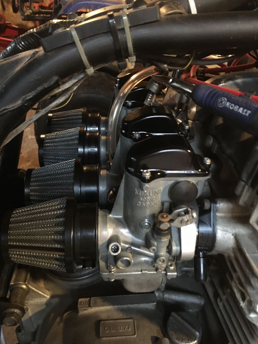

Ok guys, got the carbs clean in and out, reused main jet (120) pilot jet (17.5), new o rings gaskets and float valve seat and needle. So put them on the bike fired up fairly easy. My problem started when I tired to sync them, it was idling high so went to back on idle screw but it wasn’t even touching the throttle stop, so it idled down when I started adjusting each needle but then it turned into me chasing each cylinder. So I done something wrong or I missed a step so any help would be appreciated.

If the slide adjusters (sync screws) are adjusted so the slides are too far open the engine will race and the throttle stop won't be effective. You may need to go back and mechanically sync the slides lower in the carb bores.

Ok , bench sync, is there a certain cap I need to shoot for, I noticed the small cut out when the slides are all the way down, does it idle off that section?

I'm not sure exactly how far open to set the slides but lower than where you have them now would be a good starting point.

They should be set at about 0.5mm to 0.7mm open, including the little space on the bottom. I use a piece of 20 gauge copper wire to set mine. You can get the wire at any Home Depot in the picture hanging wire section.

Ok, do u put the wire next to the little notch or under it. I might have some of that wire laying around , I know I got fence wire and electrical wire in the garage.

I put the wire between the bottom of the venturi and the notch in the slide. Some people use 22 gauge wire. I use 20 gauge.
