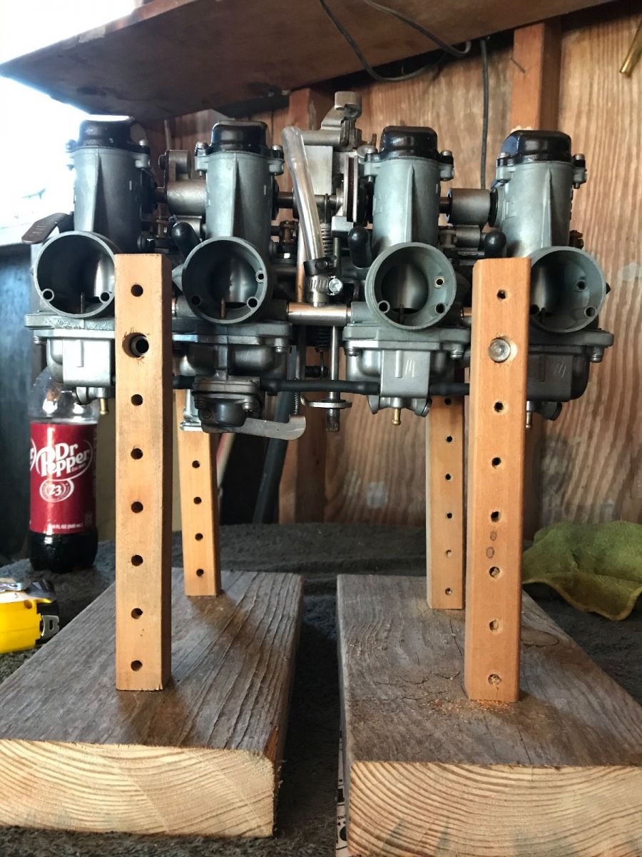

I just looked at the picture I posted on the stand, so I got 3 caps as of now one in between 1-2 and one on the left side of 3 and one in between 3-4. So is the one on the left of 3 for the petcock vacuum and the other two for the bowl vents?

Re: 28mm VM carbs
15 Dec 2019 19:43TexasKZ wrote: There should be 2 or 4 bowl vents, and four vacuum ports.
Well there is a piece of rubber hose connecting 1-2 and 3-4 and a spout that I got plugged that might be the bowl vents and the one on the left of number 3 is for a petcock so maybe I should left that one and uncap the other 2

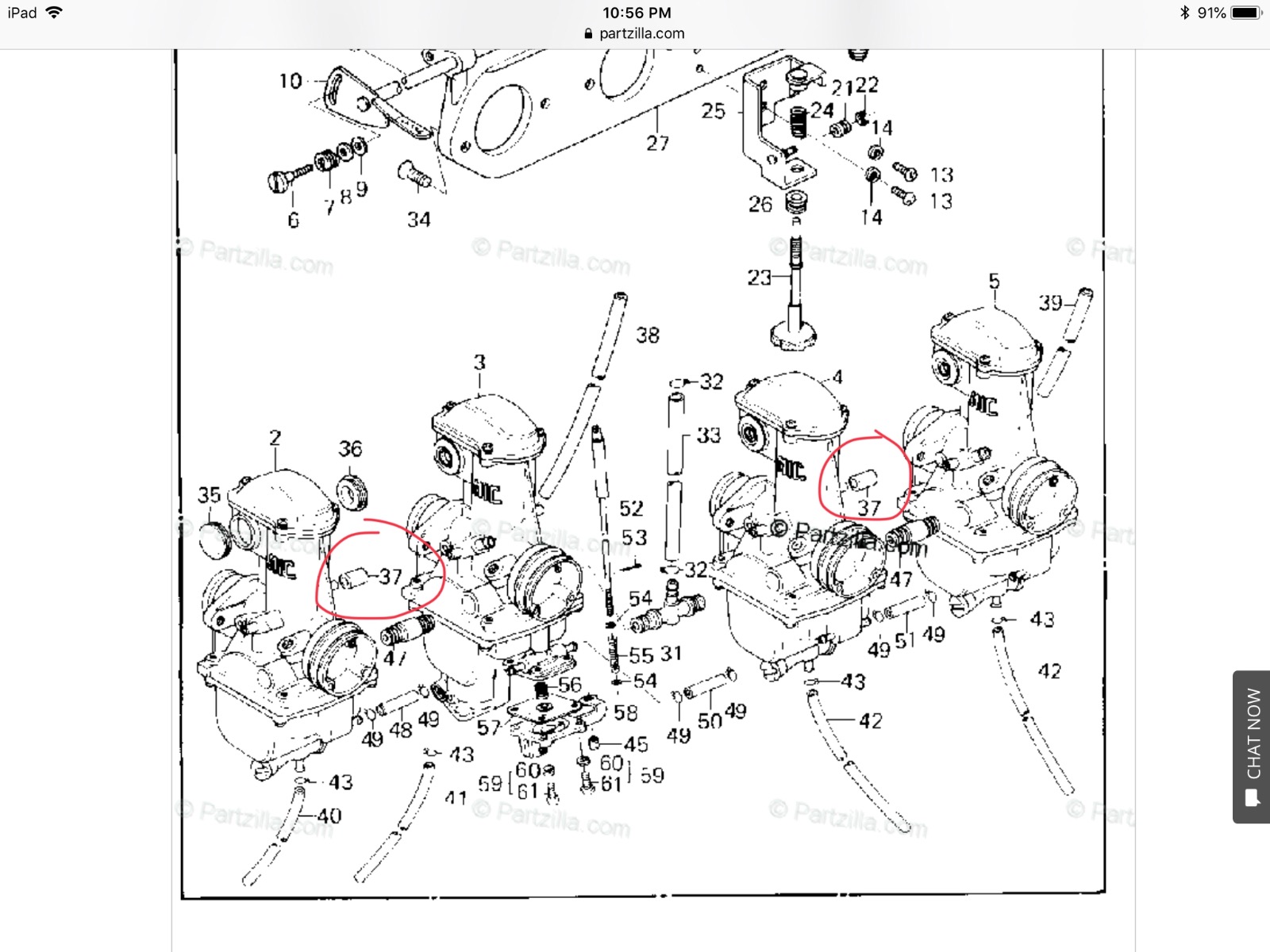

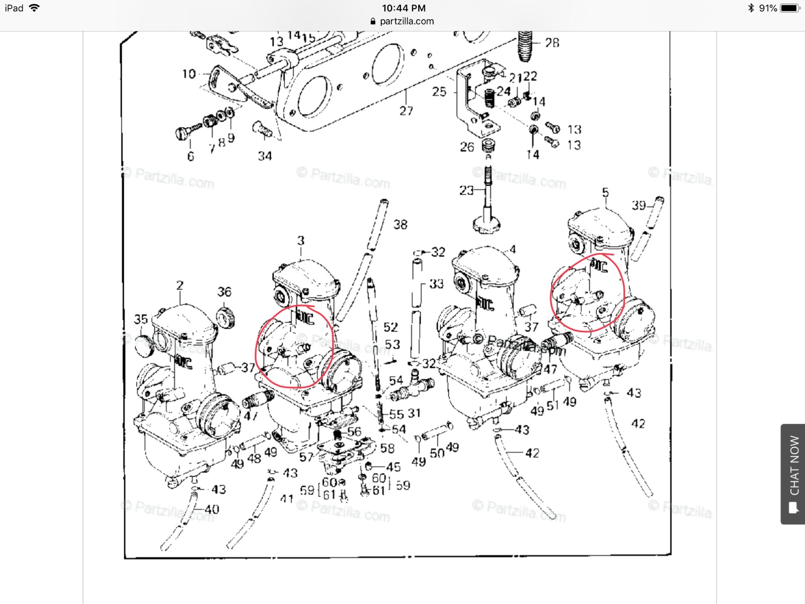

Re: 28mm VM carbs
15 Dec 2019 19:49
The circled ports are vents. Looks like you have a miss matched carb rack. You have a vent on number 3 carb. I don’t think that’s correct.

Re: 28mm VM carbs
15 Dec 2019 19:58 - 15 Dec 2019 20:06
Here is the diagram for the 1979-80 KZ1000 A3
www.partzilla.com/catalog/kawasaki/motor...y-u-s-a-79-80-a3-a3a
[Edited to correct a dumbass attack]

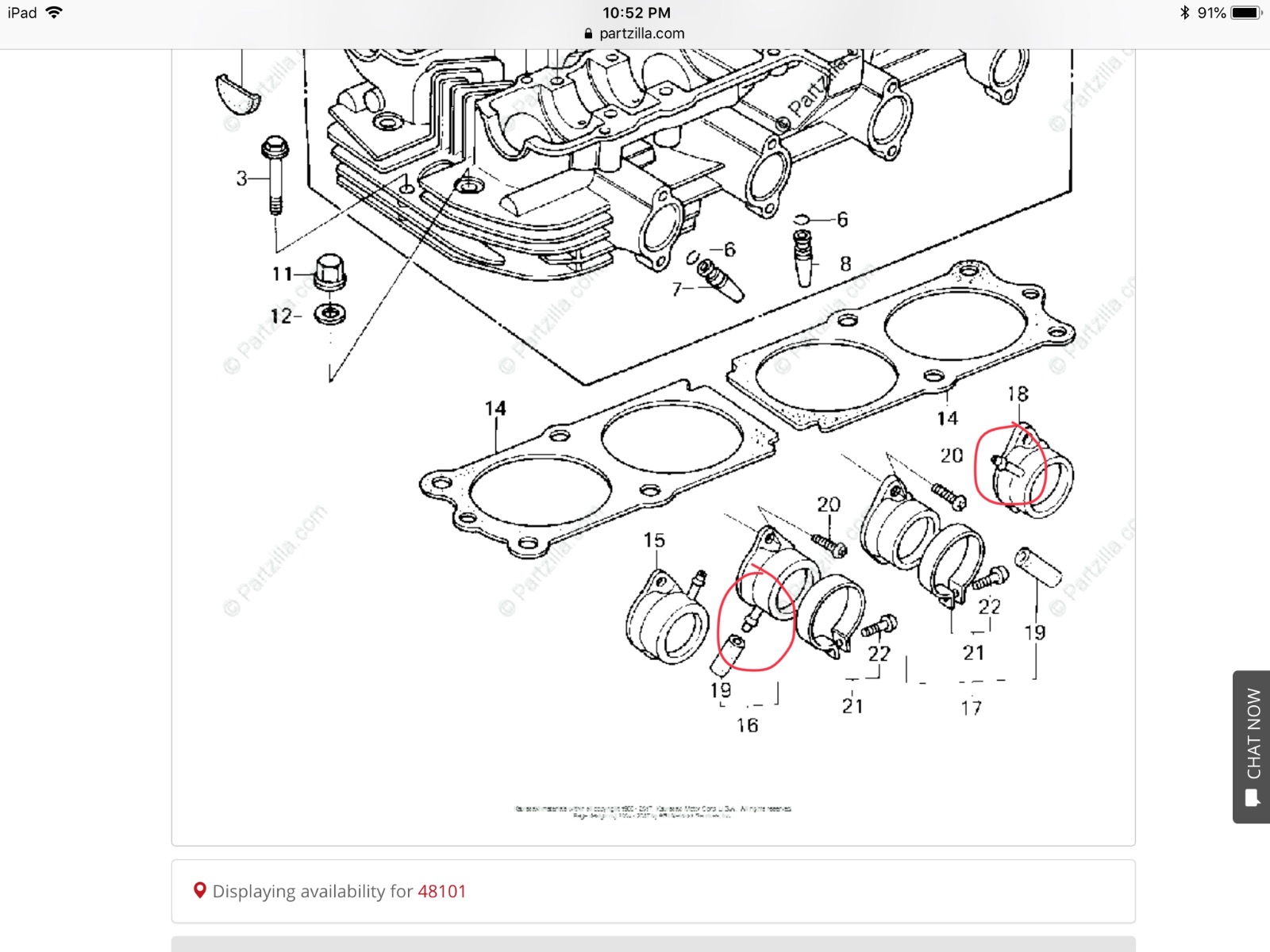

You can see bowl overflow tubes from the bottom of each bowl, two vent hoses ( see vent transfer tubes), one vacuum hose for the old petcock. I forgot that the synchronizing ports were on the manifolds.

Re: 28mm VM carbs
15 Dec 2019 19:58Well that sucks there miss matched, well I’ll open those top vents and see what happens, the second picture are the vacuum ports and all of them are capped
