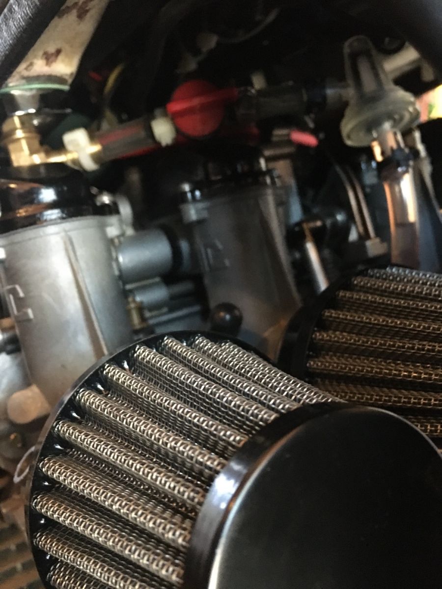

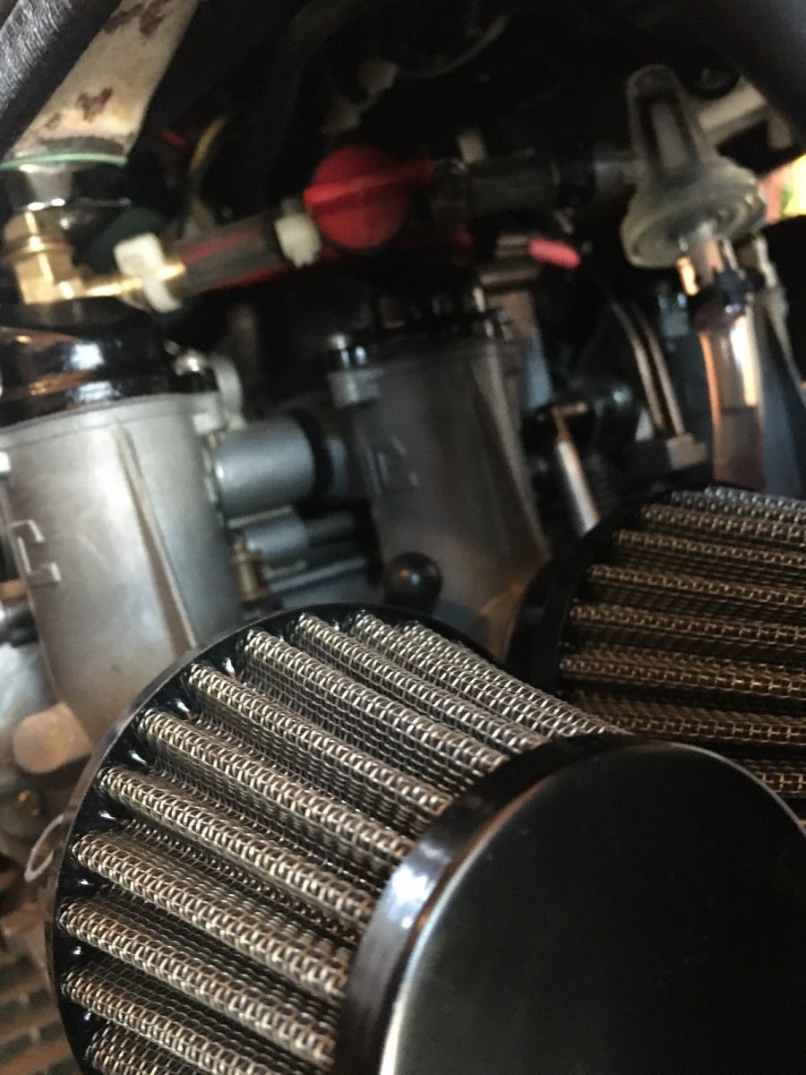

Happy thanksgiving everybody, well the pic below is what I’ve done in the mean time far as getting fuel to the carbs, so it will idle fine and rev up with a little throttle but if u try and drive it it will shut down idle drops then dies. I was gonna drive it today for the first time since I put the carbs on but it dang sure won’t go. Where do I start looking.

Sounds like you're not getting the proper fuel/air mixture.
Back in the late '70's Kawasaki was jumping through hoops to make their bikes compliant with EPA emissions. They went from the original Z1 28mm VM's to 26 mm VM's without an accelerator pump, then briefly to the 26 mm VM's WITH a pump and then to 28 mm VM's with a pump. Carbs were set leaner and leaner, particularly at idle. The pump was intended to give a small shot of gas when the throttle was initially blipped. As someone already stated, the 26 mm VM's with a pump were the worst of the VM series, which is why they went to 28 VM's in late '78 or early '79. The 26 VM's were the leanest of the lean, and adding stacks, as you have would probably make them even leaner. I wouldn't bother trying to get them to work properly on a big engine but if you want to fiddle around I would recommend larger pilots to give more fuel in the low rpm range. For mid range improvement you might want to lift your needles, or maybe go back to the needles and needle jets used in an earlier version of that series...say 1976 or 1977.
