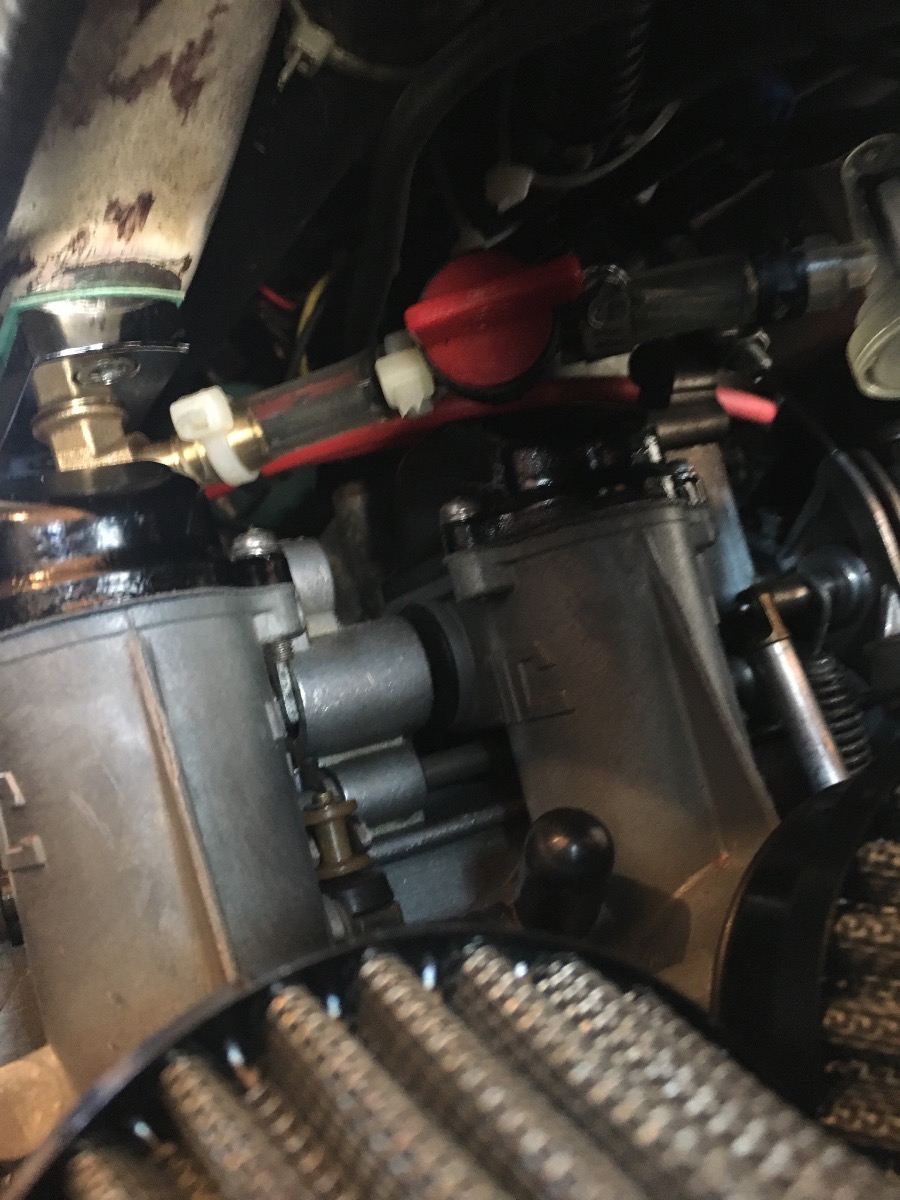

Mikaw wrote: Have you checked the fuel petcock.... is it starving for fuel...[/quotes
I don’t think it is , I ain’t long had to take off the old petcock cause it hit the carb. I know have a pingale adapter with a 3/8 npt 90 elbow then a on/off in-line from autozone and a filter so I think it’s getting plenty. I have try and check it but by the time a stop and look the line is full, I put clear hose on it.

Not a expert here but I don't think you can have the Airbleed nipple capped...

Mikaw wrote: Not a expert here but I don't think you can have the Airbleed nipple capped
On the 34s that came on the bike those where capped but those are cv carbs , I ain’t sure bout these but figured it was the same. When I come out of first and roll the throttle to run it it don’t actually die but it don’t bog down and the front drop either like it was to rich. It don’t sputter and jump like it’s to lean, it’s just like it coasts till I slowly close the throttle and then it try’s to go again for a second. I haven’t drove it but a couple of times since I put the carbs on and I don’t go but bout a mile from the house cause it won’t GO like it should.

Try it with the air bleed nipples open.. Might be causing a pressure build up not allowing a good fuel flow... I have never seen them capped...

The vacuum ports MUST be capped. The bowl vents MUST NOT be capped.
If the vacuum ports are not capped, the fuel mixture will be wicked lean. If the bowl vents are capped, the engine will be starved for fuel because very little fuel can go into the bowls unless air can get out..
Ok, do i need to put a hose on them angled down and open of course to keep the dirt and bugs out. I’ve been fight dirt dobbers for the past two years lol. They get everywhere, I got mesh over my Vmax intake to keep them out.

if your concerned about insects then try a short section of hose with some fine mesh screen over the end and zippy tied
