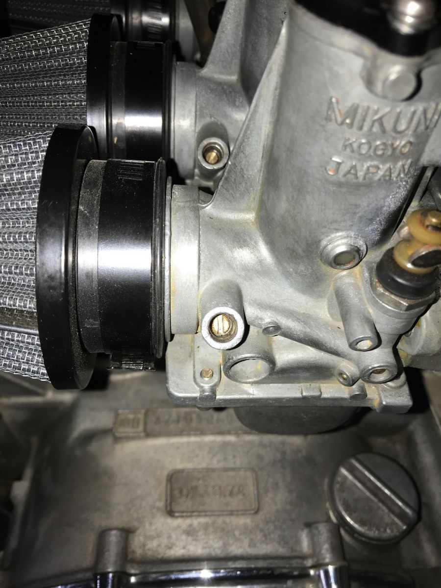

I went back to P1 of this thread and looked at the carb photo after you cleaned them up. There is a side shot that shows the fuel/air screw, but it looks like someone at some point blocked the passage with a Phillips screw. Also, in all of the photos I haven't seen any pilot adjusters, which are usually located on the bottom front of the carbs. If you have no pilot adjusters and you also have lost the ability to adjust your fuel/air ratio then you maybe should consider scrapping those carbs unless you can somehow fix the fuel/air screw problem.

16 Dec 2019 05:52hardrockminer wrote: I went back to P1 of this thread and looked at the carb photo after you cleaned them up. There is a side shot that shows the fuel/air screw, but it looks like someone at some point blocked the passage with a Phillips screw. Also, in all of the photos I haven't seen any pilot adjusters, which are usually located on the bottom front of the carbs. If you have no pilot adjusters and you also have lost the ability to adjust your fuel/air ratio then you maybe should consider scrapping those carbs unless you can somehow fix the fuel/air screw problem.
The air/fuel screws are on the side at a down angle, that Phillips head screw was actually a air/fuel needle but the wrong one I have since gotten 4 new needles from partzilla and they are all brass flatheads.

Screws on the side are pilot AIR mix adjusters and screws underneath are pilot FUEL mix.
On stock Kawasaki Mikunis you will never have both types but just one or the other and they essentially do the same job of adjusting the pilot air/fuel ratio.
If you have Mikunis with both air and fuel mix screws then they would be SUZUKI GS fitment .

16 Dec 2019 08:26zed1015 wrote: Screws on the side are pilot AIR mix adjusters and screws underneath are pilot FUEL mix.
Didn’t know that, I knew they didn’t have the bottom screw ,where it went is blank ( never tapped). Figured it was right. I’ve been looking on partzilla to figure out what carbs I had and the parts , I’ve been using the part list from 1980 Z1R-kz1000 D3.
