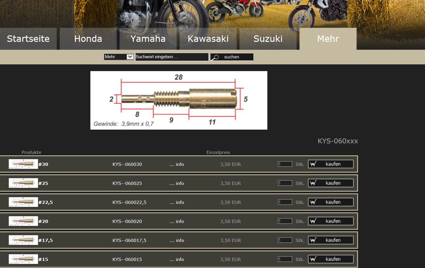

Keyster offers up to #30 Pilot jets.
www.motorradbay.de/kys060xxx-c-207_209_2...cab37f89e1de5e9278bd
