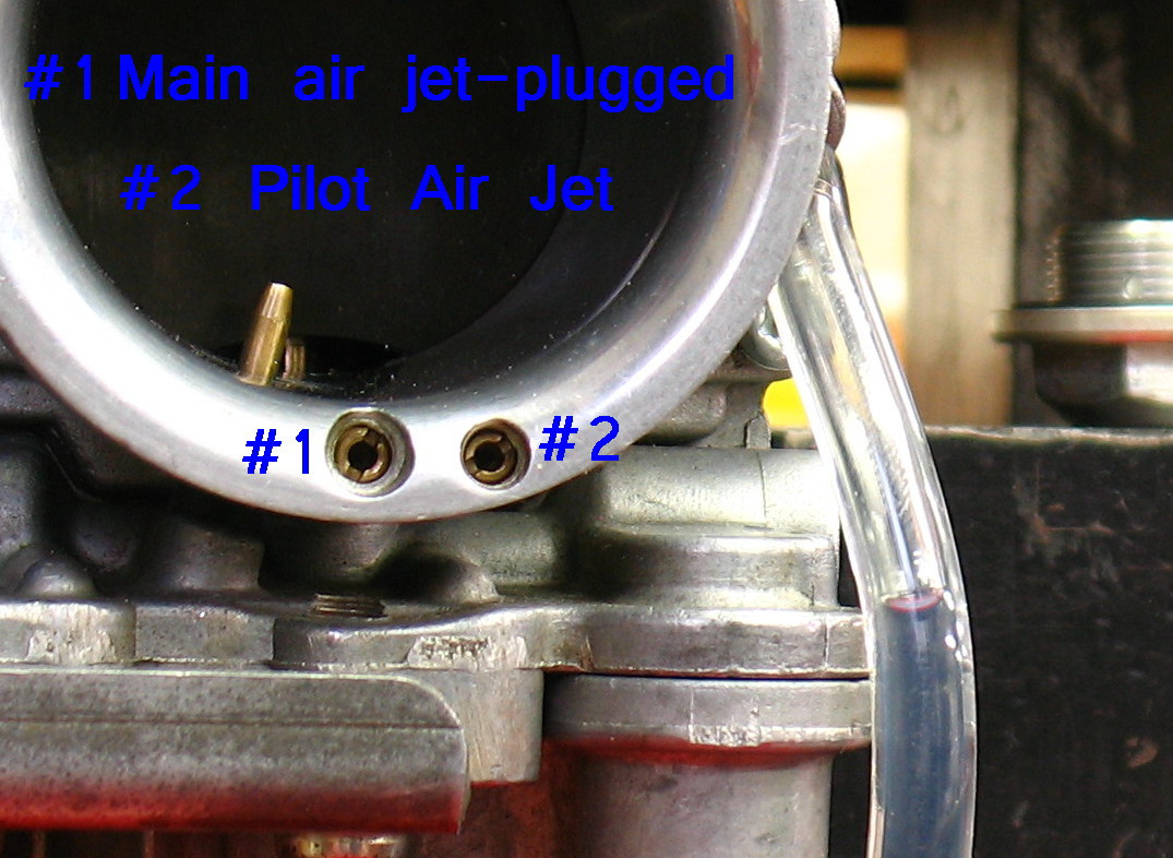

Well, that explains why my spark-plug crush washers are flattened out after one or two removals. I thought the FSM torque spec of 20 ft. lbs. was to be taken as gospel, but such is the result of my experience. :pinch:
Back to my jet question... :S
My RS36 carburetors are setup with 17.5 pilot fuel jets and 0.7 air jets.
Does that have exactly the same effect as using 20 pilot fuel jets and 0.8 air jets?

I would suspect the air jets are for the mains not the pilots. Pic?

Re: Mikuni VM 33 Carbs
15 Nov 2016 21:12swest wrote: I would suspect the air jets are for the mains not the pilots. Pic?
Steve, hope this helps.
Pic: Note Pilot Air Jet is the small one on the right.

15 Nov 2016 21:24
Main air jet plugged? Is that a accelerator pump nozzle? Have you tried looking on the jetsrus charts like they have for the Micunis? Maybe try Sudco for the jetting for your machine. Also the float level looks a little high. That would make it rich on the bottom.
15 Nov 2016 22:07swest wrote: Main air jet plugged? Is that a accelerator pump nozzle? Have you tried looking on the jetsrus charts like they have for the Micunis? Maybe try Sudco for the jetting for your machine. Also the float level looks a little high. That would make it rich on the bottom.
Main air jets plugged, yes as exploded part list states and what looks like a jet is actually a plug.
Yes, the accelerator (pump) nozzle is shown vertical in the bore in front of the throttle slide, directly below the blue P.
All good on the instructions for jetting, except for the Mikuni application chart indicates Pilot screw setting range from 1/4 - 1/2 turn (off lightly seated I believe), not 2 1/2 - 3 turns. Runs well at 1/4 turn out currently.
Float levels measured and set correctly at 17 mm per Mikuni instruction manual. There is no measurement information on which to base using the clear-tube float setting method that works on the BS34's so well.
16 Nov 2016 03:34
I agree with Swest , that fuel level looks high, even if the floats are correct lowering the fuel level a mm or less at a time is worth a try if your having problems.
Float level is a viable and accepted way to fine tune a carb , within reason of course.
