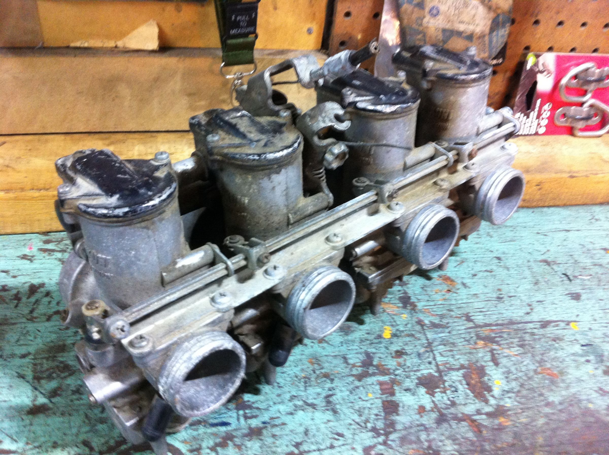

I hope I am not highjacking here, but I am curious about whether or not there is much of a market for VM33's. I've read through this whole thread, and get the feel that at least Steve is having success with them.
I mainly ask because I seem to have inherited a set with a parts 650 I picked up a couple of months ago. As soon as I can get it organized, I will post some photos, to confirm what they are. I reckon somebody else can let me know if I have it wrong anyway.
The plan had been just to tidy them up for sale, as they are far too big for any of my bikes, and it seems they have some intrinsic value. If the OP was suggesting they can be worth $250-300 USD, then it is worth the time to clean them up and sell them off. (Or, as always for fair prize to a fellow KZer.)

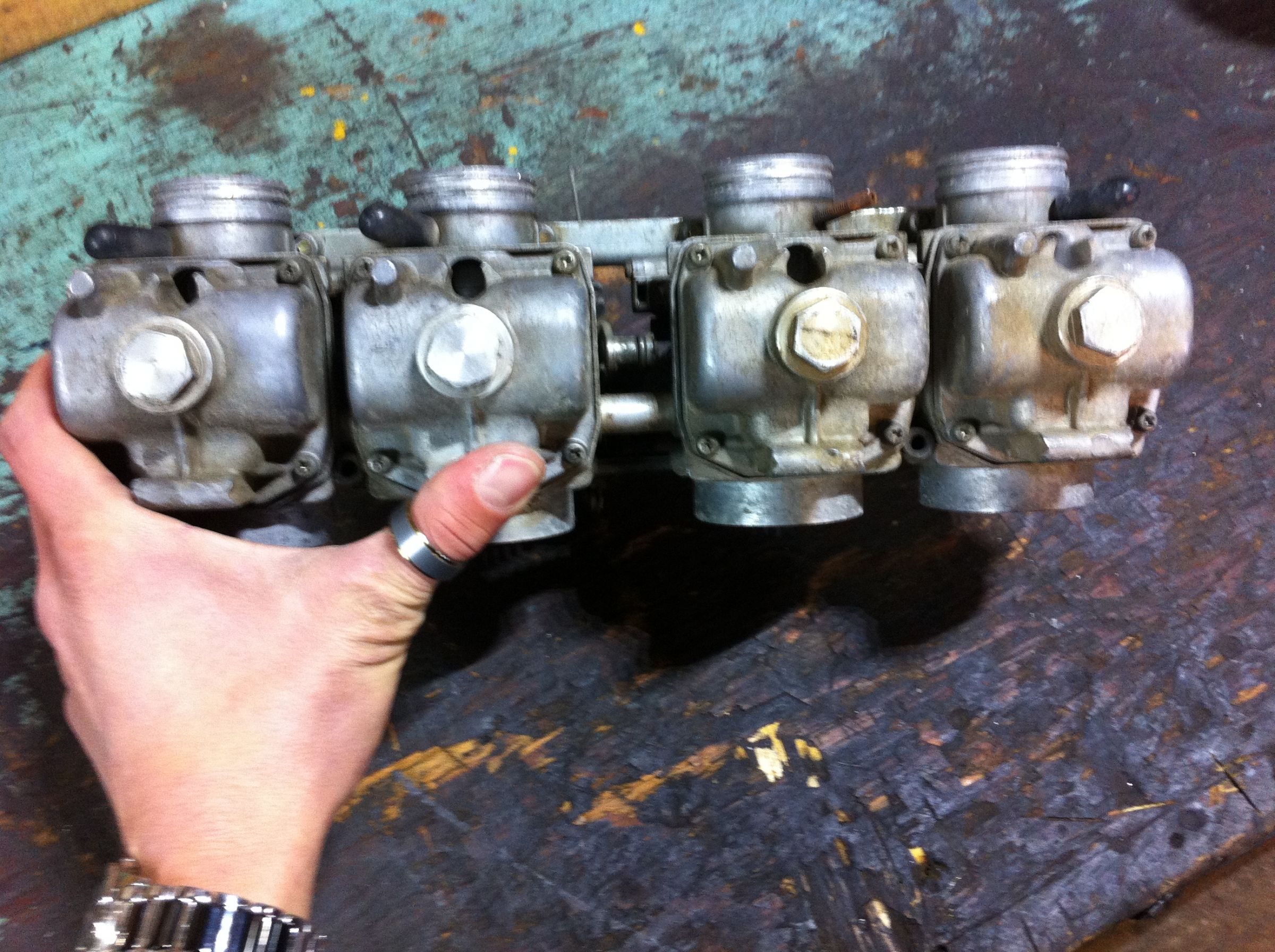

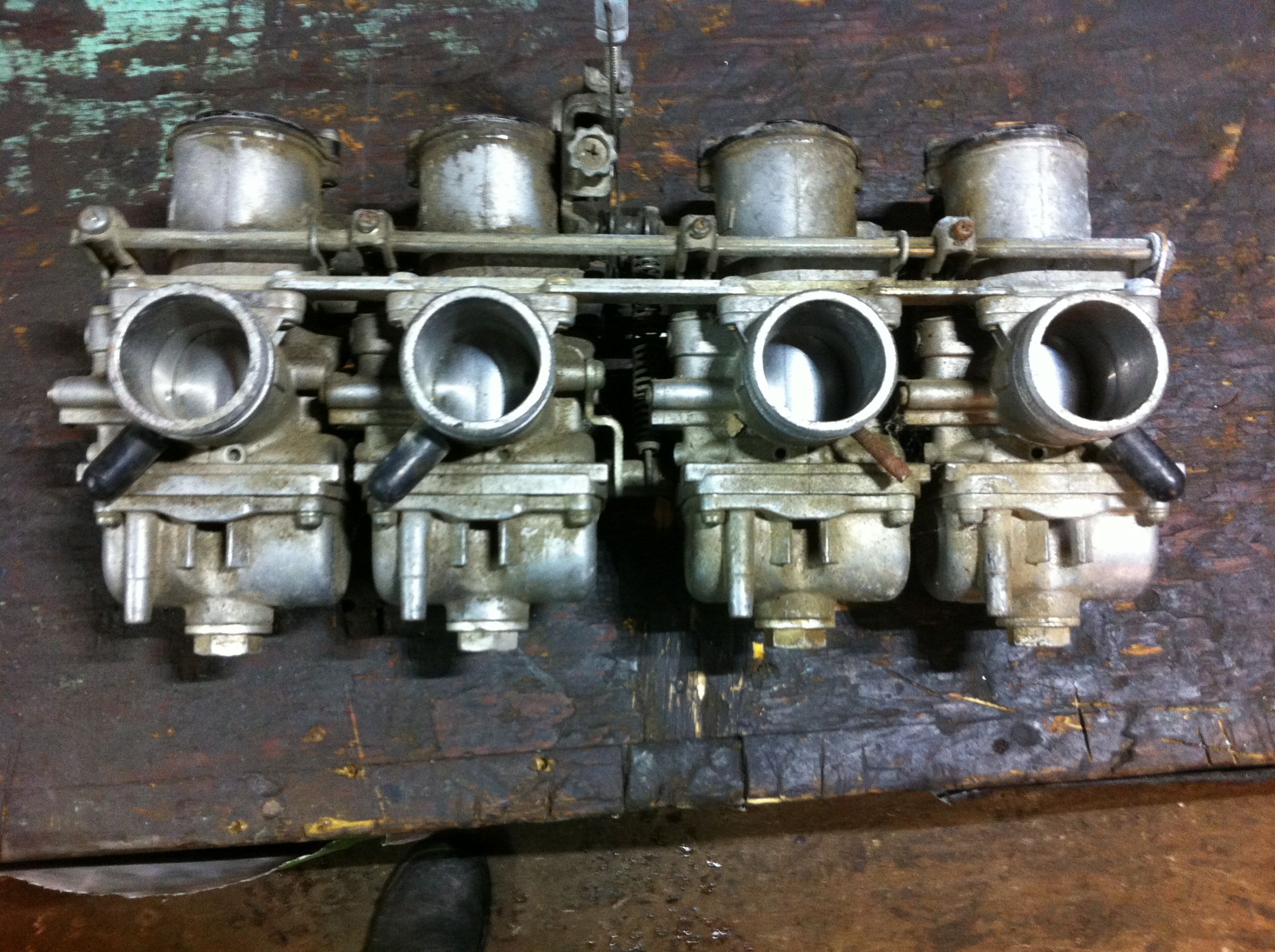

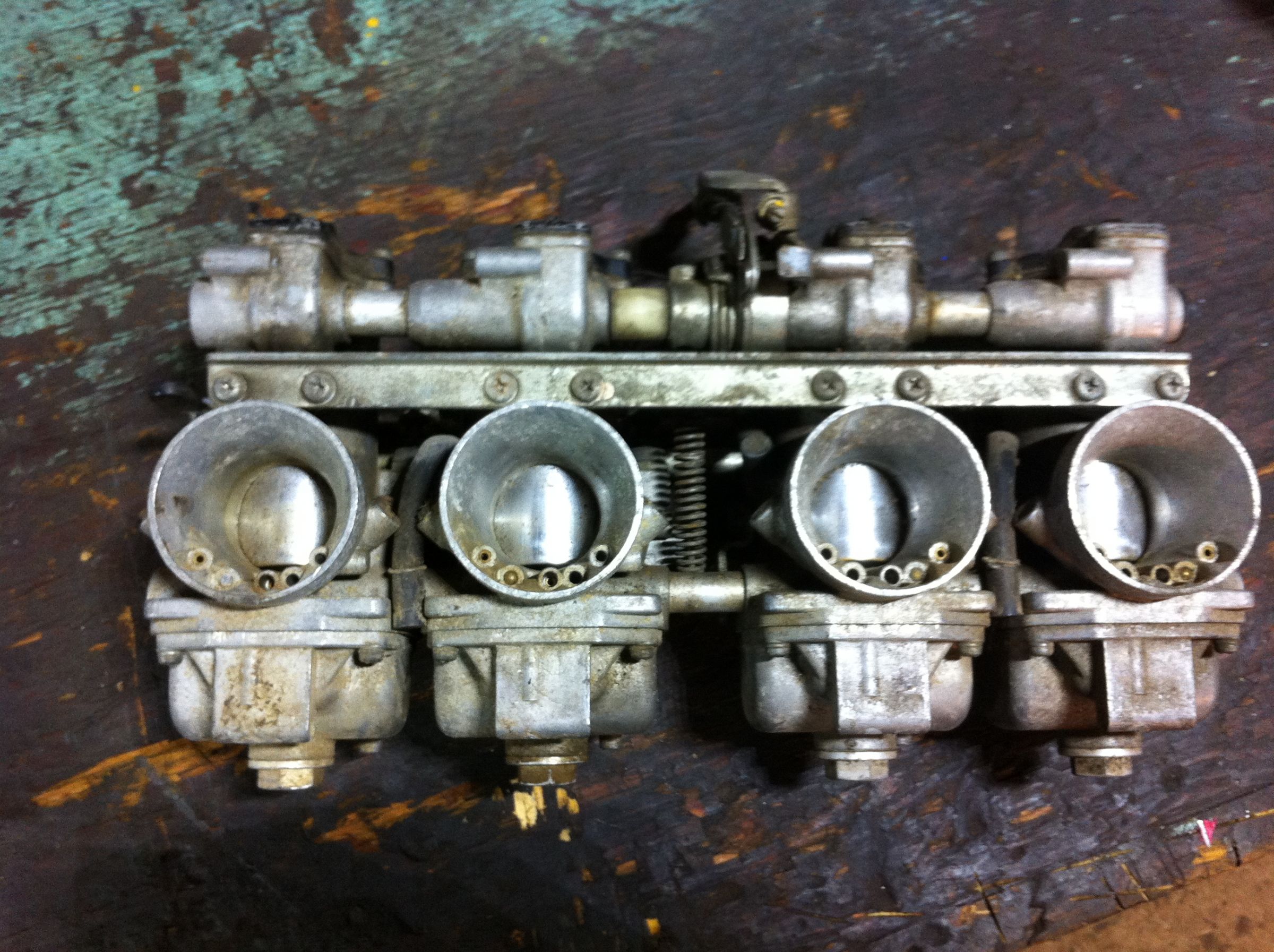

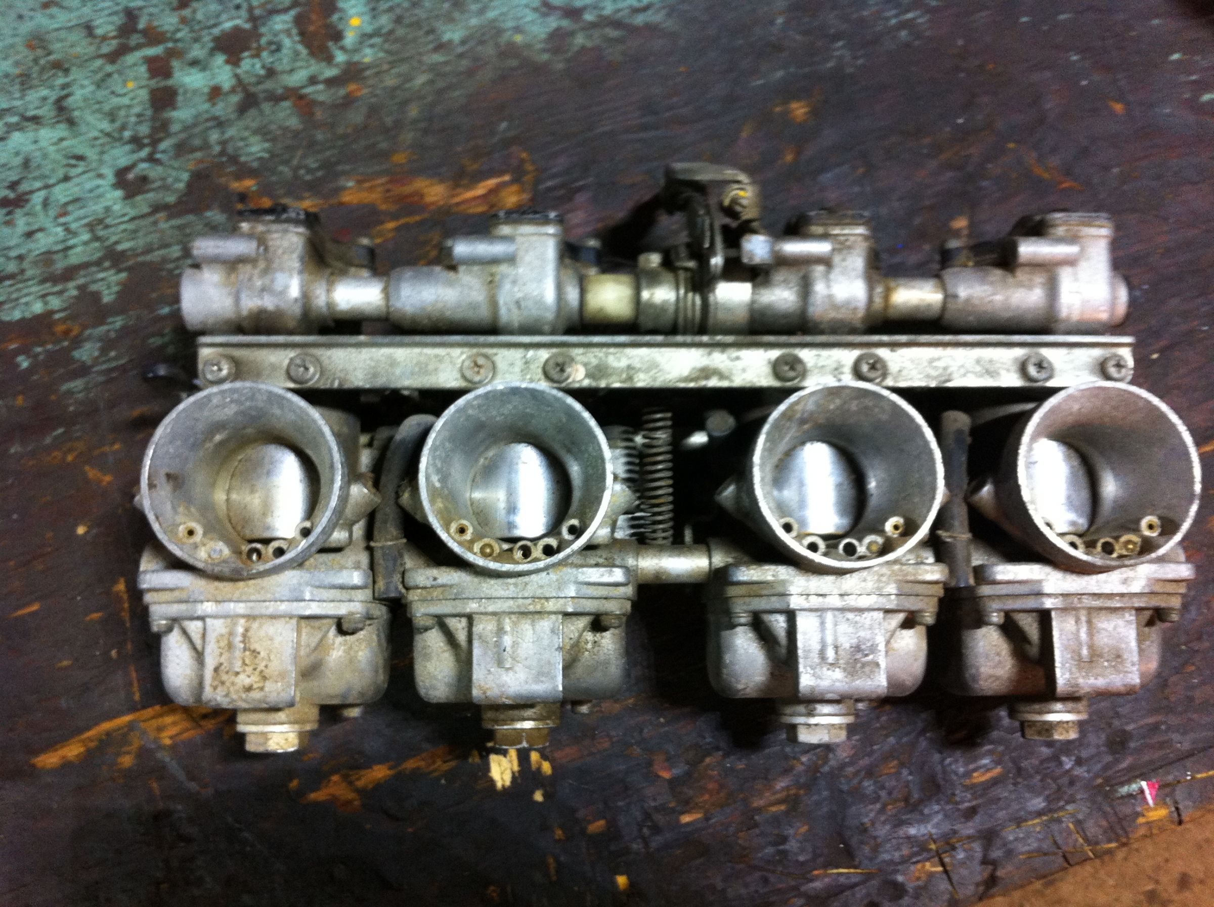

Thanks all for helping with the identification.
The photos aren't great, as they are just off my cell phone, but I think they are at least sufficiently good to figure out what these are.
They've clearly been modified for vacuum ports by somebody, which among a couple other things suggested to me that they were maybe the VM33s, which as per earlier did not come with synching ports. I did check the bore diameter quickly at the fellows house, and I seem to remember it being a touch OVER 33mm, but not an awful lot. I currently have then soaking in some hot soapy water to clean them up at least a little before moving on.
If this isn't enough info for a good identification, then let me know, and I can take some more photos or look for other distinguishing marks.
Thanks in advance,
Jon

02 Jan 2017 15:15
Yup, just like mine.
