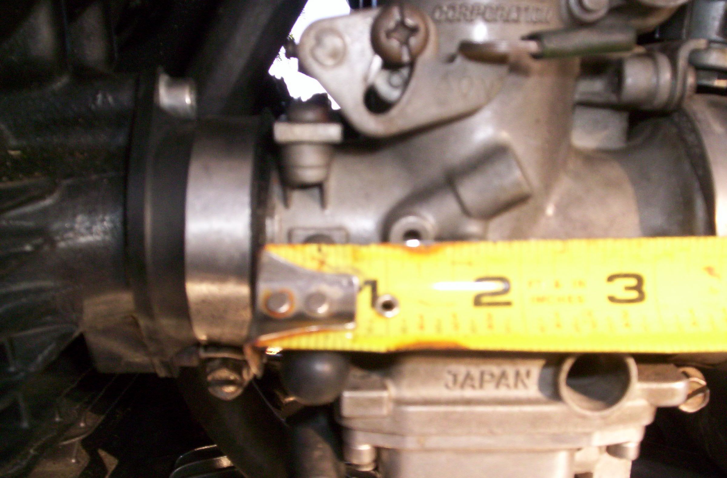

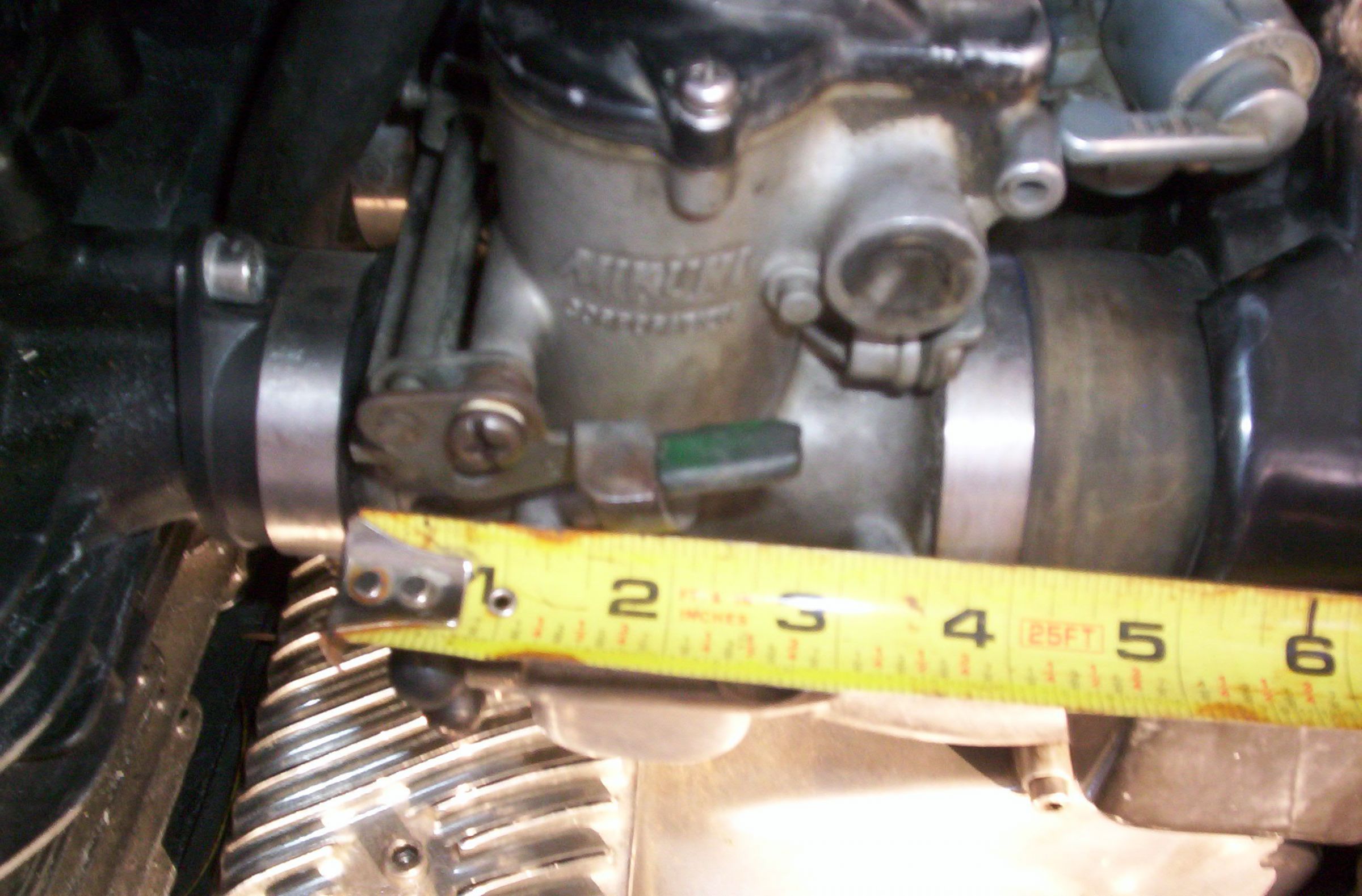

A good argument for syncing the carbs. Though they looked good on the bench, #3 the lead carb was at 30 when the rest were at 19, #4 was at 29. Had to loosen #3 arm on the shaft to make it come down, then tighten it. Not much but enough to throw everything off. Finally got them close enough. I'll put some miles on it to let things settle in, then do it again. No more popping out of the pipe and one cylinder running lean.

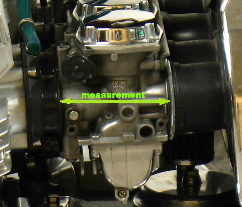

While you are at it, could you measure something for me?

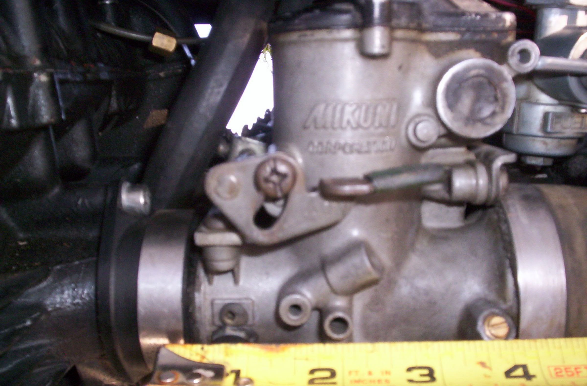

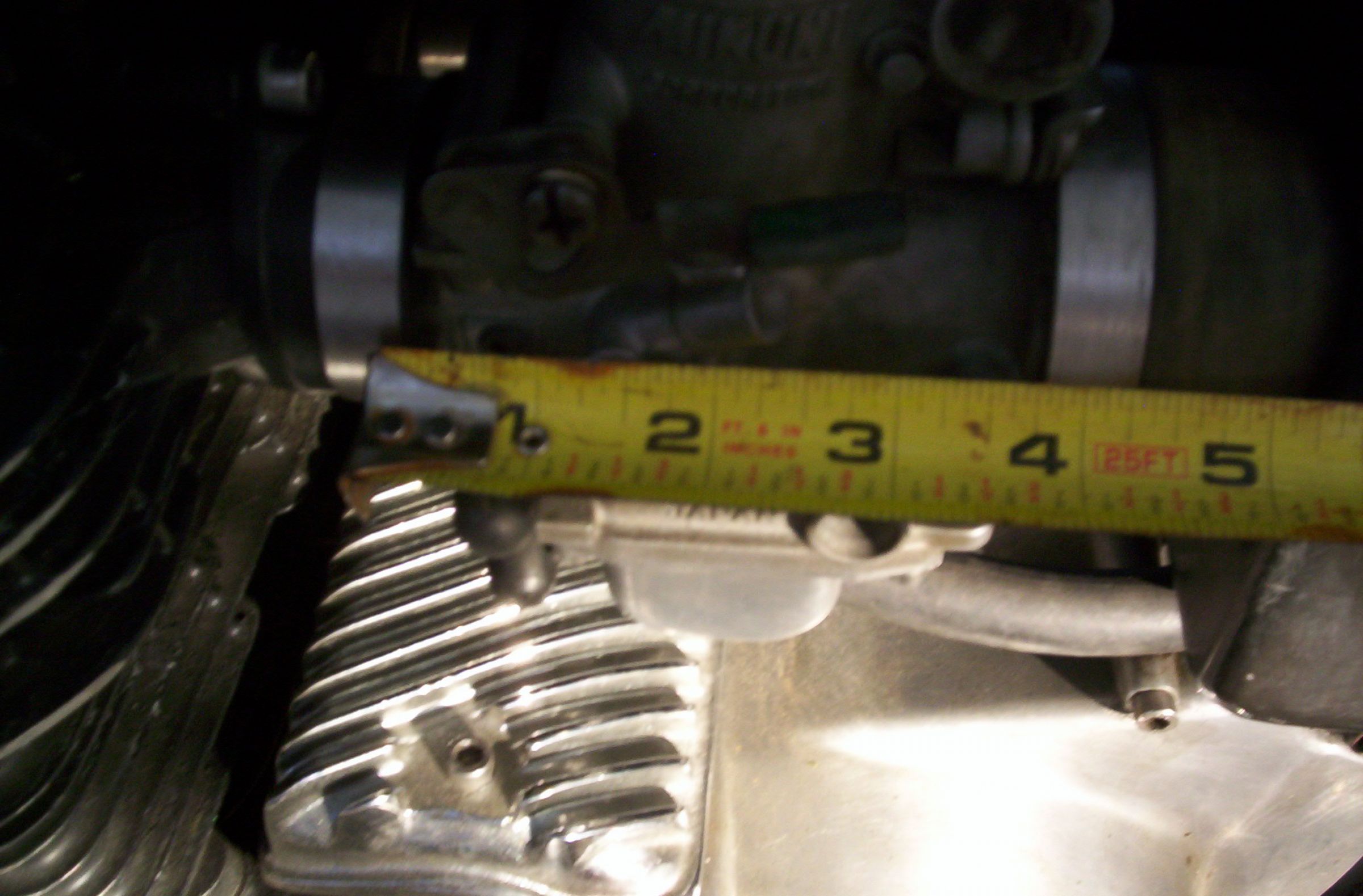

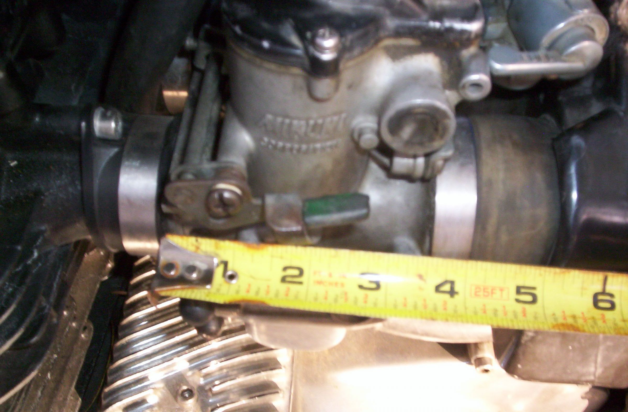

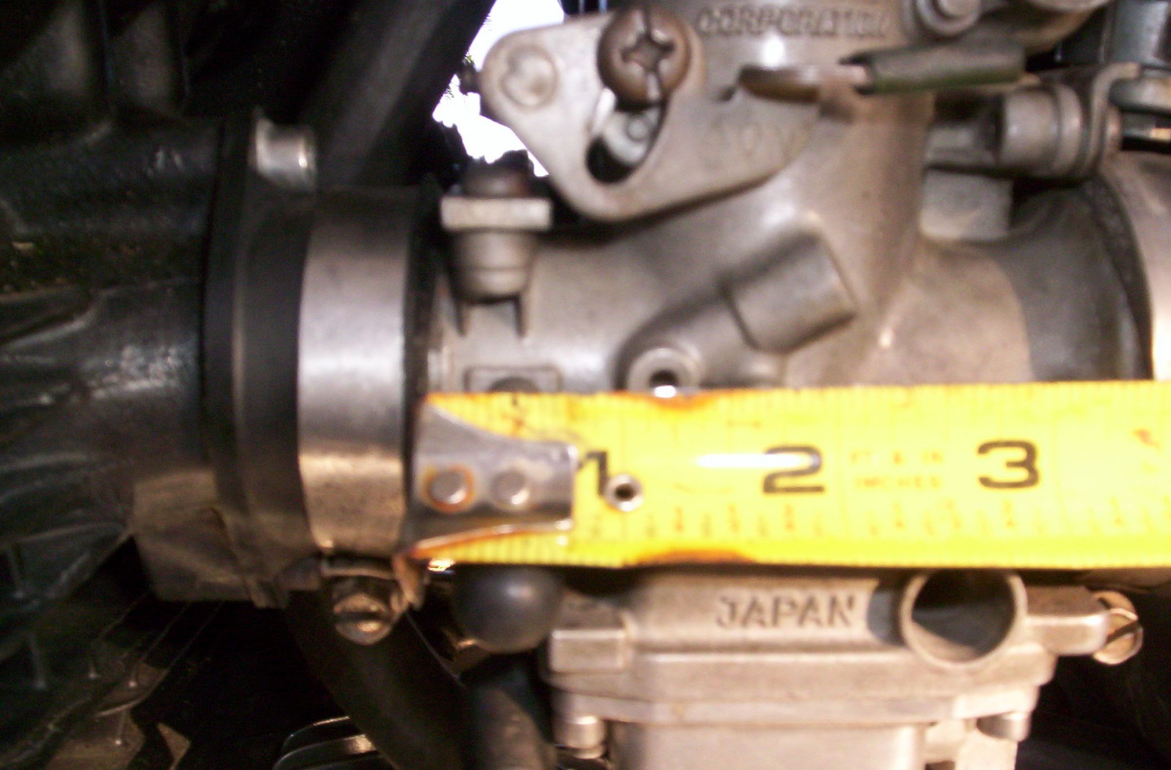

13 Mar 2016 18:29 - 13 Mar 2016 18:30swest wrote: 3 3.4" approx 4 1/4". Those carbs look good.
Thanks Steve, your last pic got it. 3.5"
