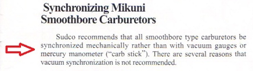

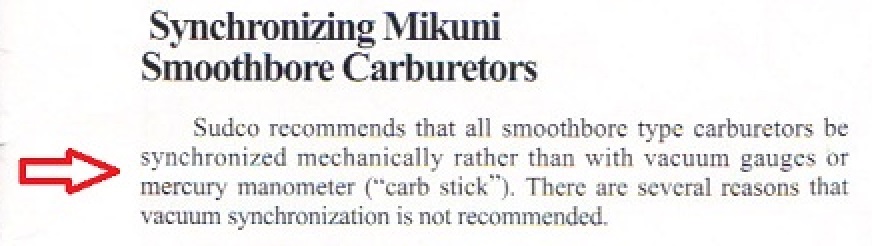

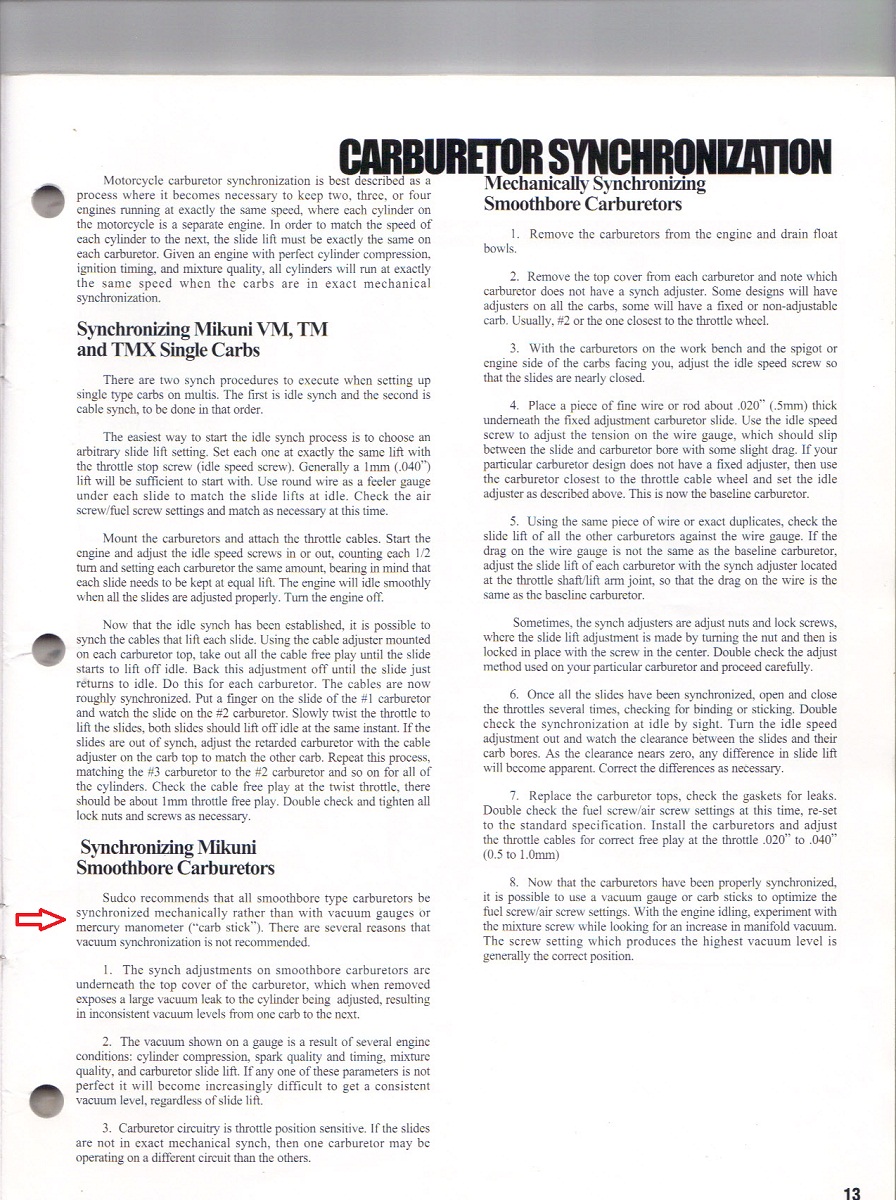

With reference to vacuum sync for Mikuni 33 smoothbore carbs,
Per Sudco:
Sudco recommends only mechanical sync for smoothbore carbs.
Such mechanical sync is also known as bench sync, where the carb assembly has been removed from the engine and is on the work bench with the top caps removed to allow access to the throttle slide adjustments in each carb.
After the bench sync, when a "running sync" with manometer or vacuum gauges might be thereafter performed, Sudco says the detached caps allow air leaks which adversely impact a "running sync."
In summary, Sudco says to carefully bench sync, followed by pilot air screw tuning of the idle circuits with the carbs fully assembled (i.e., caps attached).
However, the stock Mikuni carbs with manual slides and side-located pilot air screws would be expected to have the same "air leak" with their caps removed, as noted by Sudco. Moreover, the Kawasaki FSM details the procedure for both bench sync (basically same as the mechanical sync described by Sudco), followed by a running sync with caps removed and manometer or vacuum gauges attached.
Am thinking most smoothbore tuners, including wiredgeorge, perform both bench sync and running sync, the same as for stock manual slide Mikuni's as provided in the FSM. And I have long enjoyed success in syncing smoothbores by following the FSM stock carb sync procedure for Mikuni mechanical throttle slide carbs. The dreaded "air leaks" with caps removed hasn't been an issue. And in any event, running sync may be easily verified by reading the manometer or vacuum gauges after the top caps are replaced.
Let's say that bench sync has been done, and the carb assembly is now reattached to the engine, and the carb caps are off, and manometer or vacuum gauges are attached, and engine is idling, and sync screws have been adjusted to provide the best equal vacuums in all carbs, and the slide adjustments have been locked. Next, turn off the engine, remove the manometer or vacuum gauges, and replace the caps. Then re-start the engine and proceed with final fine tuning of the pilot air screws.
Remember to have a fan blowing on the engine to keep it from over-heating while the engine is at idle rpm during the running sync process and pilot screw fine tuning adjustments.
Here's a tip about bench sync that might not be mentioned in the FSM.
When setting the slides to equal heights (with paper clip, drill bit, wire, or whatever), be sure to have the idle adustment screw threads in approximate mid-position or at least in a position to assure that the slides may be lowered during the running sync. Neglecting this step may result in being unable to sufficiently lower the idle rpm. For example, when fine tuning the pilot air screws gets the idle rpm too high, it's important to have some threads remaining on the idle adjustment screw in order to reduce the idle speed.
