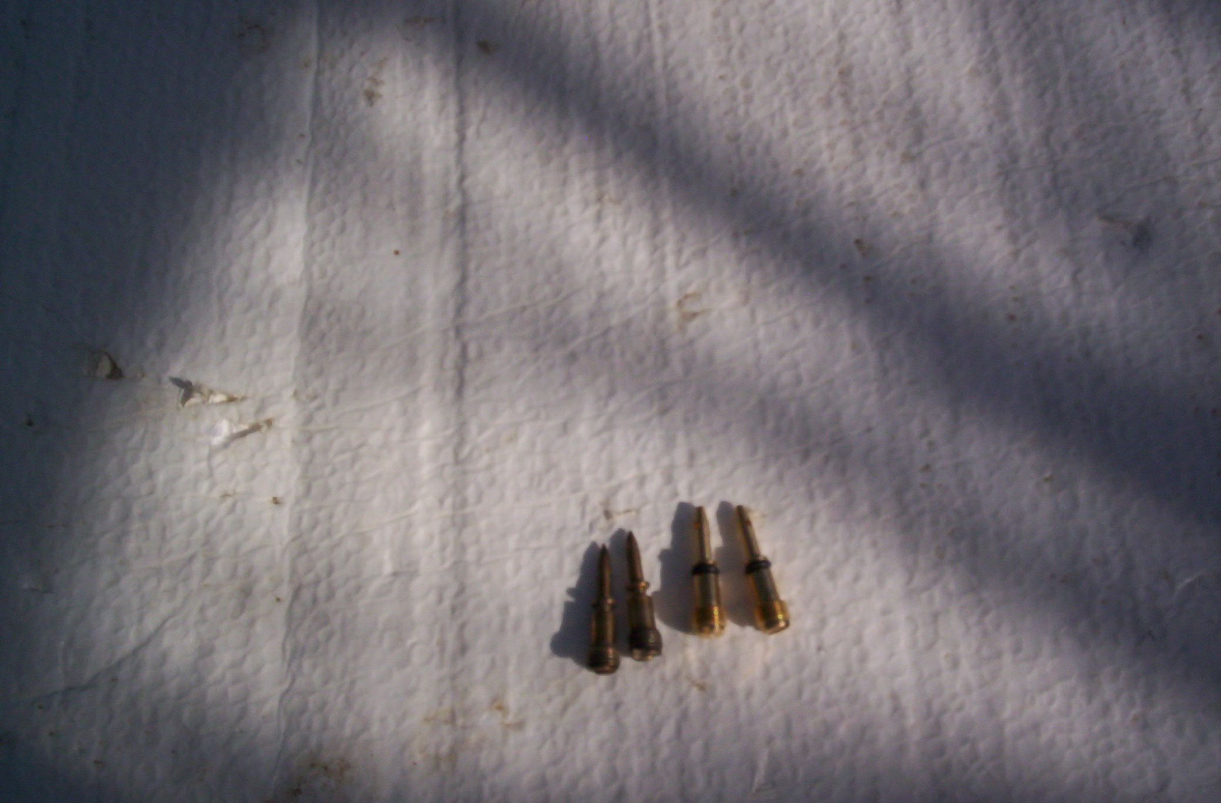

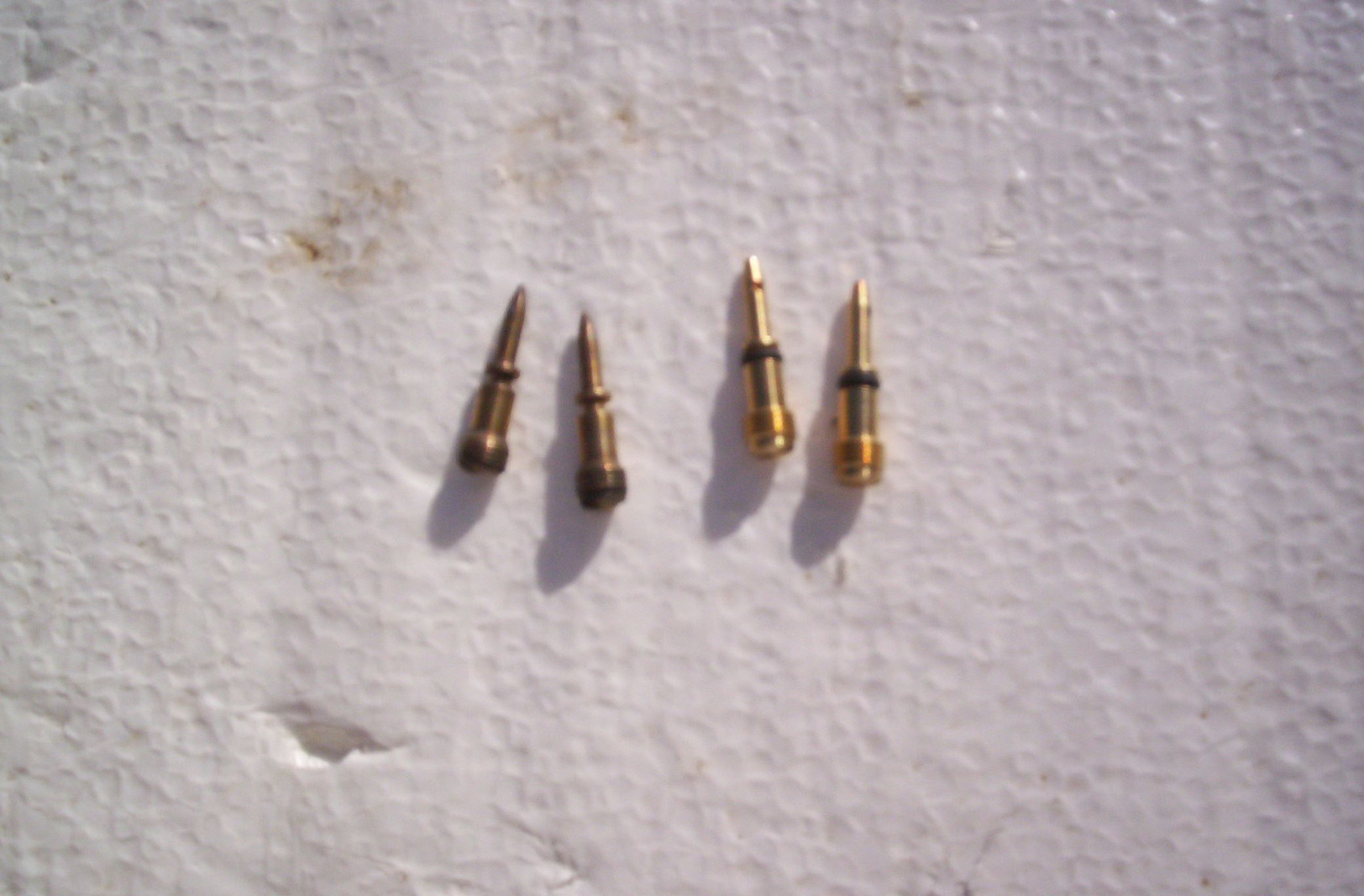

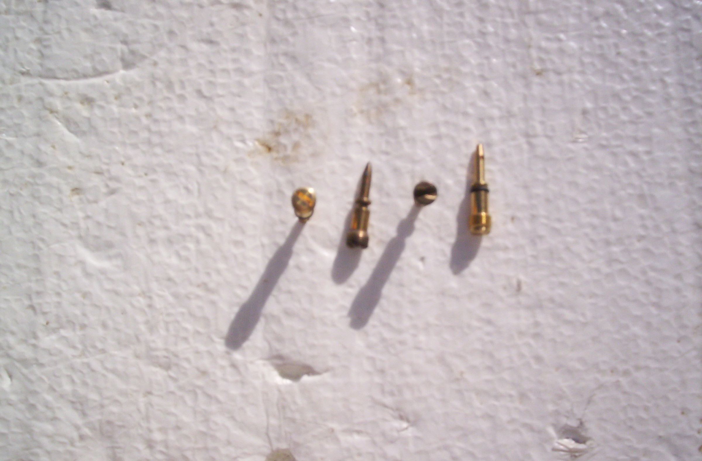

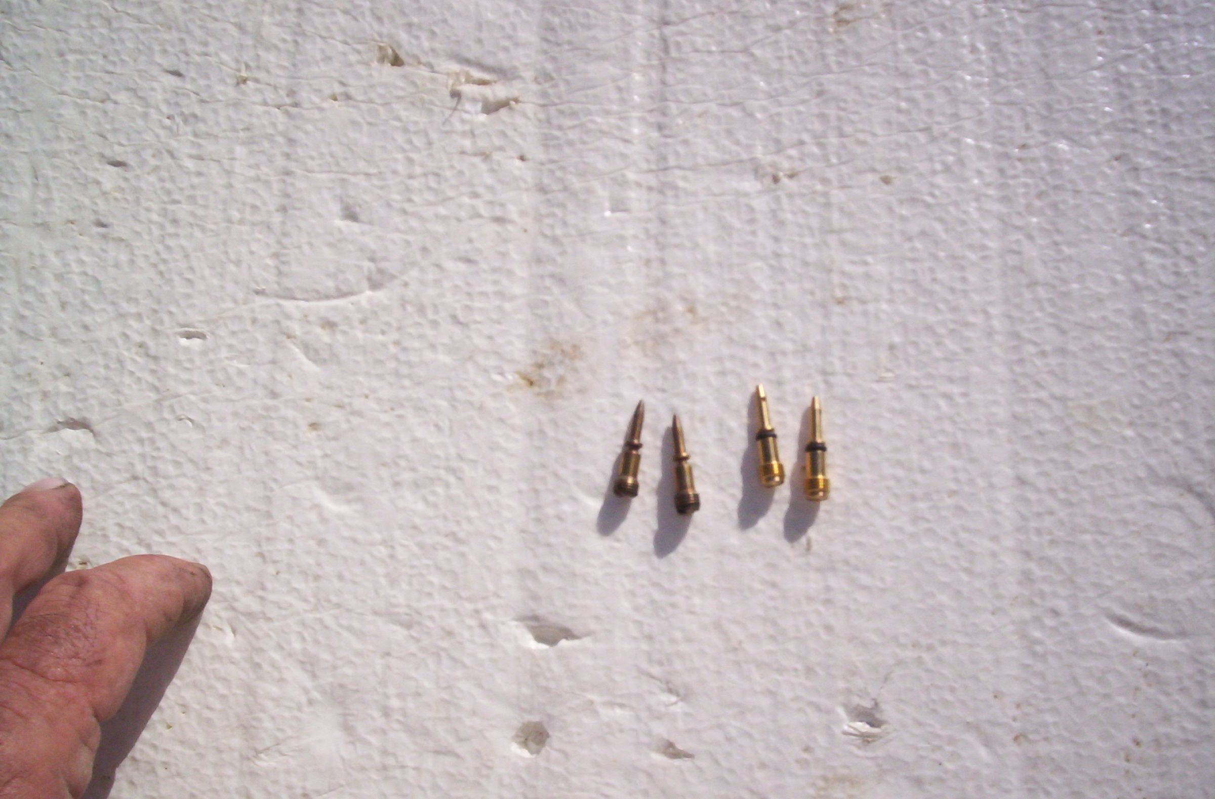

Well, I got my new pilot screws. 2&3 slots looked good. I should have ordered four. THIS IS ANOTHER REASON PO's SUCK. The new ones have a hole in them thus the 1/4 to 1/2 turn adjustment. I could tell the PO had soldered the holes and changed the tapers on them but WTF? :pinch: The new ones look like they have a jet hole in the tip too. I got four O rings. I've tried others but they wouldn't fit. I'm going to put them in the bike now and plan on installing my new vacuum "nipples" tomorrow. I'll sync them then.
- Posts: 23776
- Thanks: 3042
Re: Mikuni VM 33 Carbs
09 Mar 2016 16:54
Put them in. A little grease. the O rings slipped right in. The new ones are in 1 & 4 3/4 turn, it idles. 2 & 3 1 1/4 turn, idle comes up like on the 28's. As I suspected the O rings make the screws more effective. I'll order 2 new ones later and more on the carbs tomorrow.

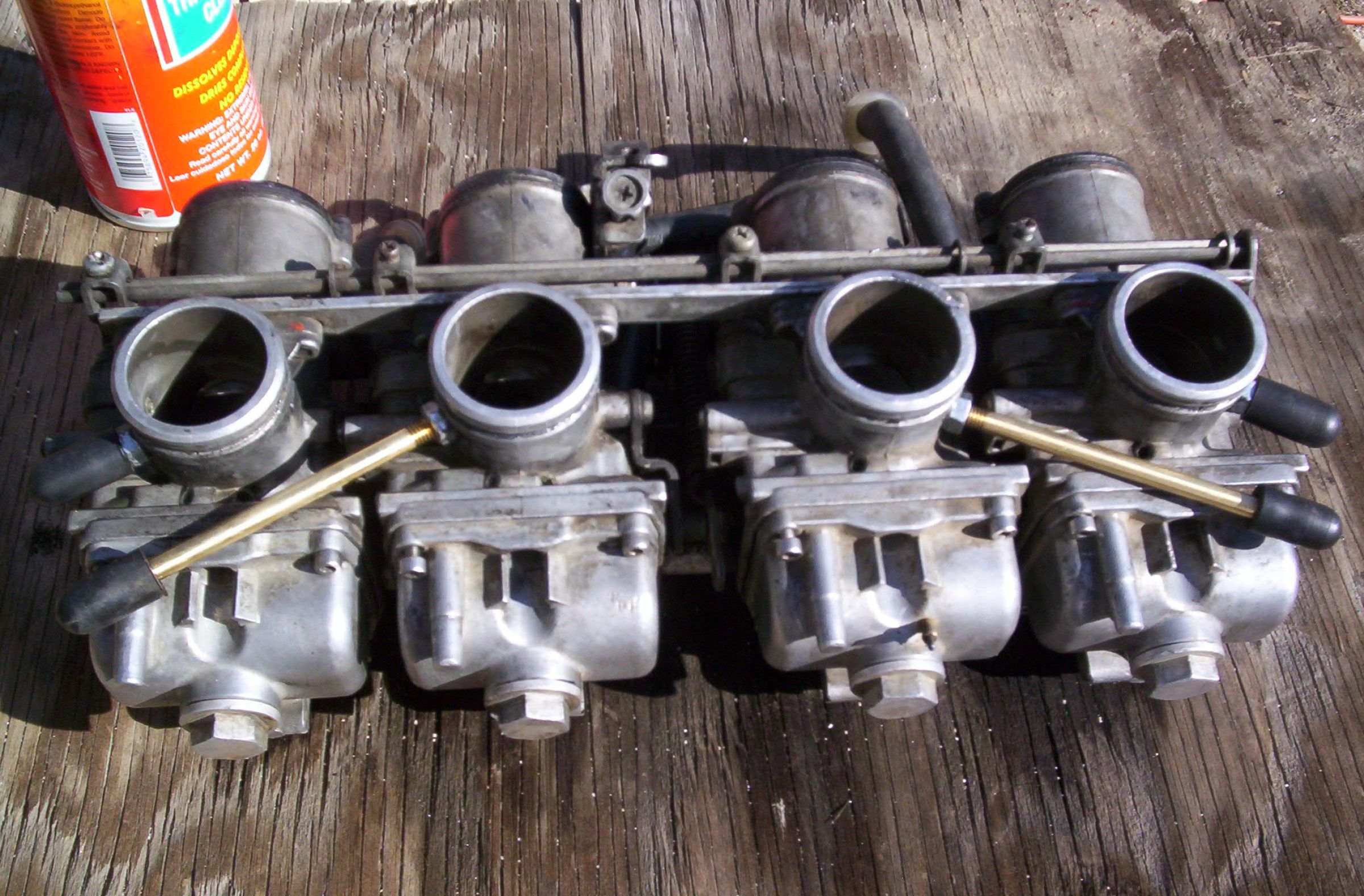

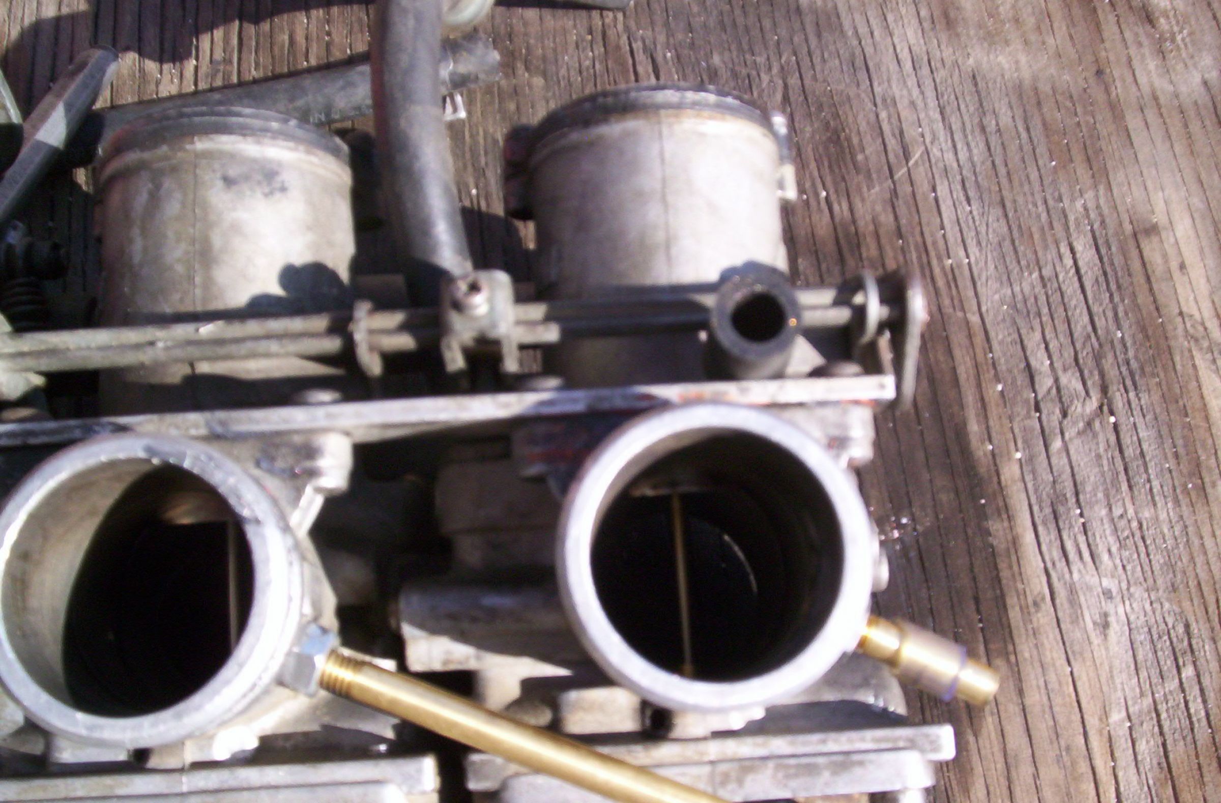

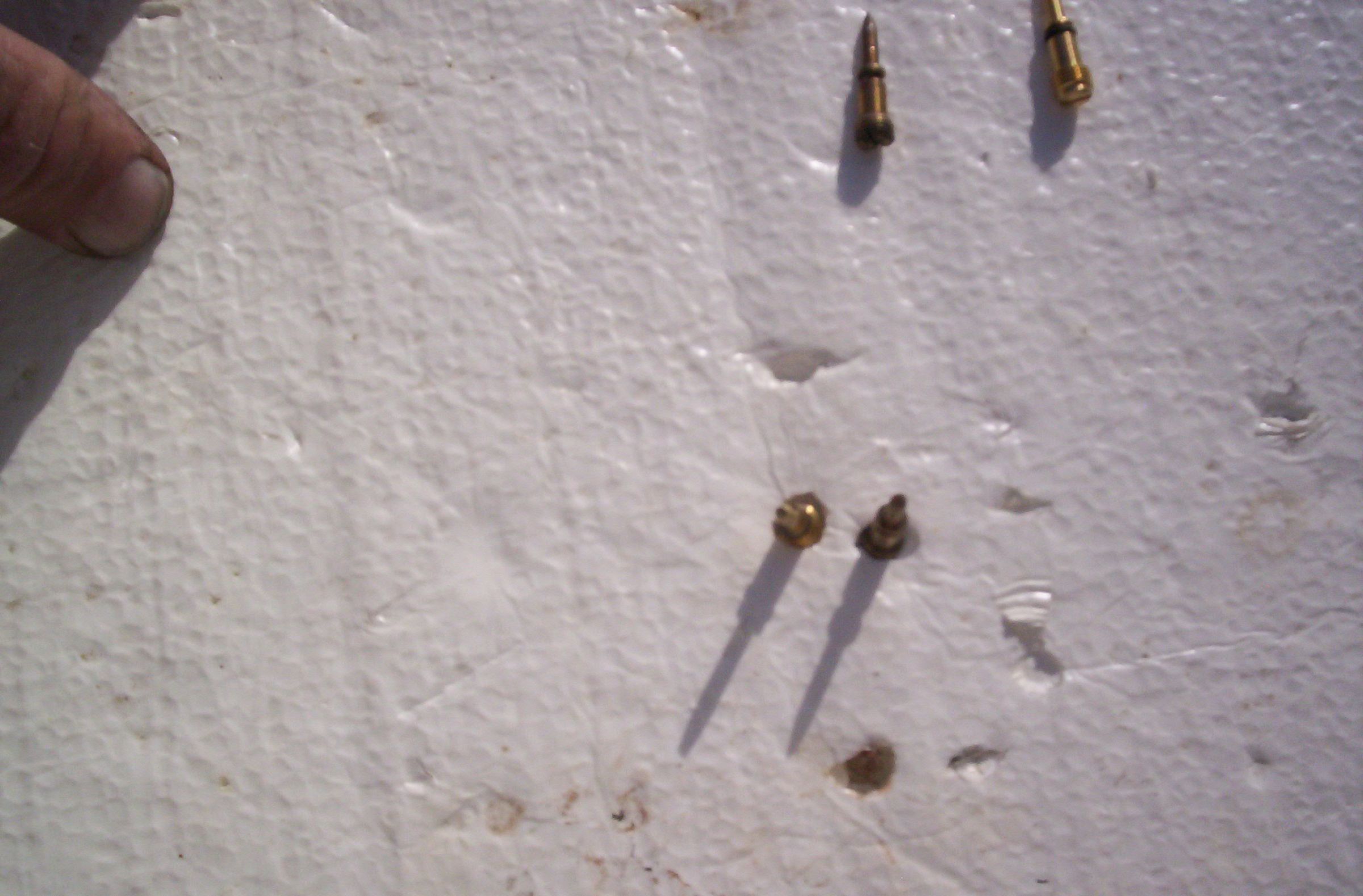

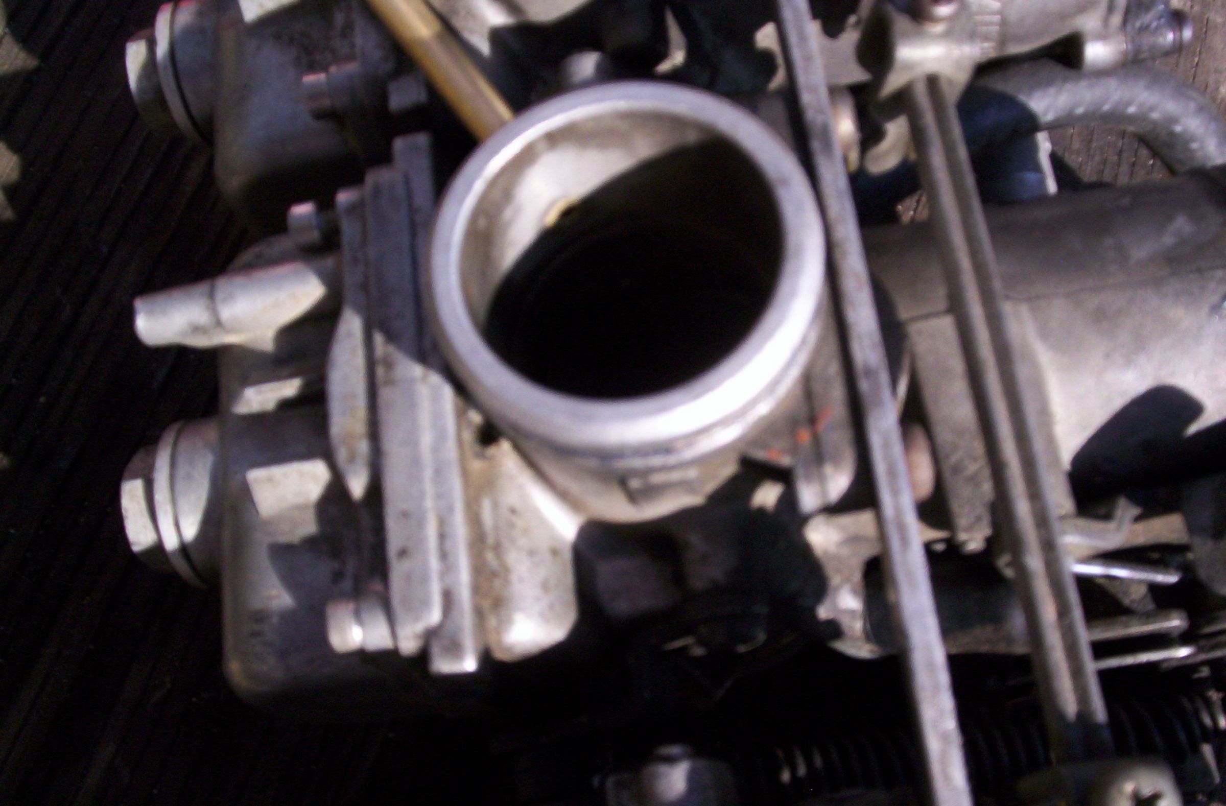

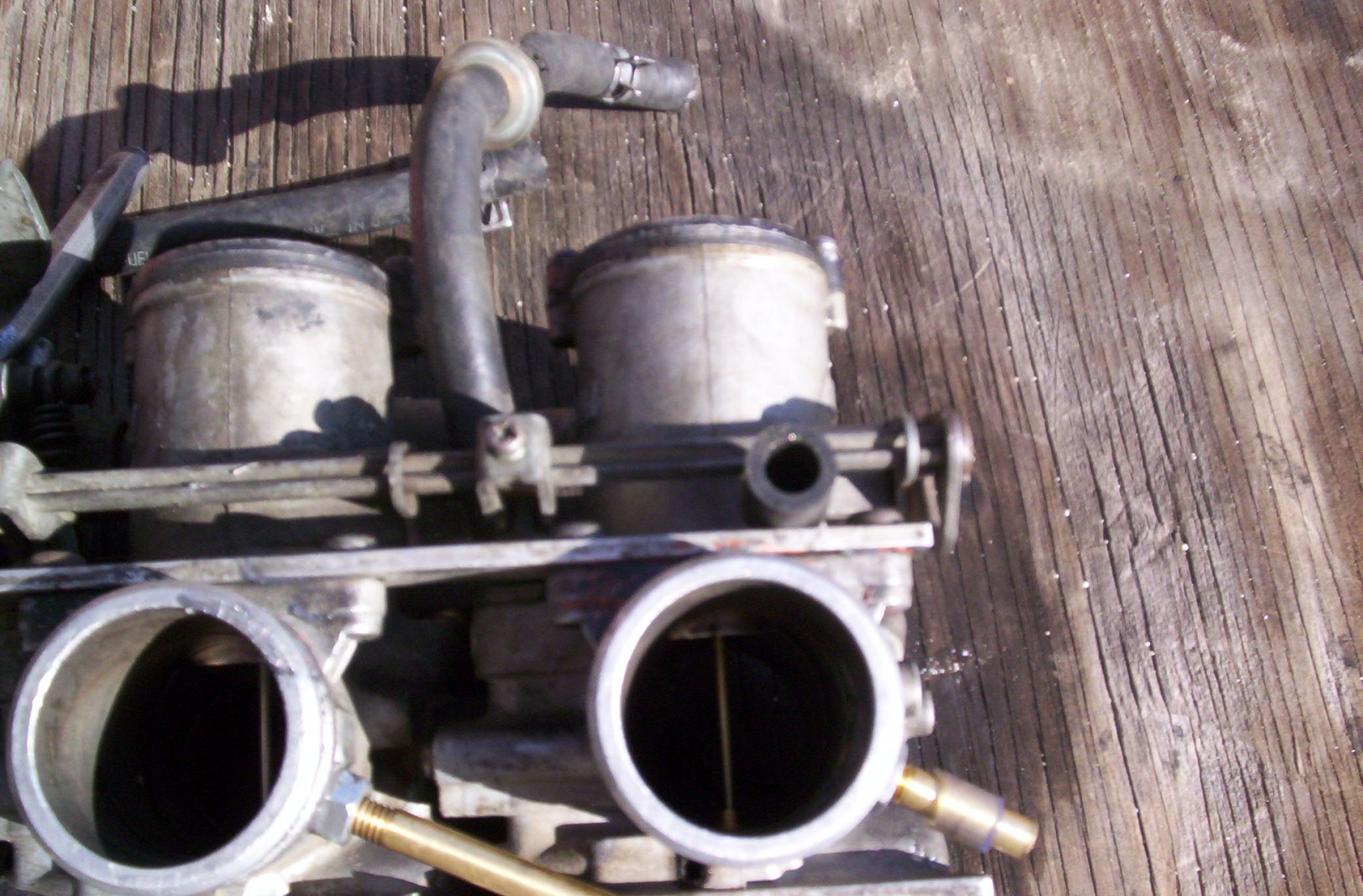

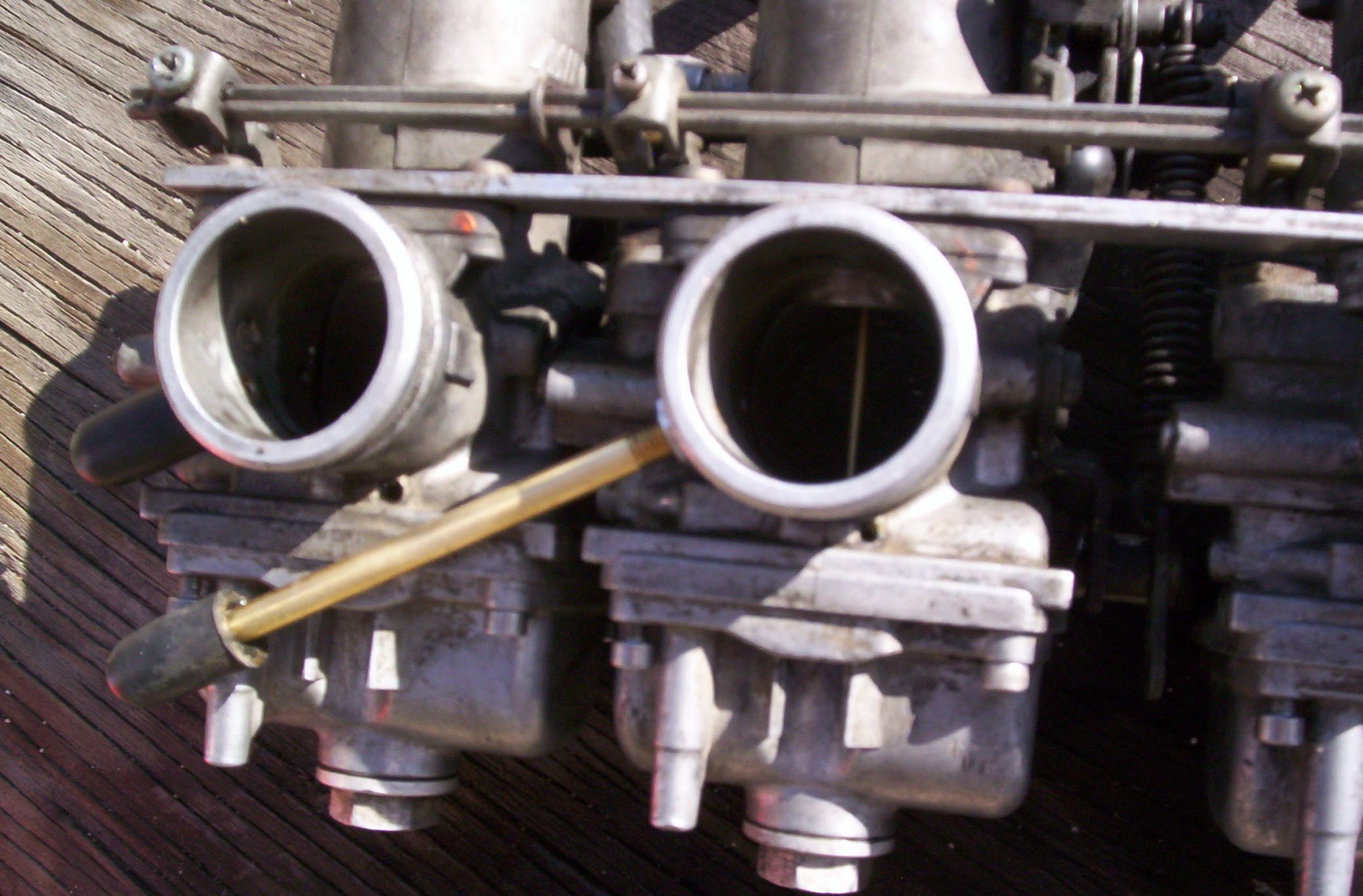

Installed the vacuum "nipples", removed the old funky ones that weren't even drilled the same.
Pics tomorrow. Repositioned the 1/4 and put a set screw in the old holes with JB Weld. I took a punch and crushed the last two threads so they can't work their way in.
Whenever I used the "choke". I'd get some coughing out of the carbs (lean) so I used my jet drills to open them a little. Better now. Raised the float levels a tad too using the clear tube. By the time I had the carbs back on it was getting dark. I'll sync them in the morning.
