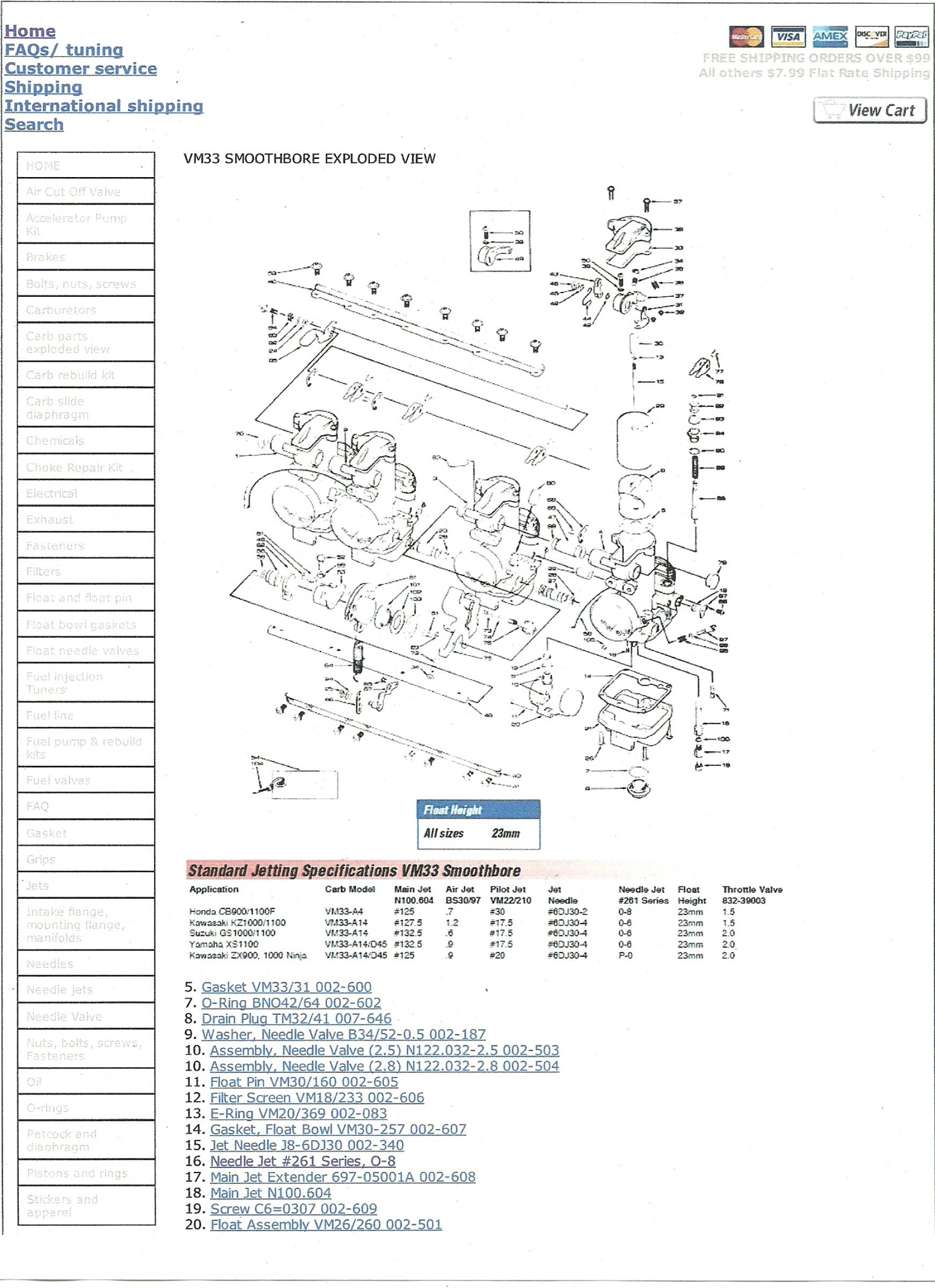

I've been asked about the VM 33's by a member and one last year. First off I wouldn't pay more than $300 in good condition. They're obsolete. I'm including the data on them as I go. These carbs have been a PITA not because they won't work, it's because the PO was a moron. More on that later. Once I got most of the mistakes corrected they have been great carbs. When I was getting Bossie ready for the road I talked to Mike at Z1E. He told me they were good carbs in the day but they had problems dialing them in. Too rich or too lean. Kinda like the VM 29's of the time. Both are smooth bores. Most parts are still available for them being they fit other types. The cost of new parts vs a modern carb set should be factored in as well.
Last year a member asked how much I would charge to set up his 33's. He was having leakage issues and running problems. I told him I would go through the carbs and give him my opinion before spending any money. I didn't hear from him for a few months then he asked again. I offered to set them, put them on my bike, dial them in but he would have to re-sync them and possibly rejet them for his engine. He told me he spent a lot of money buying them on eBay and didn't want to spend much more. I understand that, I'm there too. I need two slides but to set them up like the factory I'll need four and start all over. They're running good now and rather than spend another $2-300 on them, I might just buy some other ones.
I'm hoping others with experience will add to this thread. Here's some specs and data.
BTW I'm at 2.0 TV, Needle set at #2, #70 pilots and 130 mains. Plugs still look lean.

Yes, I have later style holders. No taps. Idle is good albeit my jetting is different than what's called for by the graph from jetsRus.
2.0 slides not 1.5. Turns out 1.5 is richer than 2.0. I had it bass akwards. :blush:
