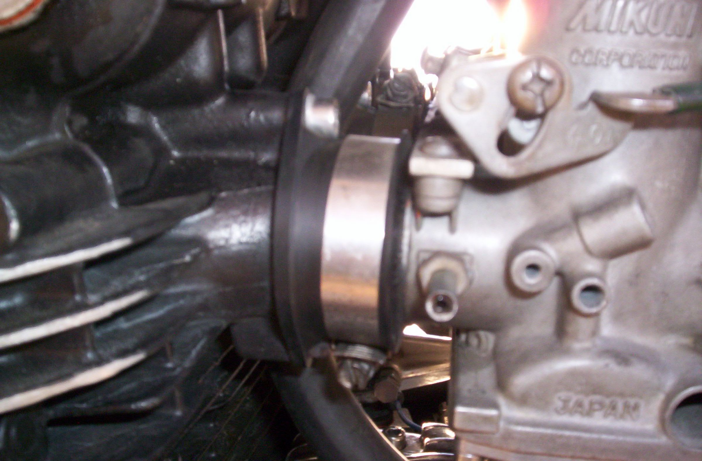

Here's the vac taps on the outside carbs. The inside are smaller holes and drilled off center. :sick: Poorly placed too. I plan on redoing them but I don't have a die that small. Some day.

Are the vacuum nipples easy to access on the inner carbs?

The air box is always preferable for all weather riding. With my 28's I could tell I was running out of gas at high speeds under load in 5th on the grade going into town. I changed the float valves from 2.0 to 2.5 and that helped. Once I got the 33's working properly kinda, that wasn't an issue. At first the way they were set up it was all on or all off. Now I can cruse through the parking lot or slow streets and when I want to get on it, it's all there. :woohoo:
The two inner ports are hard to get to so I made extensions with short tubing with nipples on the ends. As suggested here I will use solid brake line for my fittings. I can experiment with my old holders to see if I can install ports in them. If so I can have Jeff fill the holes and sync them that way. We'll see. :whistle:

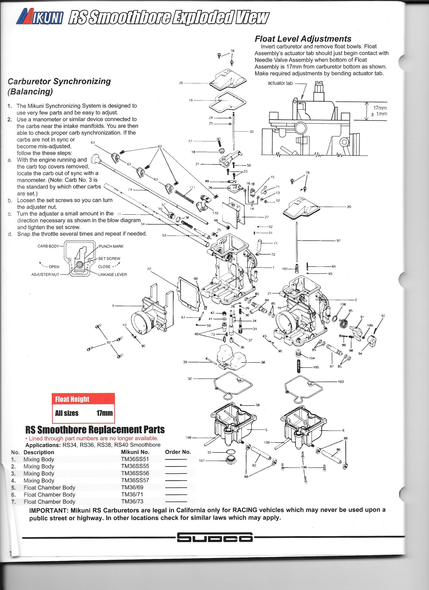

This is going to contradict what Patton says. This is a page out of the Sudco 5th edition tuning manual

28 Feb 2016 12:11Those are the newer RS design though and not the VM series.......
