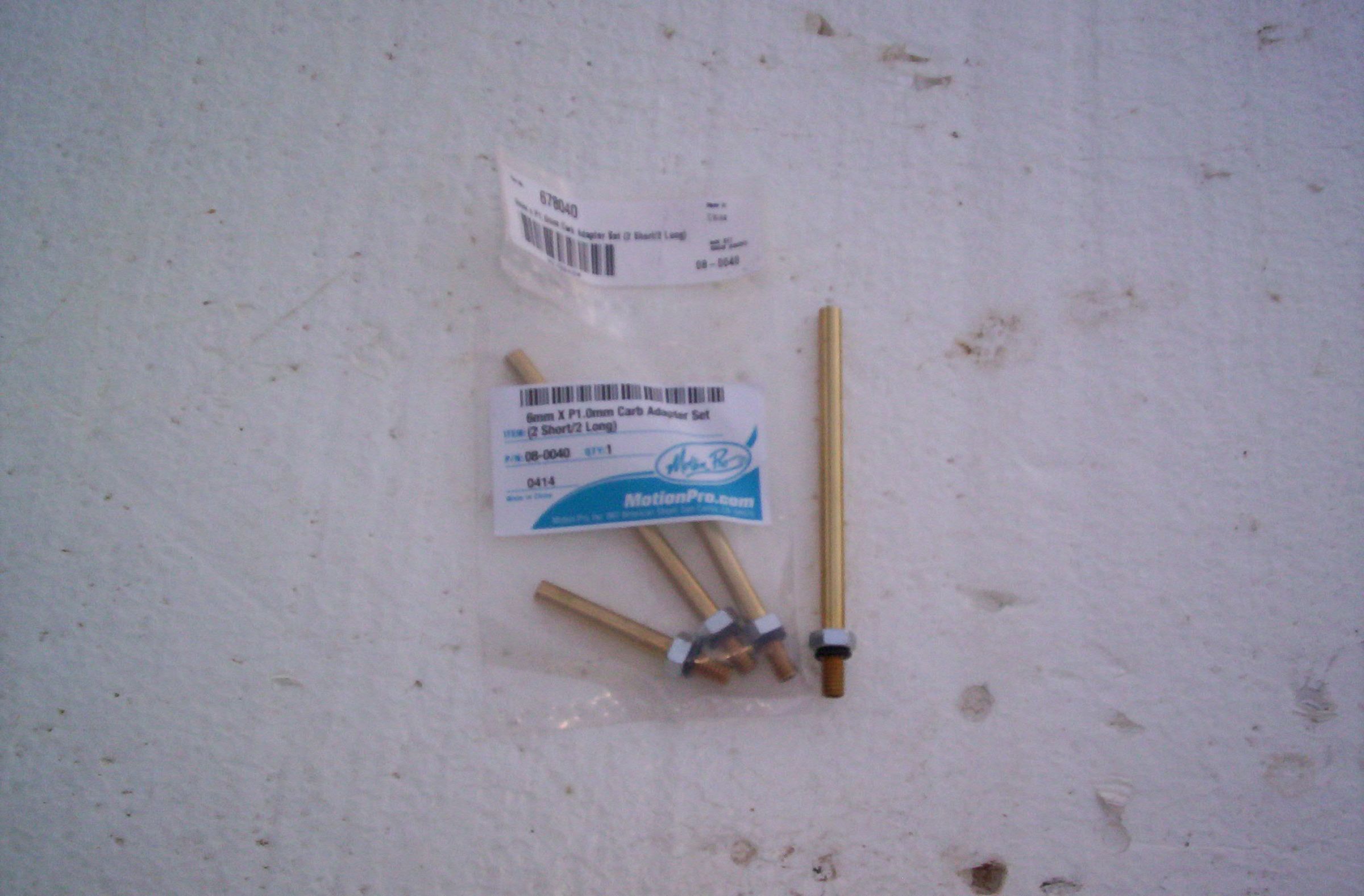

Got my new vacume port adapters (AKA nipples) yesterday. They're for Yamaha fours. Two long and two short. They will work for the two inside being they are long enough to get to easily. I need to get two set screws to plug the holes the PO munged in, drill and tap new ones at the 5:00 and 7:00 position respectively. Carbs will have to come off again and will JB weld them in When I'm ready, could have made my own but $10 delivered I can do other things like my new cush drive rubbers I just got. That will be done today. I've been wanting these things for years. One thing at a time. :whistle:

Will you install them to be accessible by reaching underneath the carbs? I was thinking about that, where the best location would be, and also that you could tap the holes and thread them in with a coat of sealant on the threads, skipping the nuts and o-rings.
If you didn't have a provision to vacuum synch the VM33's, how would you be able to get them adjusted properly?

The holes are already drilled and tapped. at 5:00 and 7:00 on the inside two. I'll unscrew them and JB Weld the new "nipples" in their places. The nut will act as a stop so I don't go in too far. The outside ones I will have to drill and tap myself at the same positions. I'll glue set screws into the old holes. They say setting them on the bench is good enough. HORSE PUCKEY. I put them on my carb styx and stumbling goes away at low idle. Raised my needles one notch so I have to do it again if I'm satisfied in how it runs.
