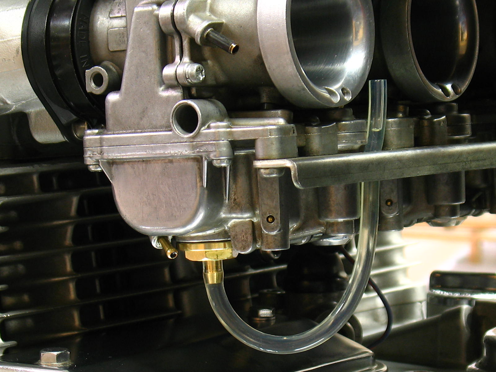

I set the floats at 17 mm +/- 1 mm per Mikuni Flatslide instructions, as I imagine most folks do. :whistle:
Would think there would be clear-tube method instructions somewhere for these carbs, but I have not been able to find any. :evil:
Any leads?
Any leads?

I would check them all with the clear tube to see if they are all the same.

Thanks Steve, I'll check that...the last time was a few months ago.

I went the RS36, though other members suggested the RS34 would be the better size for my engine. Thought about getting a used set to test, then keep whichever set works better.
The fuel levels were very-close across the set.
