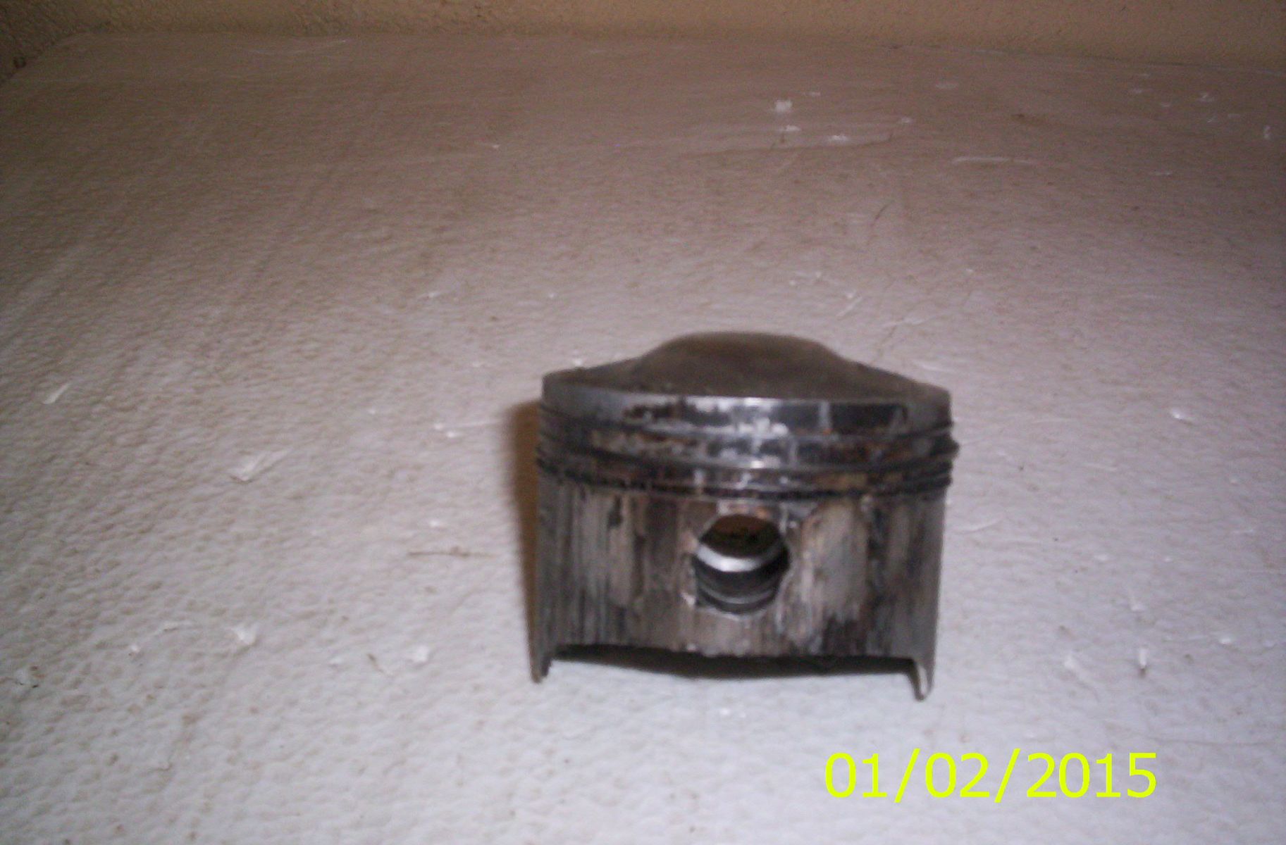

10 Jan 2015 20:47swest wrote: Yes but if you can do. That exhaust valve looks like it has a ridge on it.
That's what happens when you lap aggressively. Lapping should only be used for minor clean up. Not for heavy cleaning or resurfacing the parts.

The ridge is at the bottom. Looks like it's starting to form. A better pic would help. You can reuse it if the seating area is even. I could have reused mine but I found a deal on some Doremi valves made in Japan for $130 shipped.
I was hoping to gain some adjusting room. I did on the intake but not on the exhaust, I lost some there due to the carbon build up they were seating on. The constant oil seepage kept them from burning. It only smoked at start up and cleared but the intake caused oil fouling. The KZ 1000 are slightly larger and the seller is number 35 at eBay. He's re listed more for mine, I bought the last set three months ago, you might ask if he has your kind if you decide to go new. The intake valves are a little lighter than stock, the exhaust appears the same. They and the springs, my compression is up, crisper throttle responce and better acceleration. What's most important to me, no oil fouling.
That piston is just a example of what happens when something goes wrong. It can be oil starvation, broken rings or lands, dislodged cir clip, or too many dry starts.
In my case being on a fixed income, I sometimes have to make do with what I have. That's what I meant by "if you can, do".
Ness has good examples of worn valves. Yours don't to appear to be that bad. Your configuration allows you to freshen up the top end at will. I'd put it together and run it for another 15,000 miles.
This time I not only did the top end but also went through the oil pump, got a low mileage transmission, back cut it myself and replaced old parts before they failed. The crank was checked and welded years ago. That cost $200 and I had it done while I was in there.
New rings/new valves, your choice.
