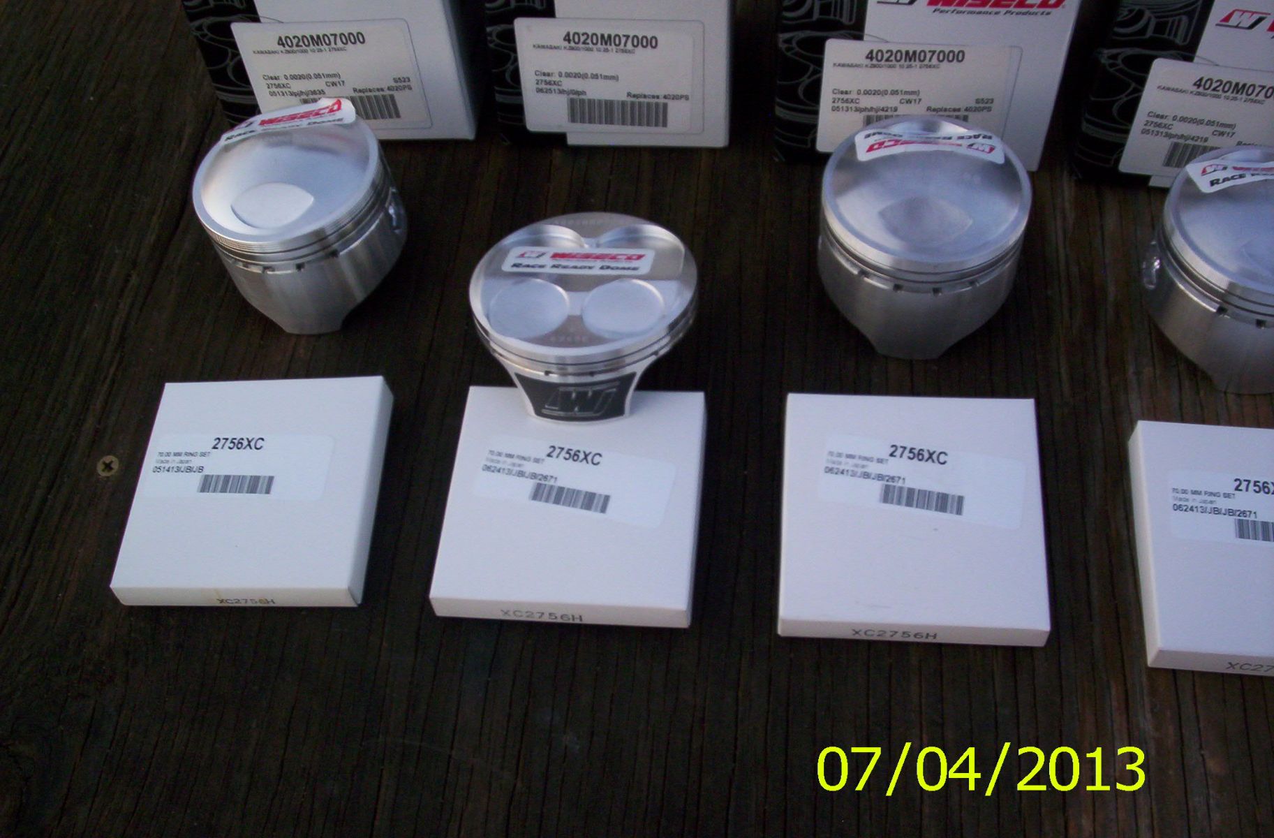

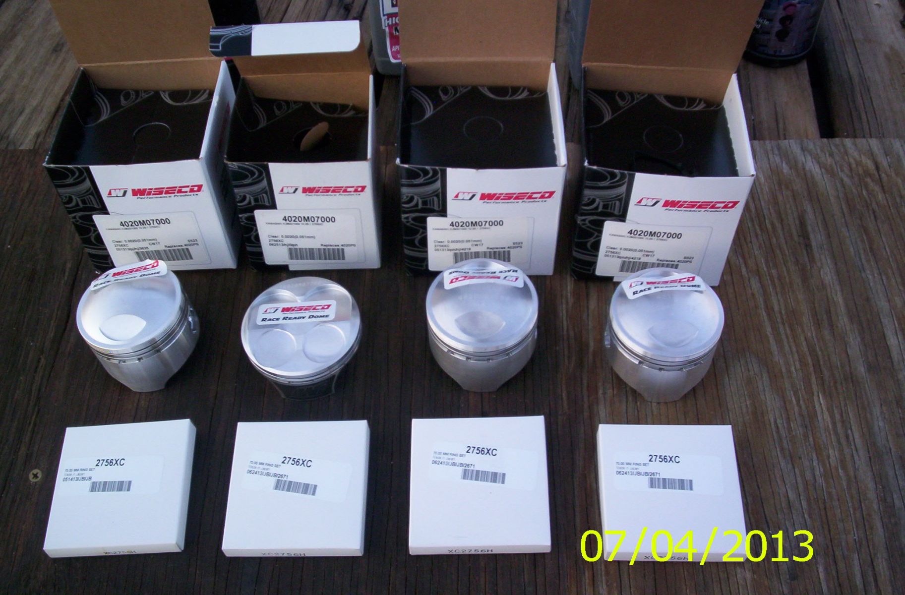

That figures, have you ordered the rings yet? The clips come with the pistons. If they're not damaged and the wrist pin and slot are good, I'd re use them. You might call Z1 to see if they can get them if you don't have your rings yet. I've found some love to delay a project so they can sell more or just for fun. I had my piston order delayed because of one wrong piston. Three were correct but one was in the right box, the rings were right but the piston was all wrong. While talking to CS, I was asked over and over if there was something else. I said no and found another supplier. That's called marketing. Sometimes you have to vote with your feet.
