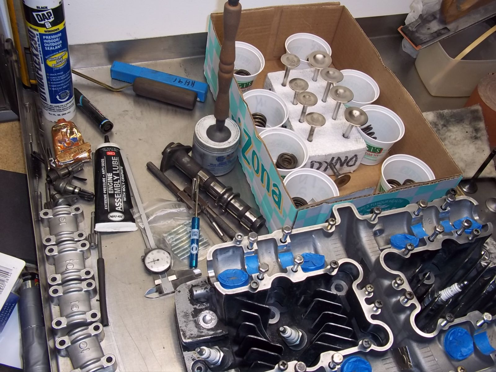

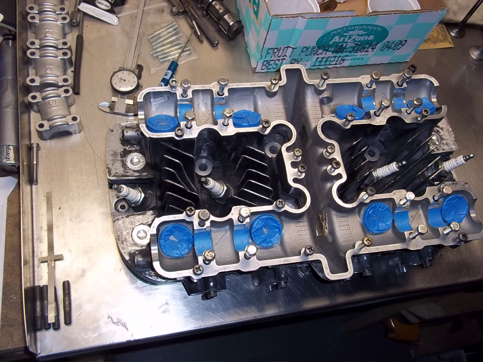

This is a virgin, late 73 Z1 head with the casting for the early vacum nipples. 1st time ever taken apart. lots of meat on the valve face. exhaust guides are shot.
This is what it looks like before I media blast it. which is after a solvent bath to get all the oil out. And then an oven dry it out. Glad I only do this for a hobby and not a paycheck.

Whats with the half cam shaft?

17 Jan 2015 09:13Thats for checking cam bearings, 1 cap at a time, no lobes either. Can't screw nothin up :lol:swest wrote: Whats with the half cam shaft?
