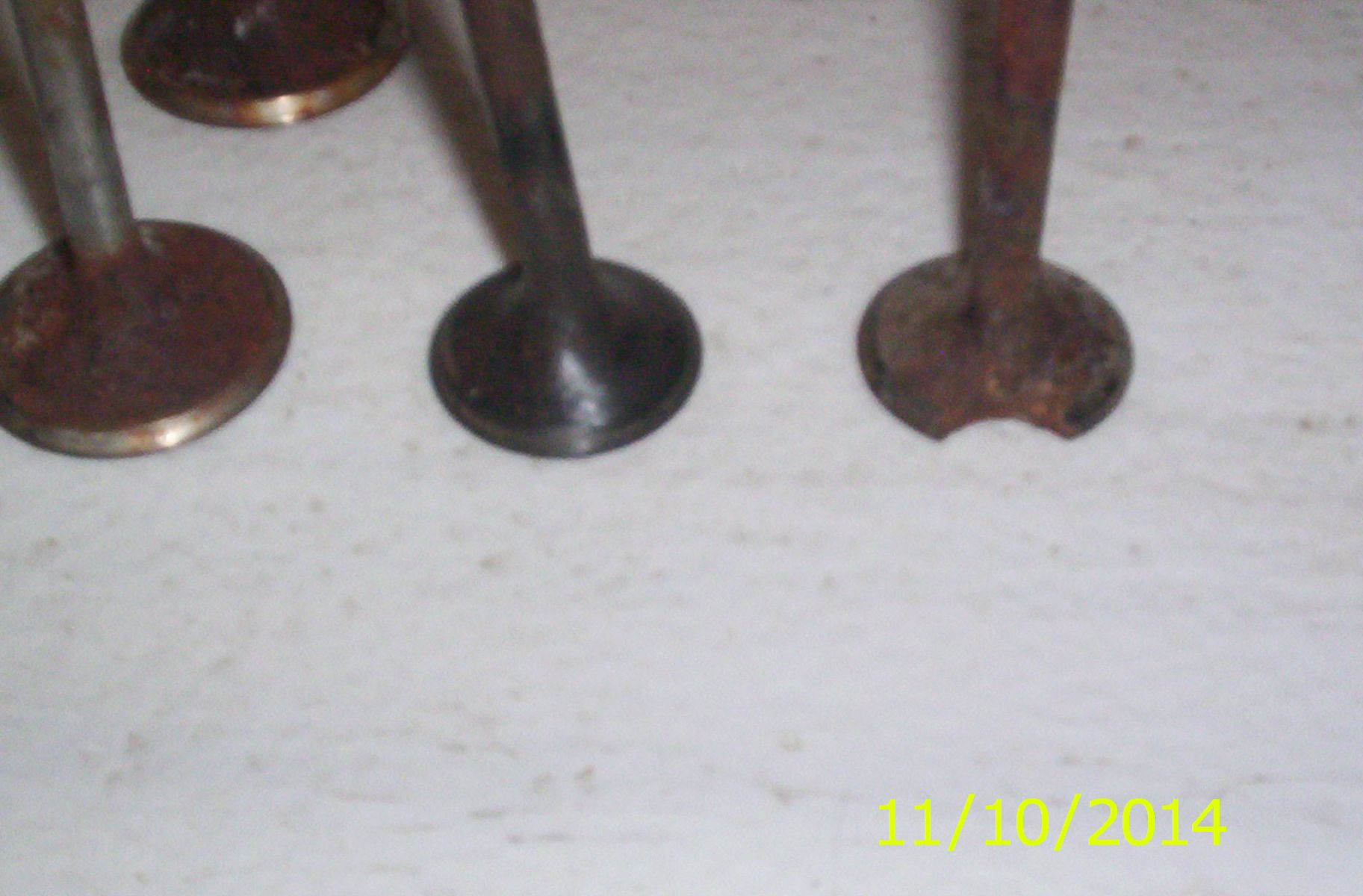

Here's my take on that head and valve's based on 35+ year's repairing and racing
both car's and bike's have the head bead blasted and clean the valve's with a
wire wheel then lap the valve's and then you will be able to really see what you have to work with.
And as far as those valve's are burnt bullshit they just have carbon build up on them.
A "burnt" valve will look like you cut it with a torch.
I've had race motor's lean out and burn a valve and half the valve head was gone.

Humm, some questionable advice here. You forgot the part about plugging all the oil passages before bead blasting a cylinder head. If you don't the glass grit will get down inside the blind oil passages where it's extremely difficult to clean out.
It's going to take an aggressive cut on a valve facing machine before those valves are clean again. The carbon build up is a result of the valves not closing fully. I characterize those as burned valves. It may be possible to save them, but not through lapping as being suggested in this thread.

Couldn't have said it better myself. I was trying to be civil. Now here's a burnt valve. It's the one on the left.
Last edit: 07 Jan 2015 18:07 by SWest.
