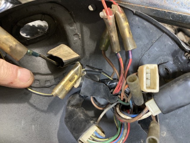

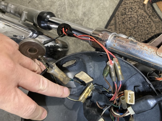

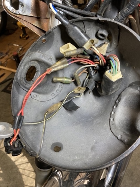

Ok, @F64 thank you for the help. let me know when to put those wires back together.
I am attaching photos below of the headlight bucket, it's a bit of spaghetti.
It looks like the main blk/yel wire coming into the bucket from the main loom goes to the headlight wiring and a turn signal ground.

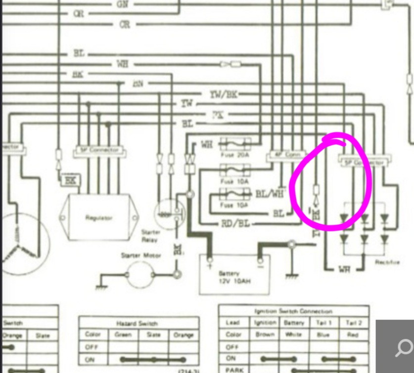

Check to make sure this yellow black wire connector near the battery is connected to the negative battery terminal.
Schematic courtesy of Mikaw

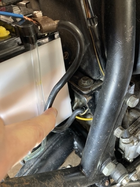

@Mikaw, @F64, attaching a photo
I didn't see this since I wasn't looking but the negative battery cable at the engine block does have a blk/yellow wire.(Maybe my Neg battery cable is flip/flopped) Appears to travel up the frame to the main loom.

Yeah, good old schematics.
Not sure about the colored version.
I got this schematic from the first page of your post. Mikaw posted 2 schematics.
Is that black and yellow wire attached to the engine block?

Re: new to me 1976 KZ 900, wires go where?
22 Dec 2021 11:03 - 22 Dec 2021 11:05
Hi @F64,
It appears it was flip flopped and yes it is attached to the engine block, I can flip it around to look correct. From the engine block The blk/yellow wire goes up the frame with brake light wires to another connector into the wire loom.
