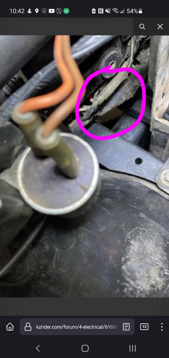

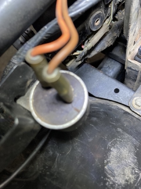

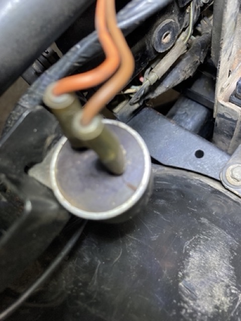

That black and yellow wire goes back behind the terminal panel and into a wire loom, you want me to follow that loom till the black/yellow wire exits and make sure it's to the frame ground?
photo attached of the back of the terminal panel

Disconnect that black and yellow wire connector and take another reading.
DC V
Key on
Ignition on
Black probe on ground
Red probe on the black/yellow at the relay
What is the voltage?
Press starter button
What is your voltage?
My guess is someone tied that black/yellow wire to positive instead of ground.

the terminal panel I unbolted to get to the blk/yel wire and disconnected at the bullet connector.
What is the voltage? jumps all over - Ghost v
What is your voltage? Same ghost v
No neutral light when I turn the key on.
I also checked the wires at the key and key 12.14v on all wires with key on.
