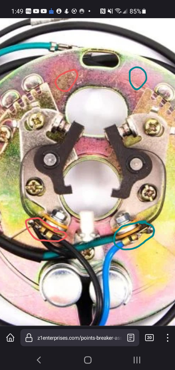

Key on/ignition on
Meter DC V
Points closed
One probe on red circle(put probe on the wire terminal)
Other probe on the other red circle part of the plate.
Note voltage
Open the points
Note voltage
Do the same for the other set of points with the green circles.
Points closed
Points open
Turn off ignition
Wait 5 min to let the coils cool off. Probably less time considering how cold it is there.
Turn ignition back on
Points closed
Put one probe on the wire terminal in the red circle.
Put the other probe on the negative coil terminal for that set of points. The wire color attached to those points should match the negative terminal coil wire. It's either green or black.
Note voltage
Do the same for the green circle wire terminal and the other coil negative terminal.
Note voltage.
Turn off bike
The first voltage drop test is checking the connection from the wire terminal through the points contacts. Closed, the reading should be very close to 0.0v
When you open the points you should see battery voltage-12v
The second test is testing the wire from the points to the coil.
Closed points, close to 0.0v
