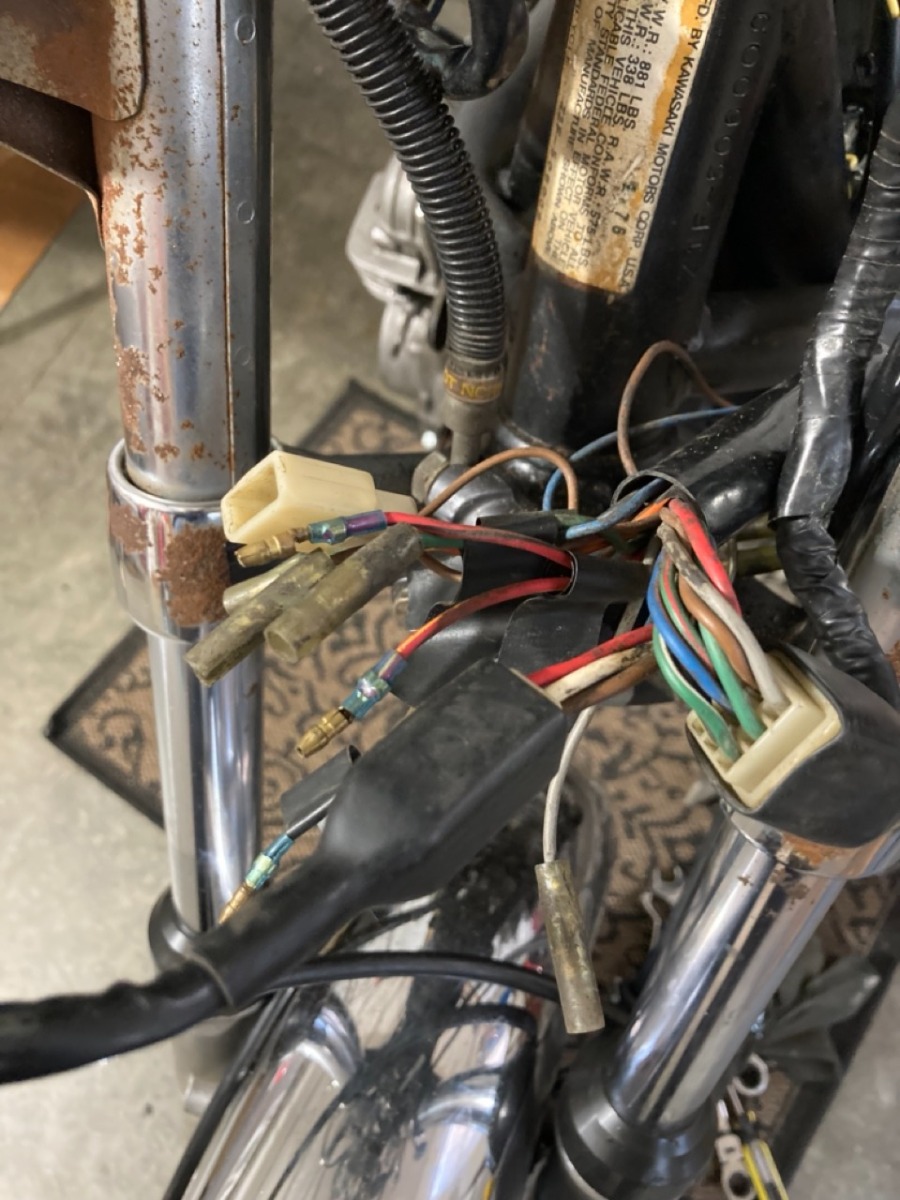

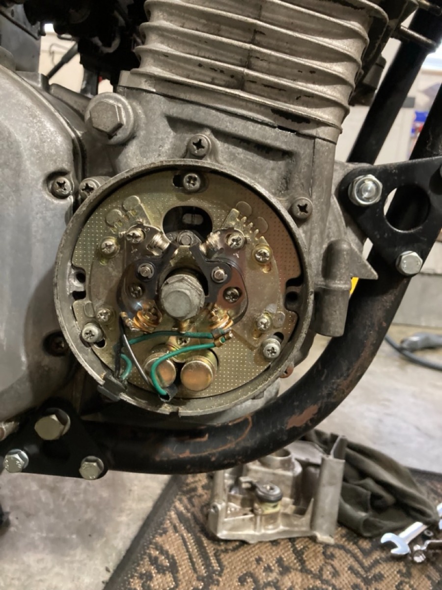

new readings below meter DCV, key on, ignition on, both new coils installed, pics below of points and headlight bucket, no exposed wires grounded that I can see.
red on battery +, black battery - = 11.94v
red probe on white wire at key switch
Left coil positive(red/yellow) reads .996v
right coil positive reads .991v
how do I get a reading on the white wire in the bucket? to get a reading at the kill switch pull apart the switch?

Not to step on the Calvary’s toes here but a word of caution. Make the time “on” for the run,stop,run short. You can burn out coils if they are in the power on state and not discharging (spark/fire).
You should be able to access the white through the connector from the right hand control. It will also be in the harness that comes out of the ignition switch. All those should terminate in the bucket if they are oem intact. Dealers choice if they have been altered.

I wasn't aware the coils could burn out like that. Thanks for the heads up. If the key switch is off and run is on is ok? I am going to get readings once I take apart the switch. Something I notice, the neutral light dims once I turn the kill switch to run from off.

You might want to check the voltage on the supply to the neutral light and see how much it changes when you switch the kill switch to run. It sounds like you may have a partial short in the ignition ( see fault finding guide in FAQ section) be lucky

Instead of the white wire. You can put one probe on the yellow/red at the kill switch.
Then the other probe on each coil's positive terminal.
Key on ignition on
Voltages should be as close to 0.0V
Limit is 0.5v. Anything higher will be an issue.
We're checking the yellow/red wire from the kill switch to the coils.
Your coils are getting power. They aren't getting full power though.
We'll check the points next. Making sure they are closing and opening completely. No arcing. And a good ground.
Key on ignition on
