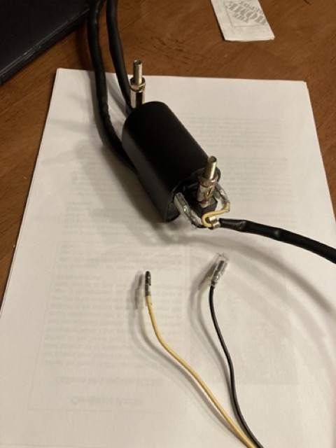

I am attaching a picture of the new coil. Thing is I don't see the + or - associated to either wire. those wires are pre-made with connectors already attached and can only attach to the existing wires one way. Thanks.

Ok yellow then will go to the yellow/red. Black to black for cylinder 1-4. Other coil yellow to yellow/red. Black to green for cylinder 2-3. What did you notice or do that dropped voltage from your 10.3 to 8.6
