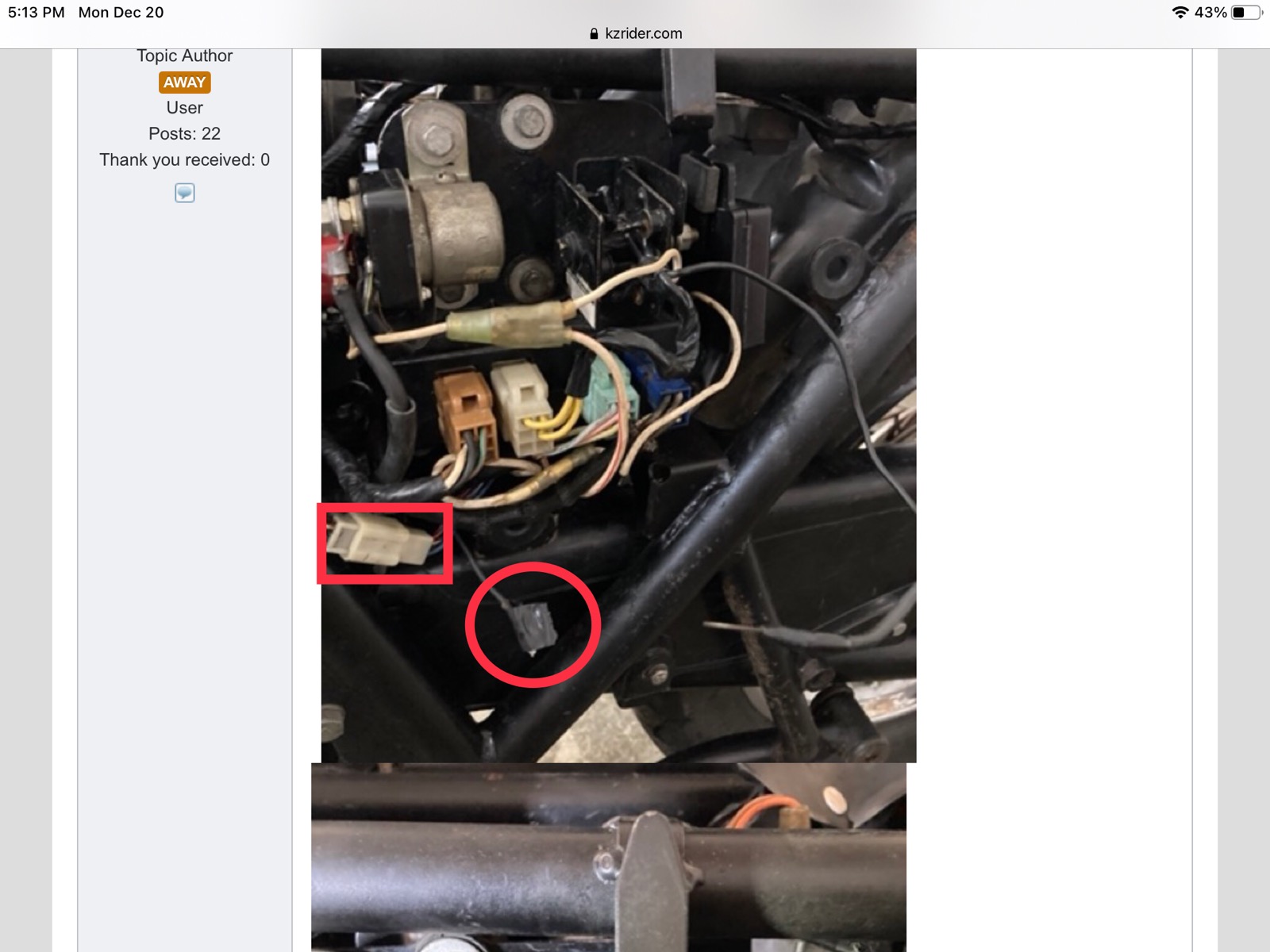

new to me 1976 KZ 900, wires go where?

Re: new to me 1976 KZ 900, wires go where?
20 Dec 2021 14:13
The black wire I detached goes into the harness that the middle plug inserts with all the yellow wires.
20 Dec 2021 14:17 - 20 Dec 2021 14:17
Last edit: 20 Dec 2021 14:17 by Mikaw.
- rscone11
- Posts: 114
- Thanks: 7
20 Dec 2021 14:22
@Mikaw, the taped black wire you just posted comes out of the harness that goes to the green square plug on the bank.

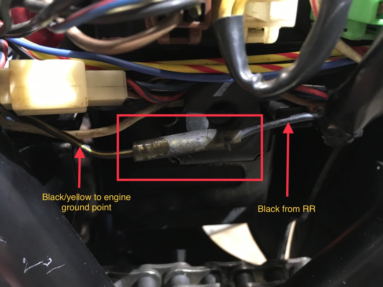

20 Dec 2021 14:40
The taped up one goes to a black with yellow. That black yellow goes to the right hand side engine ground.
20 Dec 2021 14:41
My apologies Mikaw,
I see what you are seeing.
Yeah, that thin black wire needs to be removed from the relay.
81-KZ440-D2.
LIC, NY
LIC, NY
20 Dec 2021 14:50Accepted. I know where the wires go. Your the one that knows how they work. Good team.My apologies Mikaw,
Should he ground those wires before you start the bike. I’m not sure what damage could be done to the regulator and the rectifier it they are not grounded?

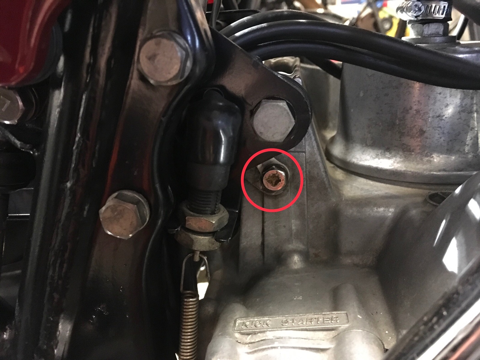

thanks guys, appreciate it. So I don't have a black/yellow lead going to the battery ground on the engine, I have some wire and plugs so I can fabricate one.
Once I ground that should I begin getting more voltage measures or try the starter button? @F64
20 Dec 2021 15:57
The battery should be grounded to the bolt on the Rh side also.
20 Dec 2021 16:04
yes I do see the battery lead is grounded to the engine. So I need to ground the taped wire there and the black wire I removed from the relay I should ground at the seat lock. Correct?
Then give the starter a whirl?
20 Dec 2021 16:34
Once you ground that thin black wire that was on the starter relay you can try to see it starts.
It may only run on 2 cylinders as that right side coil is not getting voltage.
