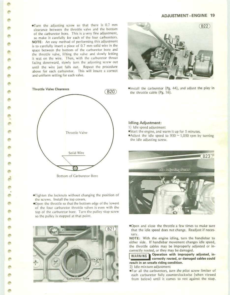

I put the wire between the bottom of the venturi and the notch in the slide. Some people use 22 gauge wire. I use 20 gauge.

So the wire will be on the engine side of the carb ? I was thinking it went on the side with the small notch on the slide.

The small notch on the intake side could be de-formed (out of shape) by the slider pressure if you use a steel wire!!!
This could cause some (high/rough) idle trouble on the pilot Jet jeting air/fuel Ratio.

Scirocco wrote: The small notch on the intake side could be de-formed (out of shape) by the slider pressure if you use a steel wire!!!
Ok so I’ll stay away from that side, I have some 20ga copper wire that I had left over from a underground dog fence, I think it will work and it’s softer than say electric fence wire.

I measure from the outlet side, but I don't think it really matters. Copper wire is softer than the slides so it doesn't mark them.

Copper wire is softer than aluminum and does´t mark them but steel wire does imprints on aluminum!!!!
Anyways later you have to do a vaccum sync after a valve clearence check to get a smoth idle running.
