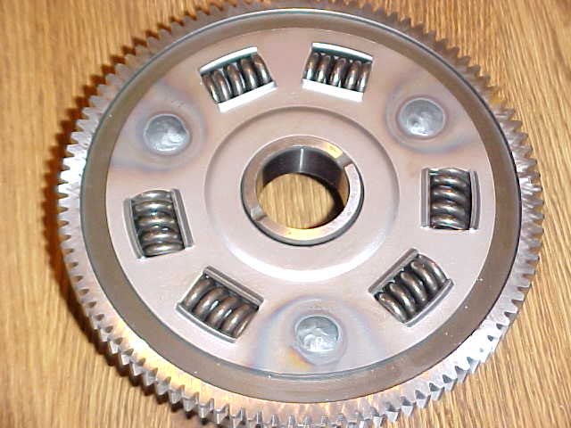

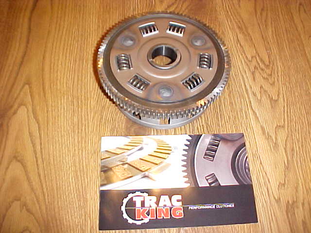

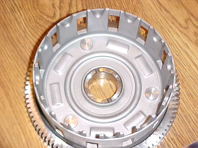

jumbulias wrote: Thanks for the info. I will check that out when i Split the cases again. I forgot to put the clutch housing in. Did you have ape racing rebuild and weld clutch housing on yours?
Stock clutch basket. Polished the aluminum basket fingers so clutch doesnt stick , bind or chatter
9 plate clutch Action 4 ( A Bill Hahn Company )
Pusher bearing from APE
Shift bushing APE
Centrifical Lockup clutch ( Karata Glide )
HD springs Action 4 * probably not needed

Got The Clutch basket back from Ape . Looks Great!! Back to work this Weekend

jumbulias wrote: Thank You!!!! Looks like I am back to the drawing board. Totally forgot about the clutch housing.. I thought about sending the clutch housing to Ape Racing to be be rebuilt with there heavy duty kit, looks like I will have time know. Thanks Again You saved me alot of time in the long run.
Been there, done that! cool build. following along.

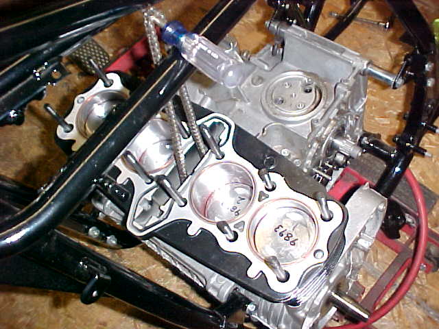

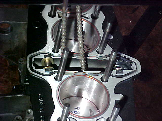

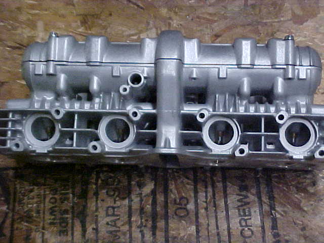

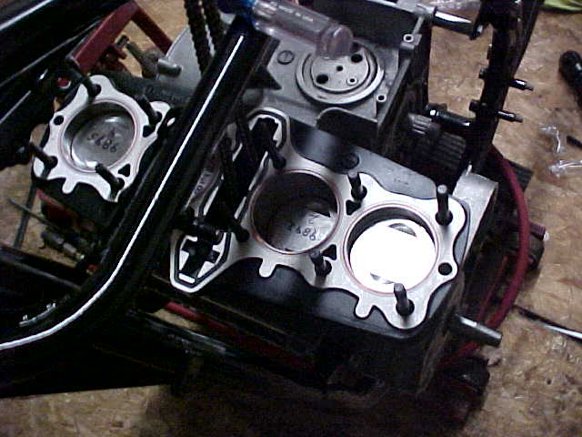

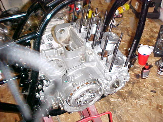

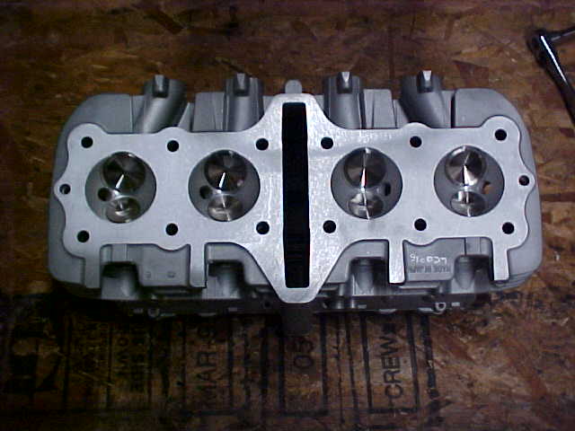

Got the clutch housing in. also got the pistons installed The cylinder head done by Larry C is next.

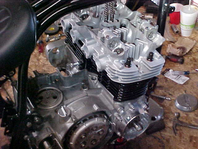

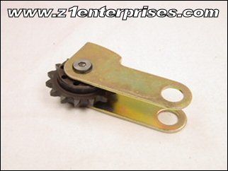

Got a Little Bit done today. Installed Liska Idlers and Cylinder Head . Hopefully I can work on it tomorrow
Last edit: 11 Feb 2017 13:34 by jumbulias.

Liska Idler and Tensioner

Missing one? :whistle:

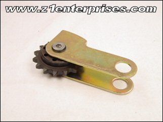

Hello Steve Is this what you thought was missing?

jumbulias wrote: Hello Steve Is this what you thought was missing?
The other idler that goes above that on it's pivot.

I have the same setup. I guess you left it off for the pics. There are two of them. That block is purdy.

Thank You for the info. I appreciate it
