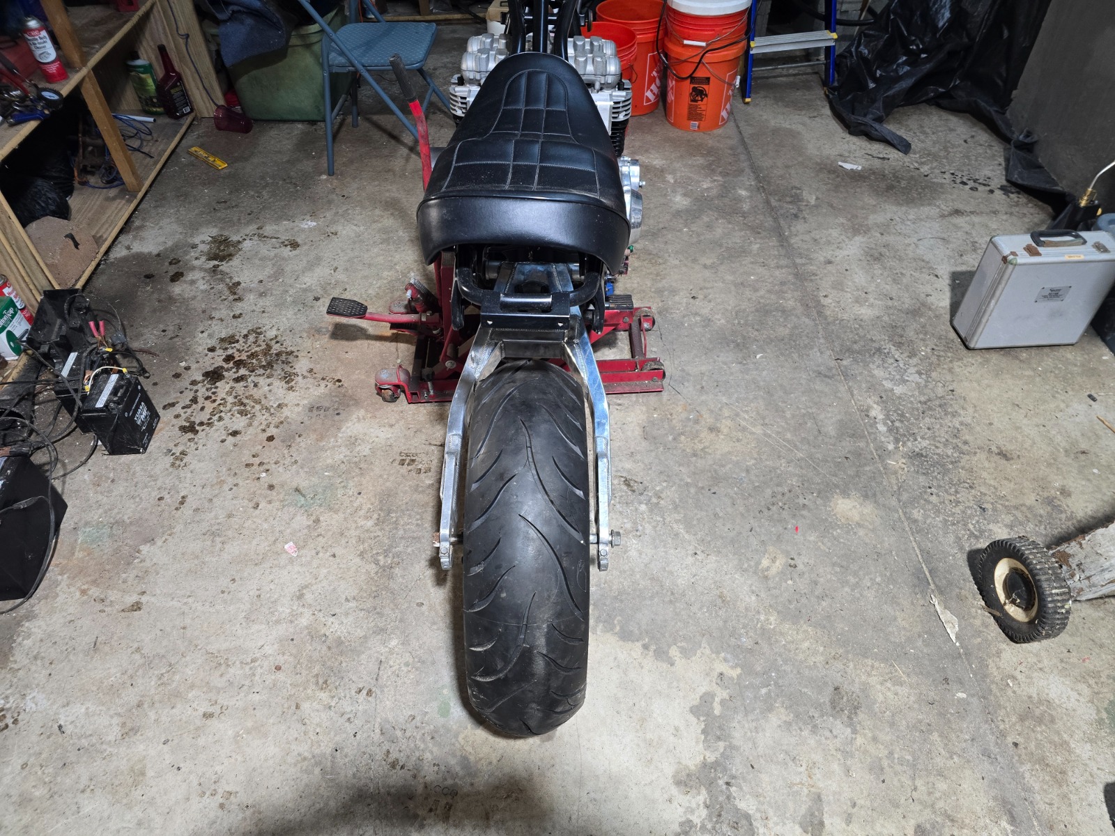

Hello  The bike is next on the list. I have been cleaning out the barn. Getting all the parts together  for the build. Bike is  all apart at the moment.  I will be posting  pics as I progress. I know this is longest build in kzrider history.  Had a few setbacks with my health. But I'm  back!!

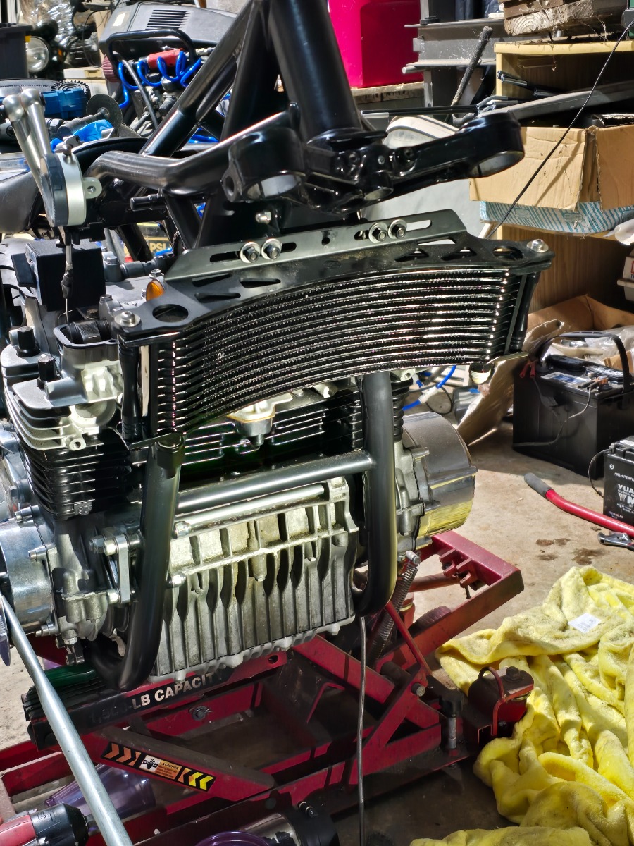

#923921

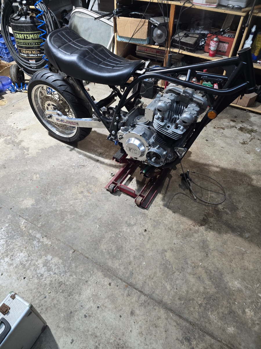

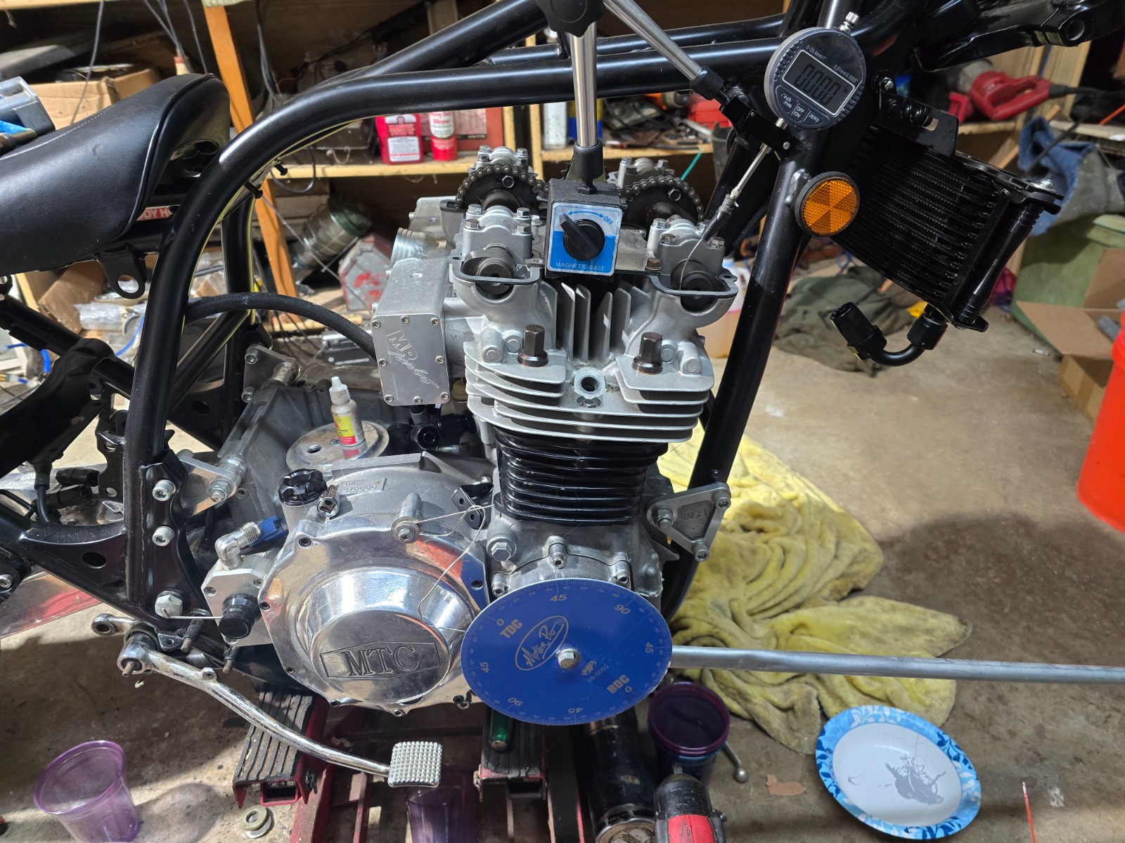

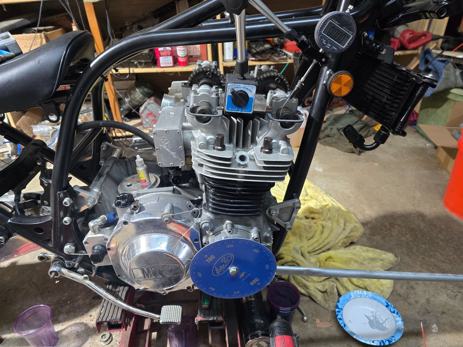

Got a little done today. Oil cooler and fittings installed. Went ahead and degree cams per Dale Walker cam degree dvd. I spread them at 108/112 . Found old email from Larry Cavanaugh. That's what he told me to set it at.

14 May 2026 13:32
#923922

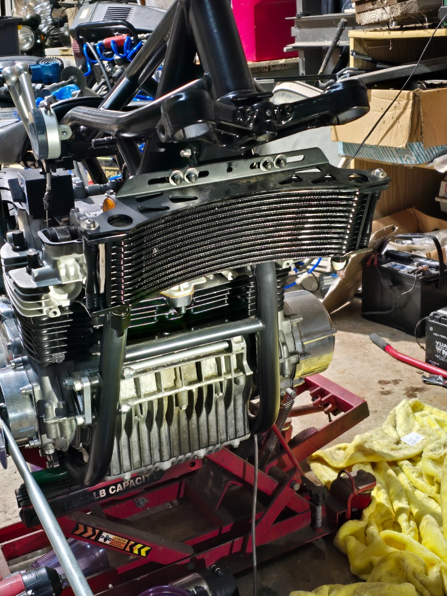

Oil cooler

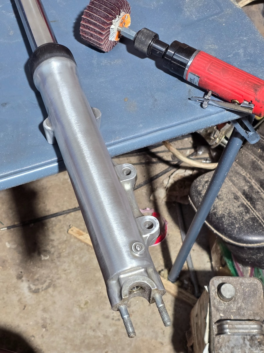

#923964
Been refinishing  front shocks today. Using a walter 2 in 1 flap disk. Going to spray with satin clear coat. And put new dust boots on. Should look pretty  good when done.

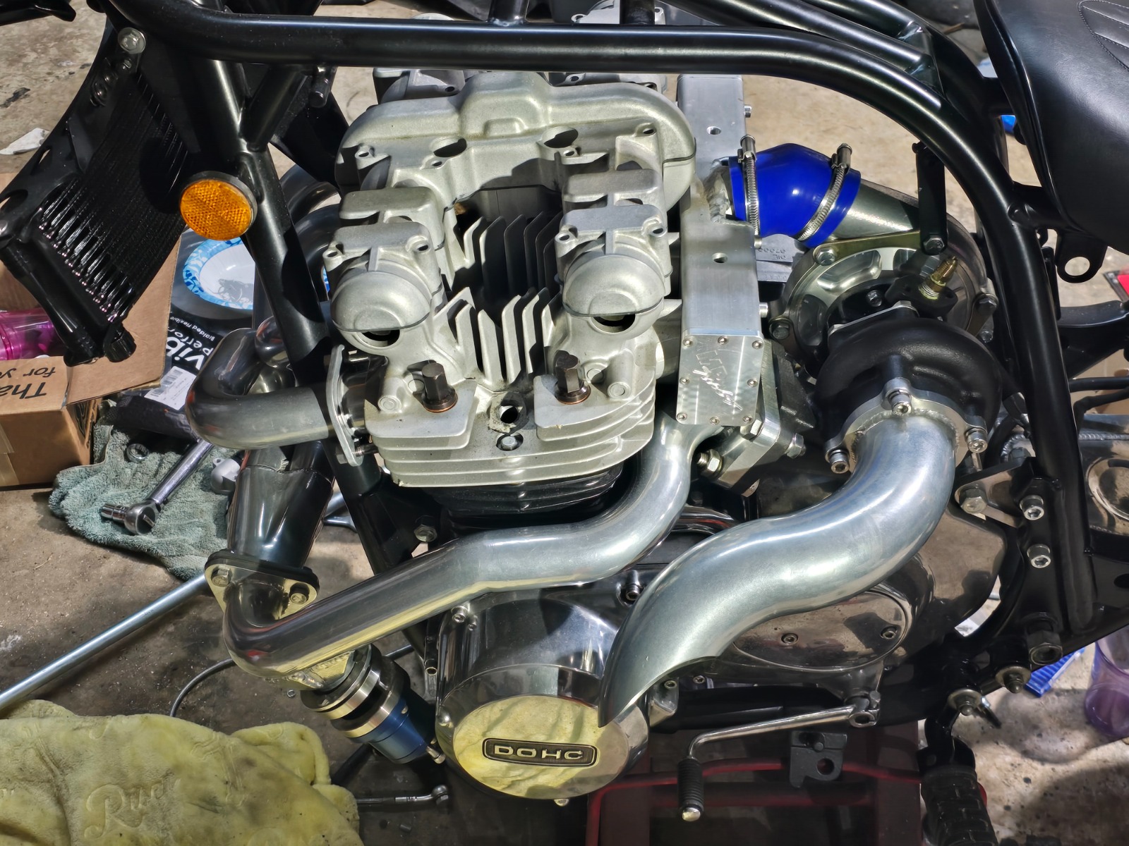

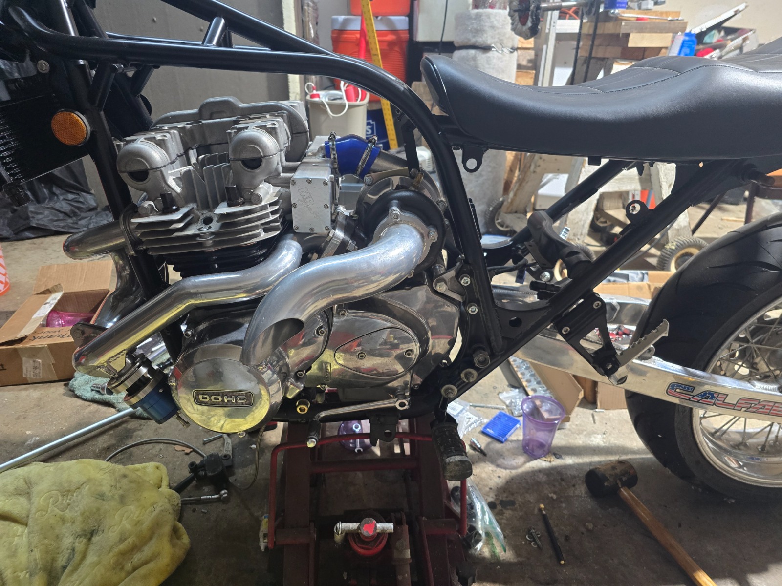

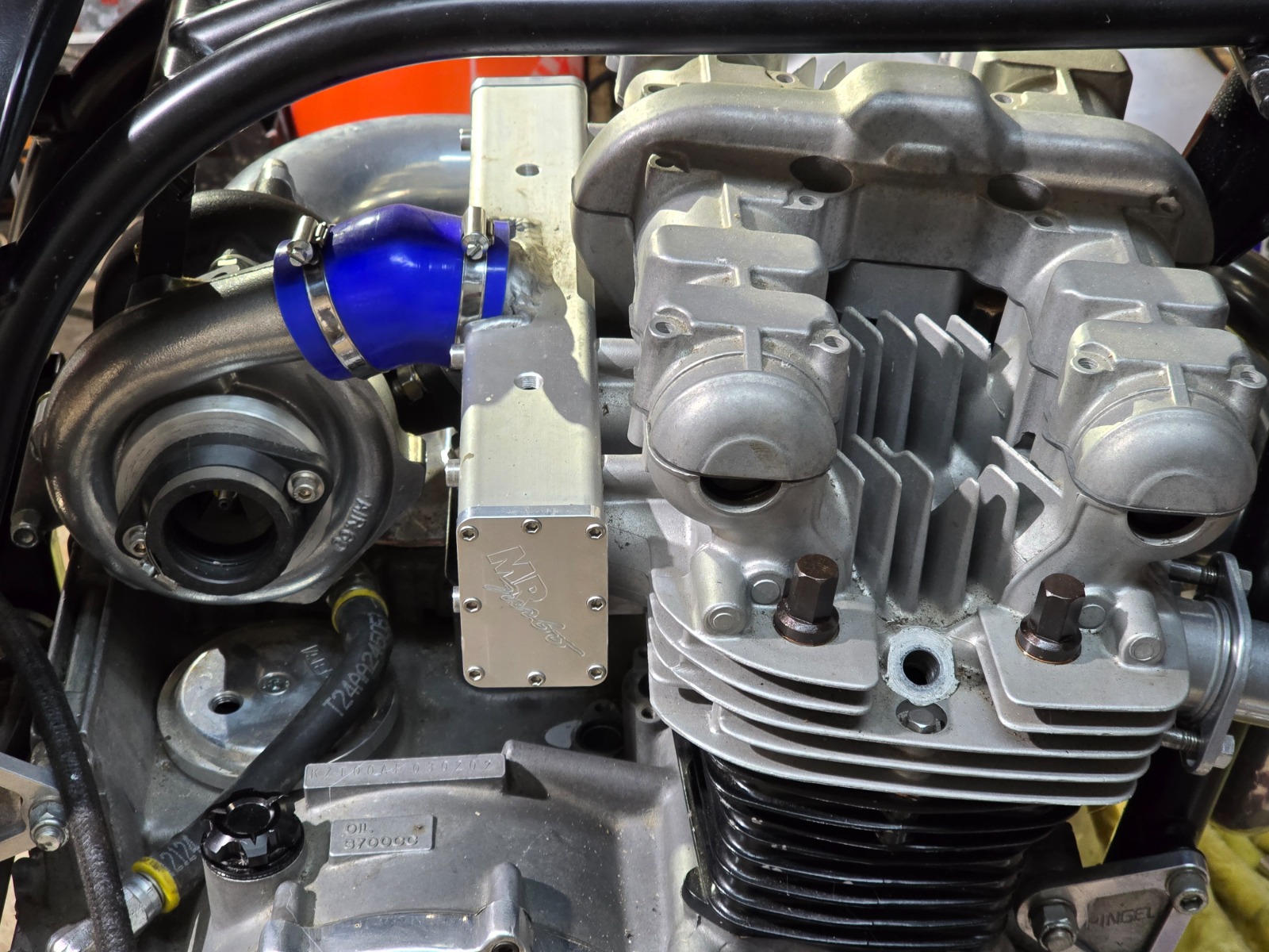

#924041

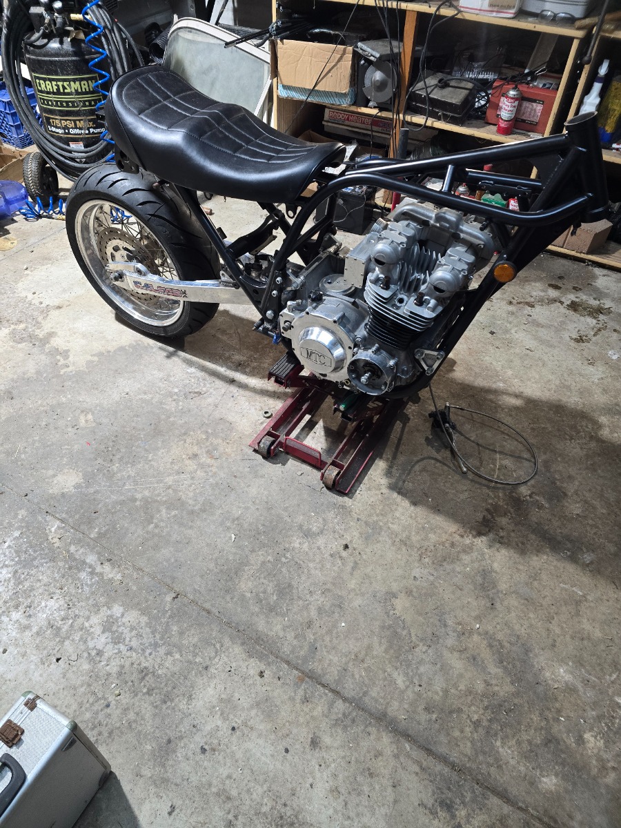

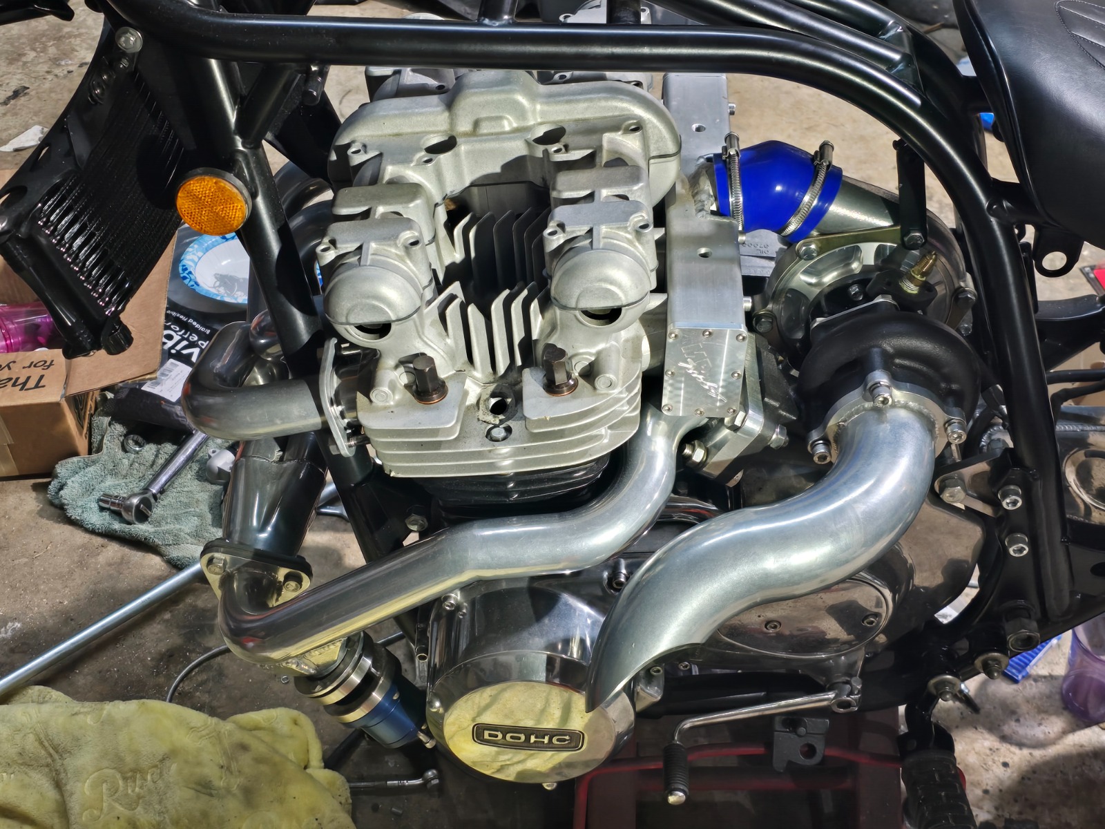

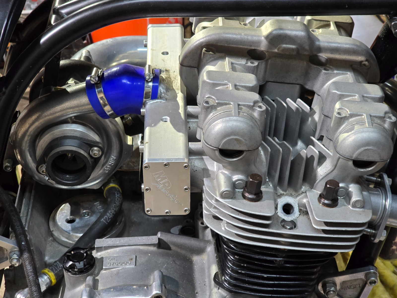

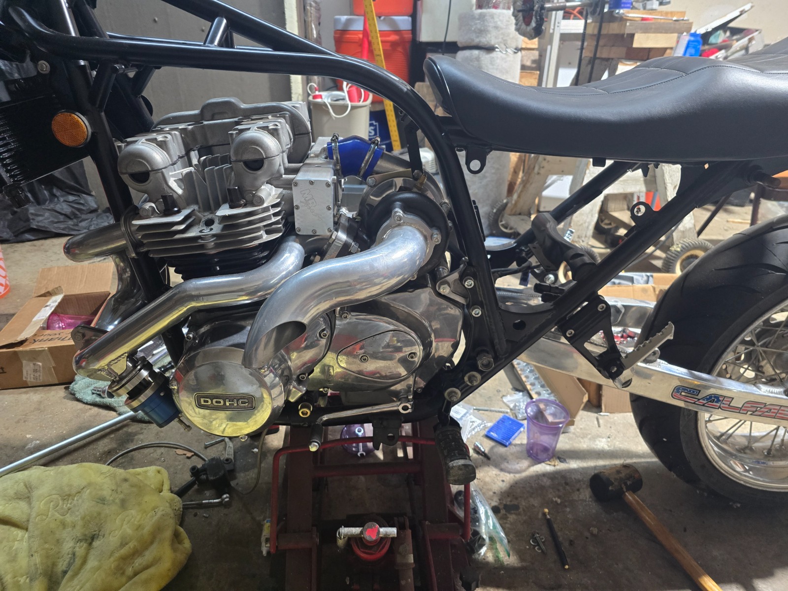

Started installing the Mr Turbo kit. It's Turbo Time!!!
The following user(s) said Thank You: StreetfighterKz, MFP-Joe, Street Fighter LTD, Wookie58

Re: What size Piston kit to run with Mr Turbo kit
20 May 2026 08:25
#924093
Nice !!!!!!!!!!
The exhaust pipe looks wicked  and the redesigned intake is also awesome
Get er done

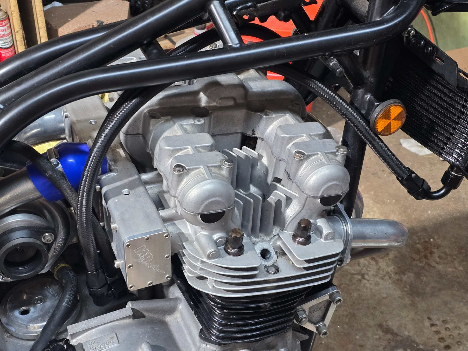

#924097

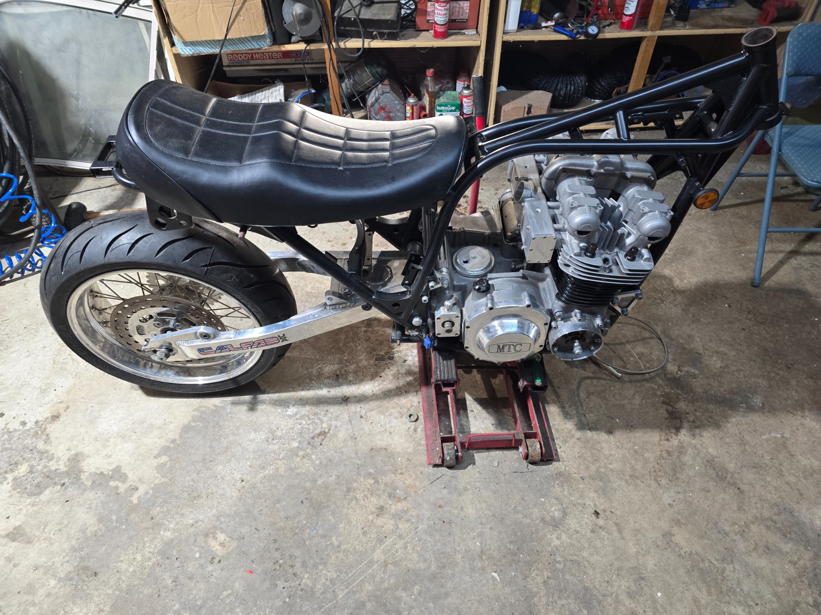

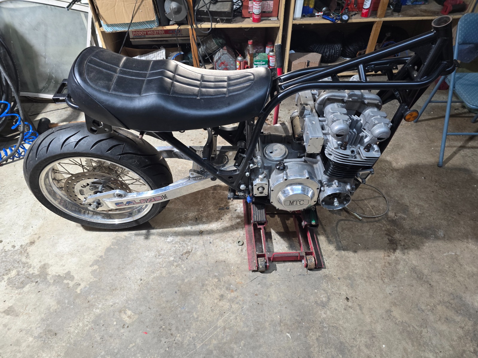

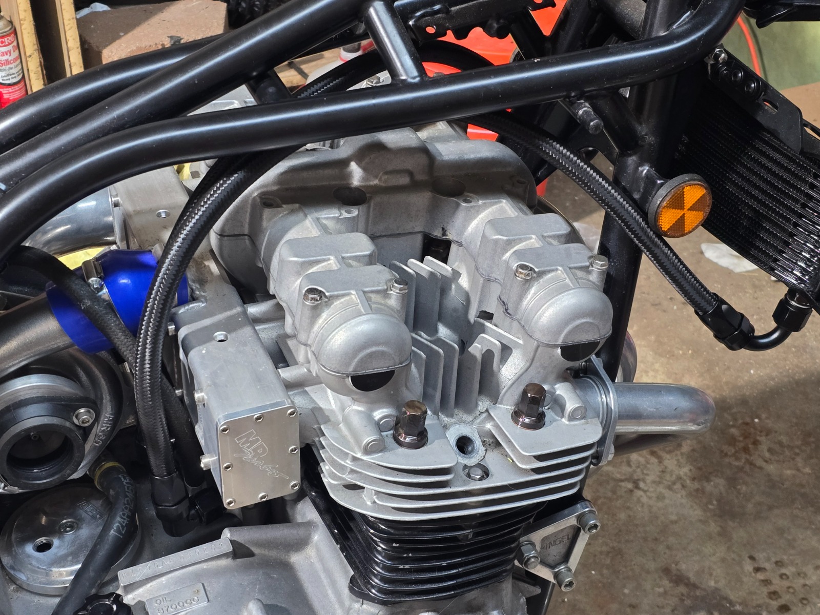

Got the oil cooler lines built,and installed today
20 May 2026 11:45
#924098
Looking great :) could you mount the cooler with the hoses at the top do it doesn't "drain back" when not running ?

20 May 2026 12:22
#924099
The hoses are higher than the oil cooler, hopefully it will not drain back to engine when not running
